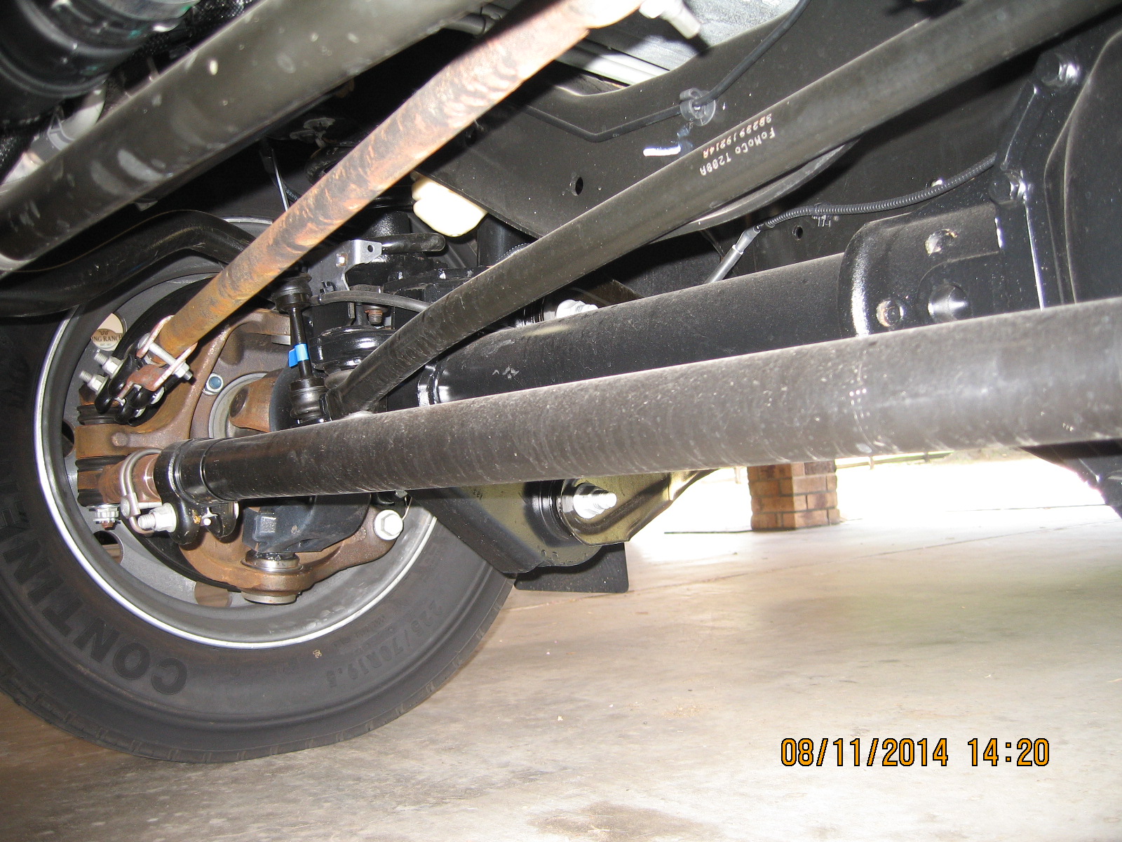

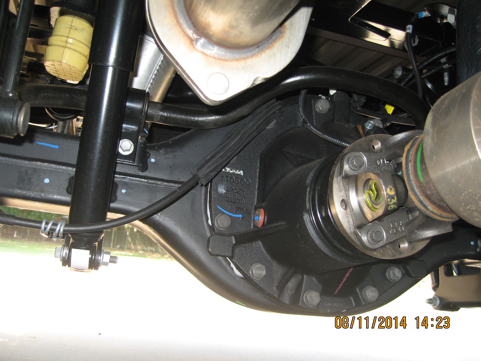

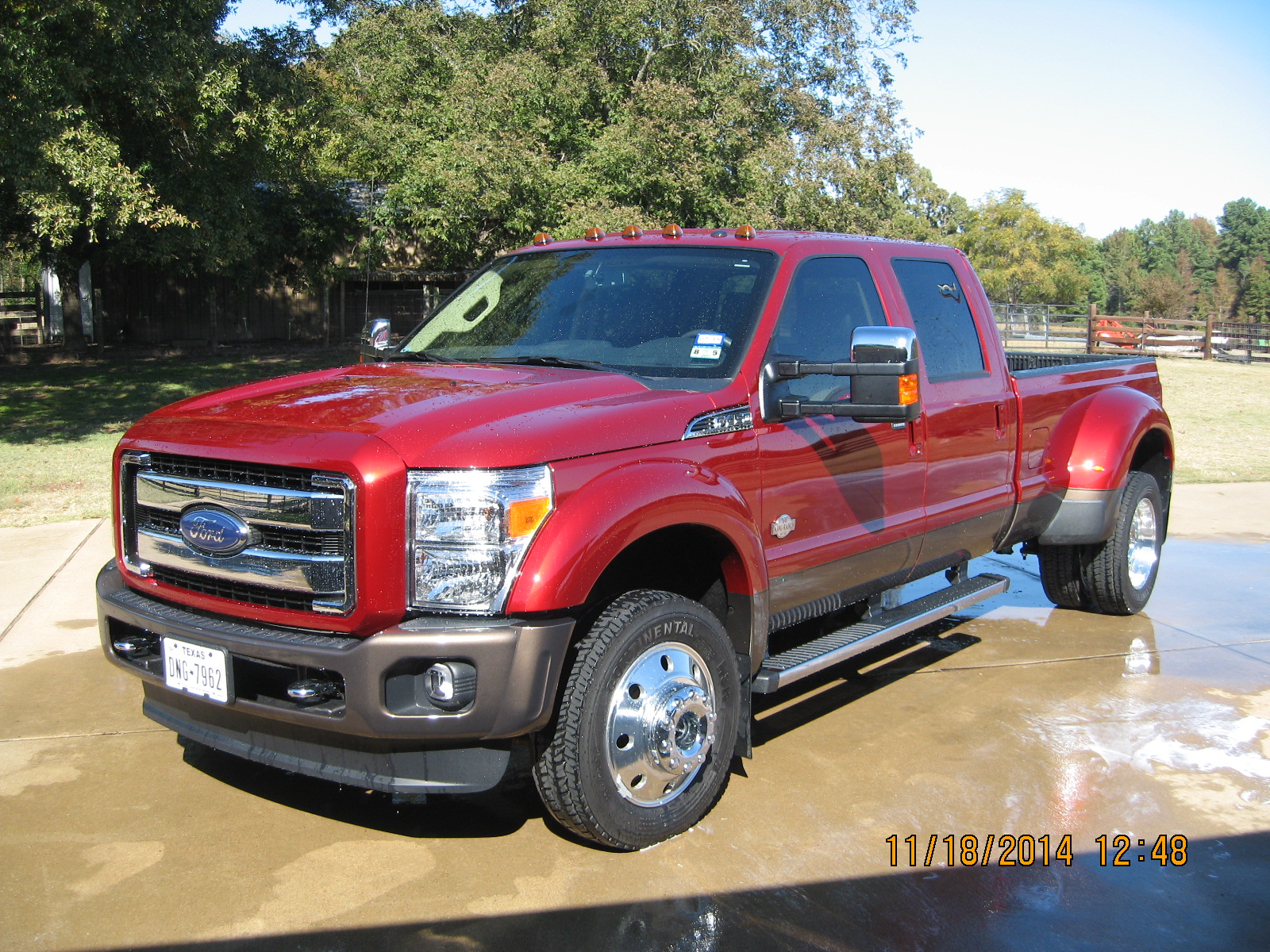

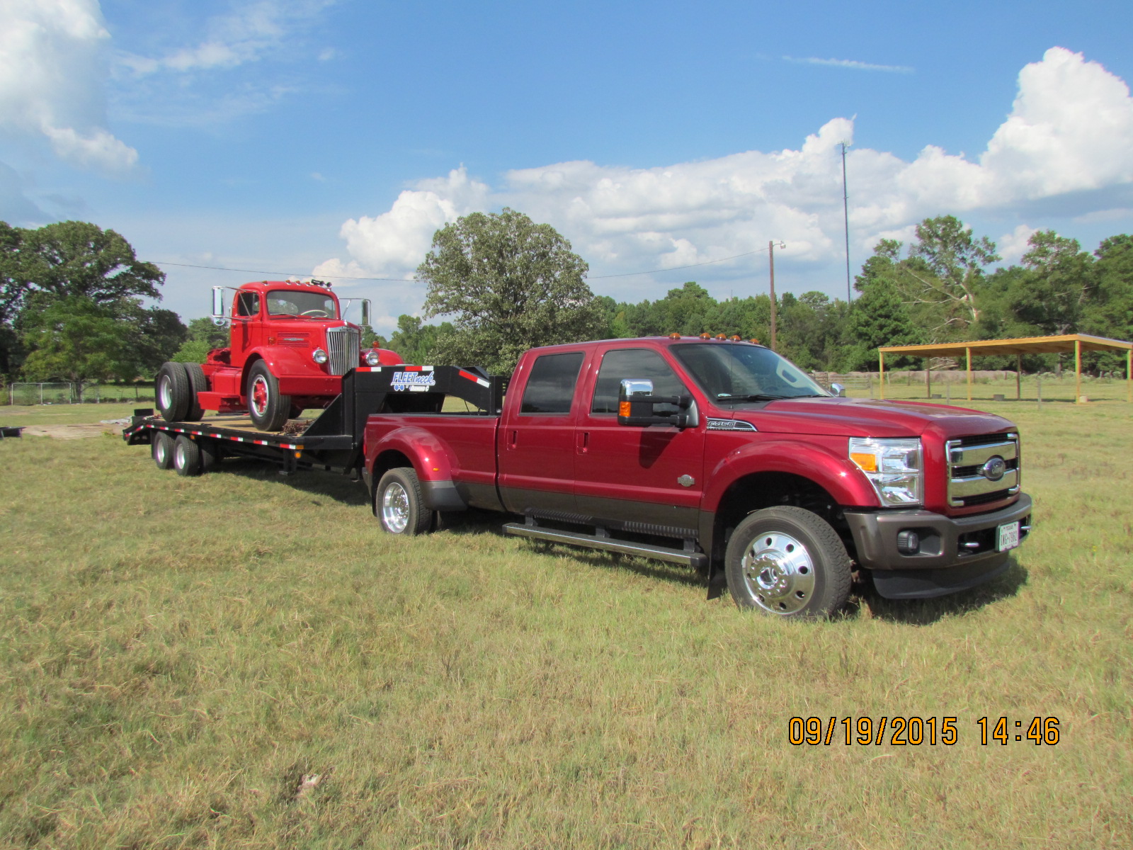

Nope, if you get an F-450 pickup you get the full 440 hp/ 865 tq engine. The F-450 pickup also has a 40,700# GCWR. Dana 130S rear axle and very heavy suspension components. The truck is no taller than an F-350.

Is the Ram a crew-cab or regular cab? Most of the time the manufacturers list the maximum payloads/towing capacities with a regular cab truck so the weight of the truck is less and can haul more cargo weight. The F-450 pickup only comes as a crew-cab and with 4wd.
