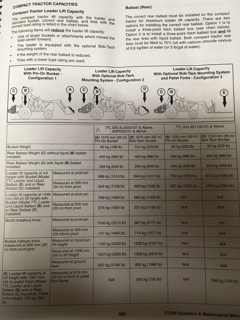

Help! Bobcat 225 can't even pickup a 1500lb round bale with 3 point

   / Help! Bobcat 225 can't even pickup a 1500lb round bale with 3 point #16
This is A picture right out of my operators manual for a 2012 CT 225
Says here if you have enough front ballast or loader you should be able to lift 1508 pounds.
   / Help! Bobcat 225 can't even pickup a 1500lb round bale with 3 point #17
I would think you might be coming up a little short on the loader according to this chart. Are you sure your bail only weighs 1500 pounds. Seems like this time of year they could get pretty heavy with all the moisture

I'm just going by farmers word.
Actually 1 bail I was able to get off ground with front loader.
So it was lighter.
So if I fill front bucket with some super heavy weight, my chances are bigger on rear end lift?
I'm using a 55 gallon barrel filled half of concrete, then 2 10×10×12 steel weights.
Doesn't help front loader. I use to keep 4 wheel drives from SNAPPING rings, as I've read in other posts.
