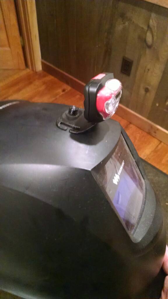

So I'm sure I'm not the first person to think of this but...
I was lamenting my cruddy shop lighting and annoyed at having to keep moving work lights while grinding today....
First I was thinking someone probably makes a welding helmet with a built-in head light. Or I could modify my existing helmet.

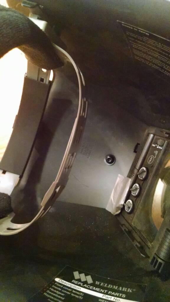

I had a $15 LED impulse buy from Lowes with an adjustable base lying around. Took off the band. The adjustable base already had a hole in the center.
I drilled a hole in the top and inserted a bolt:
Then mounted the light:

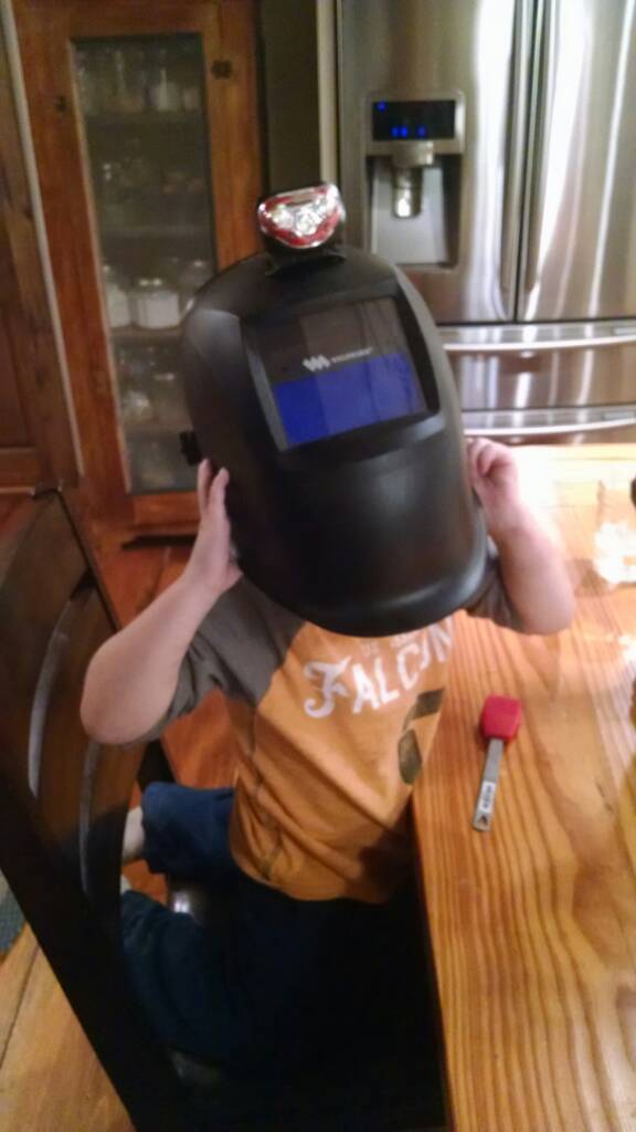

3.5 year old approves:

Hey, if your 3.5 year old son approves, that is good enough for me. Looks good. Think I'll give that a try too.

Great idea, so,, did this give you the light you were hoping for? Does it work well?
   / Helmet light
Yes, it definitely helped a lot. Not as good as a perfectly positioned spot light shinning over your shoulder but still good (and much more convenient).
I have only used it for grinding so far. Will do some MIG this weekend.
Again, this is a $15 "checkout isle" LED light. I'm sure there are brighter headlamps out there. If I were starting over, I'd find the brightest spot I could with an adjustable base (if the price was right).

Thanks Gem,
So I used it MIG welding yeasterday and it did not mess with the auto darkening (I did not have to change any settings).
I looked when I was at Lowe's and the model I have says 150 lumens on the packages. If I were starting over I'd get the 250lumen one for $5 more.
