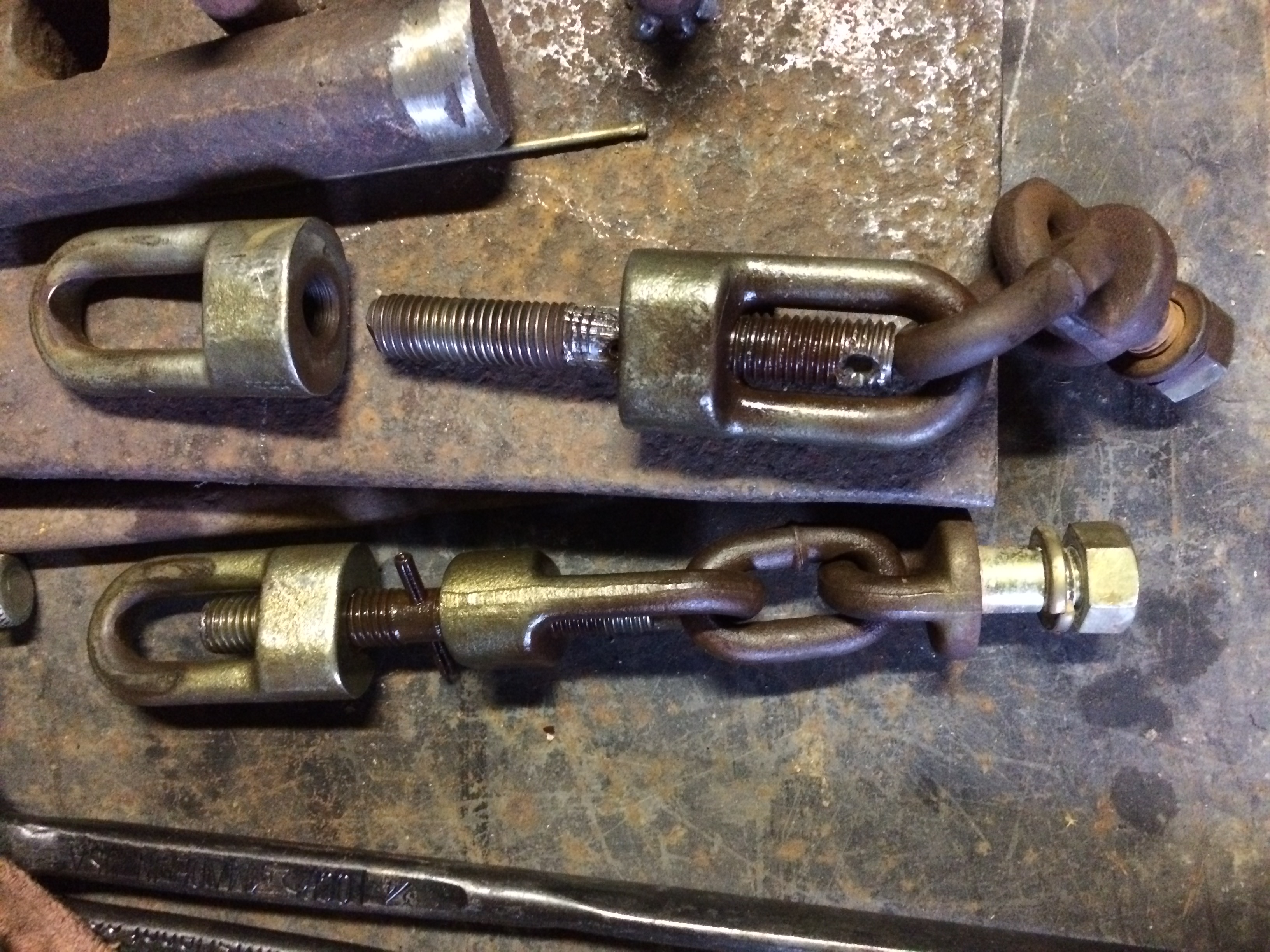

I took the sway adjustment off and got one end on both of them broken loose but now I'm trying to figure out how to break loose the other end without messing up the threads. I got one end loose on one side then in the process the other end broke loose but I got the initial end freed jammed and can't get it back out. Im still figuring that one out. If I can get the threaded rod out I think I can replace that part without ordering it from JD.

Hi Brian, welcome to the forum! I also have a JD 790 and love it. I can probably help out with some of your questions. As for the adjustment links on your sway bars, it might be best to replace the one that's frozen. The threads on it look like they are pretty well boogered up anyway. Once you get them figured out, raise the implement and adjust the links so that the implement is centered behind the tractor, and has minimal movement side to side. Once they are adjusted correctly, make sure you put the little pins back in them so they won't move out of adjustment. Believe me, they will move too, without that little pin to lock the threaded shaft in place.

Welcome Brian, those will be a lot easier to break free mounted back on the tractor, heat the frozen end up with a propane torch and touch it with some bees wax and let it cool, works almost every time. Remember one end is RH thread, the other end is LH thread.

Thanks for your suggestion about the sway links. I'm trying to determine how to free the other end. I was thinking of welding a nut in the middle and using a wrench to grip it since its buggered anyway. It does have the Model 70 loader. Its missing the rod on the RH side of the tractor to take the loader off. I'd like to know what you did. Thanks

A large pipe wrench should be able to break the threads free. Then chase the threads inside and install new rods. If you had the proper nuts for this you could try double nutting together and see if that will free the rod.

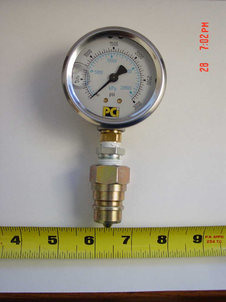

Yes, you can add shims to the relief valve and it will increase the hydraulic pressure by a modest amount. You will need a 0-3000 PSI pressure gauge to check the pressure before and after shimming it. Just don't go over 2500 PSI. The factory setting is supposed to be 2050 PSI.
Here's one of the many threads on it. Scroll down and you will see a pic of the JD shim kit with their part number on it.
http://www.tractorbynet.com/forums/john-deere-owning-operating/231046-790-3005-hydraulic-shimming.html?highlight=shim+790
Here's a pic of the gauge I bought from a local hydraulic repair shop for less than $30. The gauge was like $20, and the quick connect fitting was a few more dollars.
