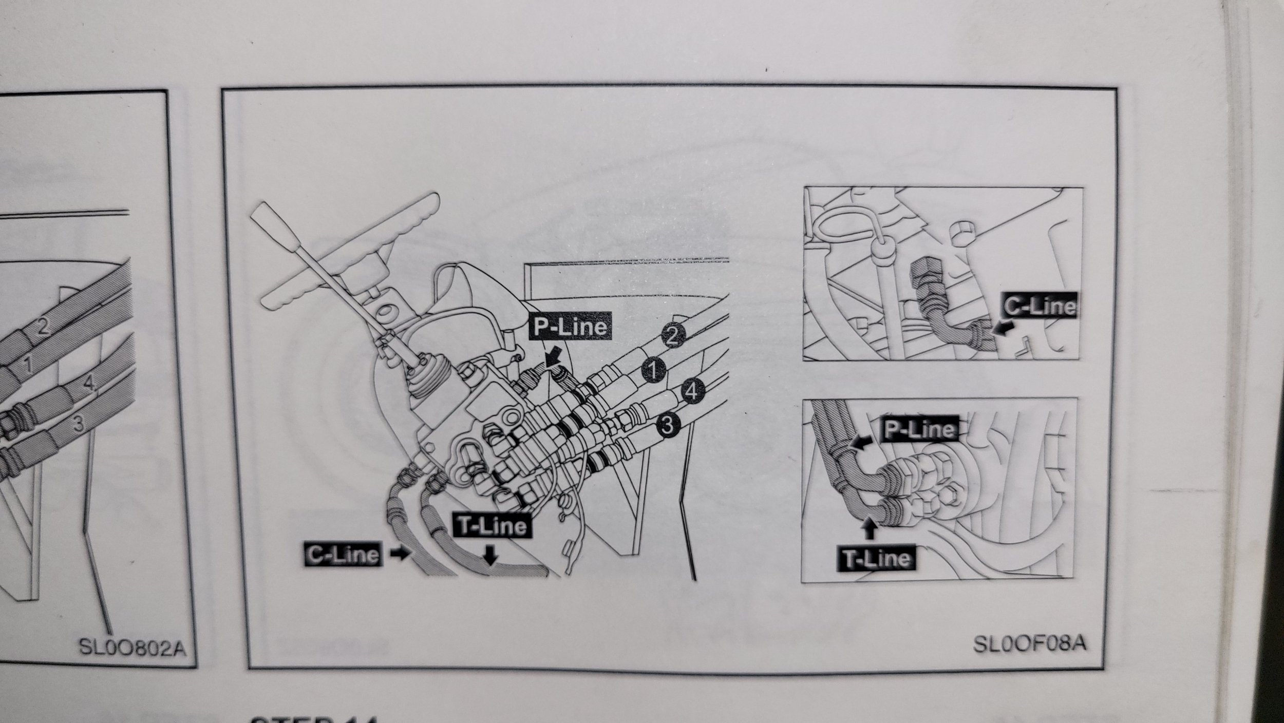

Someone had mentioned this earlier but I'm just checking the lines now.
Looks like my C and T lines are reversed on my loader control valve according to the loader manual. My loader control valve has a port marked T and the T line is connected to this port cut the manual says the C line should go there. T usually references the return to tank port which is what the C line is.
I can't find the port diagram for this valve block.

   / Hello from a new Branson 2400h owner. #27
So much hackery going on in this tractor.
You may want to trace everything from the pump all the way to the rest of the system.
If those lines are indeed reversed, that means if you try to raise the 3 pt while lifting the loader, it should make the 3 pt go up. You do want to still fix those connections though.
   / Hello from a new Branson 2400h owner. #28
C is power beyond and should go back to feed the 3pt. Likely that is your problem. But trace the lines as ptsg suggests.

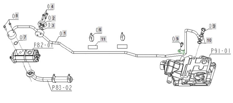

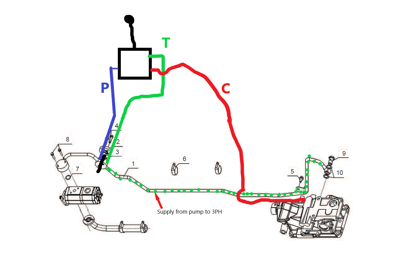

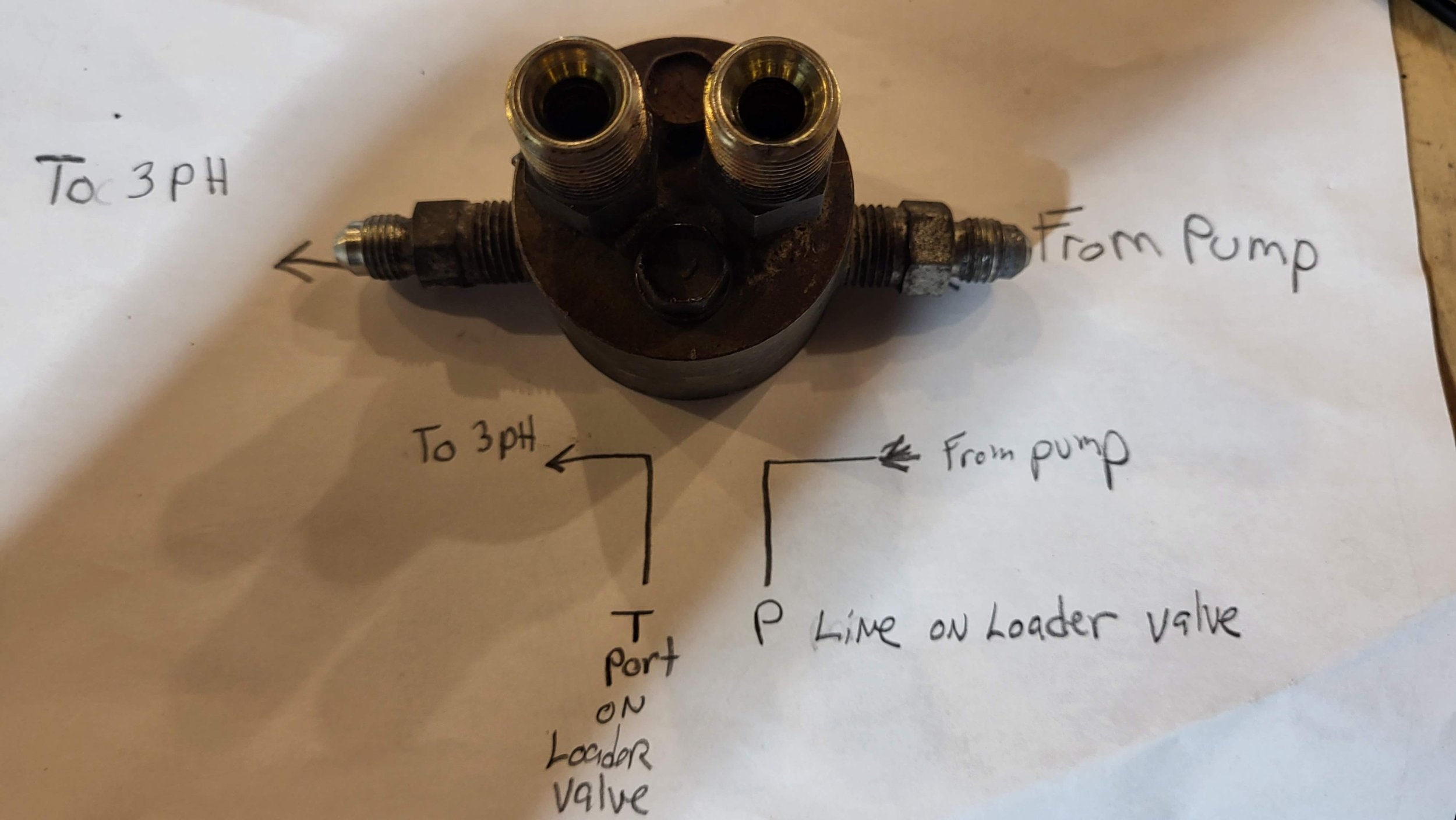

Well this is unexpected. The round block feeding my loader and 3PH is not ported as I expected. I thought it was supplying fluid to the 3ph as it originally would have without the loader. The only way for it to get fluid now is if it goes through the loader valve first. The C line is not connected to the 3ph positioning valve it's connected to the rear tank as a return to tank line.
Without the loader this block is passthrough from the pump to the 3PH as the parts diagram shows. It supplies the 3ph directly.
With the loader this is my routing.
oldnslow do you have 3 lines connected to your round block or 4?
   / Hello from a new Branson 2400h owner. #30
There is your issue with the 3 pt. Swap those lines and it should work again.
Basically the loader valve is dumping all the fluid to the tank with the joystick in the centered position.
