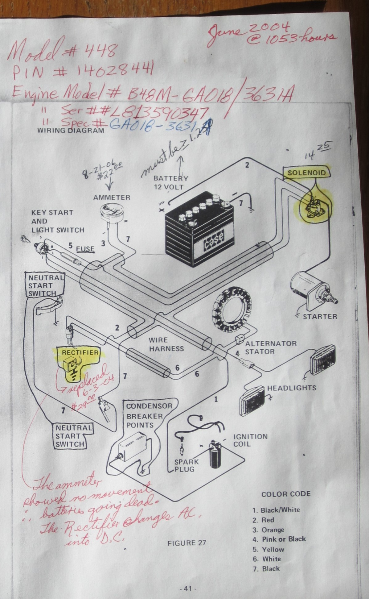

I have installed the new starter and the new voltage regulator. The starter turns when key is not but the bendix is not engaging the flywheel. I have over 12.20 volts at battery. I have at least 12 when the key is turned on without engaging the starter. The strange thing is that I have 12.2 volts at the voltage regulator without the key on at the secondary posts of the regulator. I don't understand why the secondary post starter- voltage regulator - battery are energized with the key off. I have a good ground at the battery to the engine block as well as the voltage regulator. Something else is going on and snow is supposed to be here in 2 days. In the mean time, I have disconnected the battery to voltage regulator secondary until I locate the problem. If anyone knows what further test I can perform or what other component that I have to test, I will gladly explore all options so I can run this tractor. Thank you

The solenoid is charged with over 12volts at the secondary posts when the key is not turned. I went back to test the solenoid wire (Yellow) that connects to the S terminal and there is no current when the key is turned on but not all the way to turn starter. I am going to begin testing the ignition switch and the wires going to the ignition from point of origin to the end point for continuity. Through a process of elimination, I hope to resolve this issue soon.

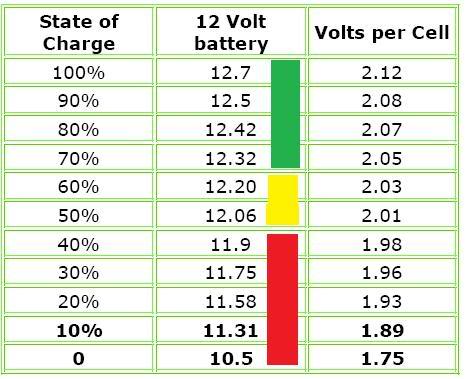

RJC55, evidently english is not your first language. You need to learn more about basic electricity and use a better translator.
Did you bench test the new starter to see if the bendix worked?
12.2 volts is only 60% charged:

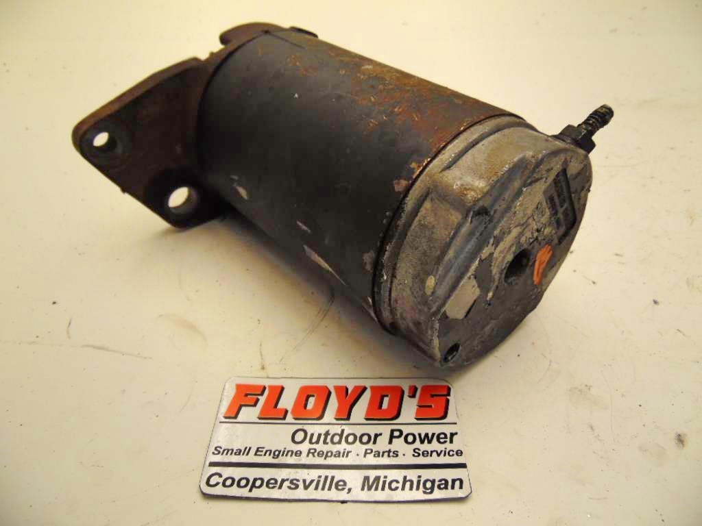

Thank you very much for your patience and understanding . The last time I checked my voltage at the battery before attempting to start it, the battery read 13.73 volts . The starter is brand new and under warranty . When I tested the starter I

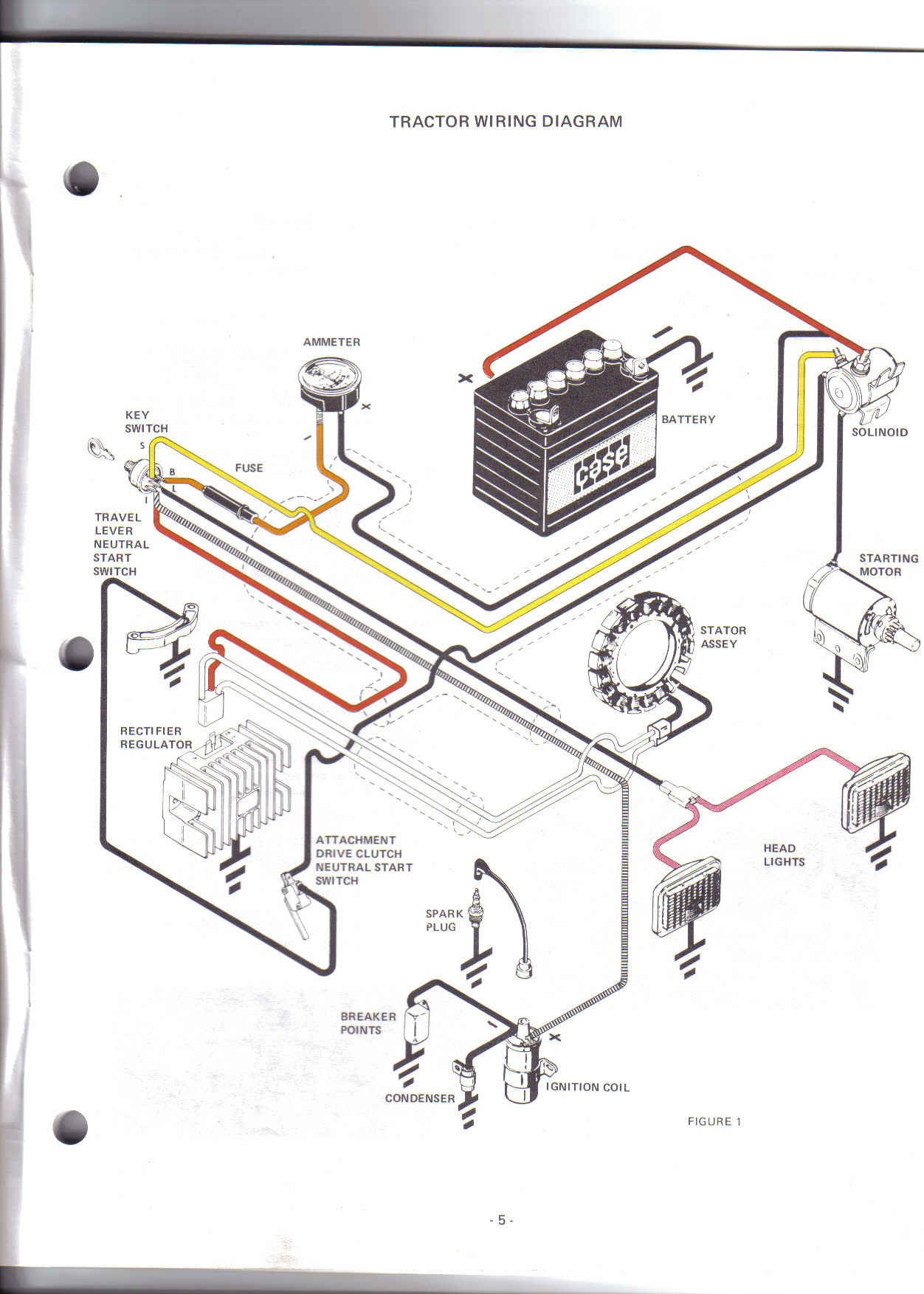

I used a set of jumper cables off of My Chevy K2500. The starter turned but the Bendix did not kick out . I have installed and wired my own electric service here and had it inspected and passed. My issue is D/C voltage as it relates to my Case 446. I am going through the process of tracing a Thick red wire with an inline fuse, an orange wire with an inline fuse. Two brown wires, a blue wire, and a yellow wire . I believe that someone definitely ran a bunch of wires and I'm just trying to sort this out so I can get my tractor started. I just graduated from Corning Community College a year ago with an Associates Degree in Business Management with an overall GPA of 3.67 and fully eligible for a scholarship if I choose to pursue my Bachelor's Degree. Besides, I'm only 62 years old. My objective is not criticism or contention, just resolution. Thank you.
This doesn't tell me if it was a bench test, so guess that it was installed.
I would remove the starter and turn the bendix by hand both directions and see what happens and if it feels smooth.

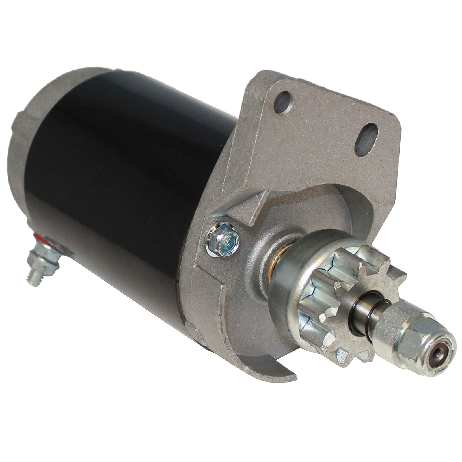

I also had to disassemble the spring and gear because the pictured mounting assembly does not match with the original . The starter works fine
How can it work fine and not crank the engine?
I have to do some trouble shooting with the wires to the solenoid because the starter just spins but doesn't lock out to engage the flywheel.
I guess you mean move out. The solenoid is a heavy duty high amperage switch that applies power to the starter. If it spins the bendix will move out and engage the teeth on the flywheel.
