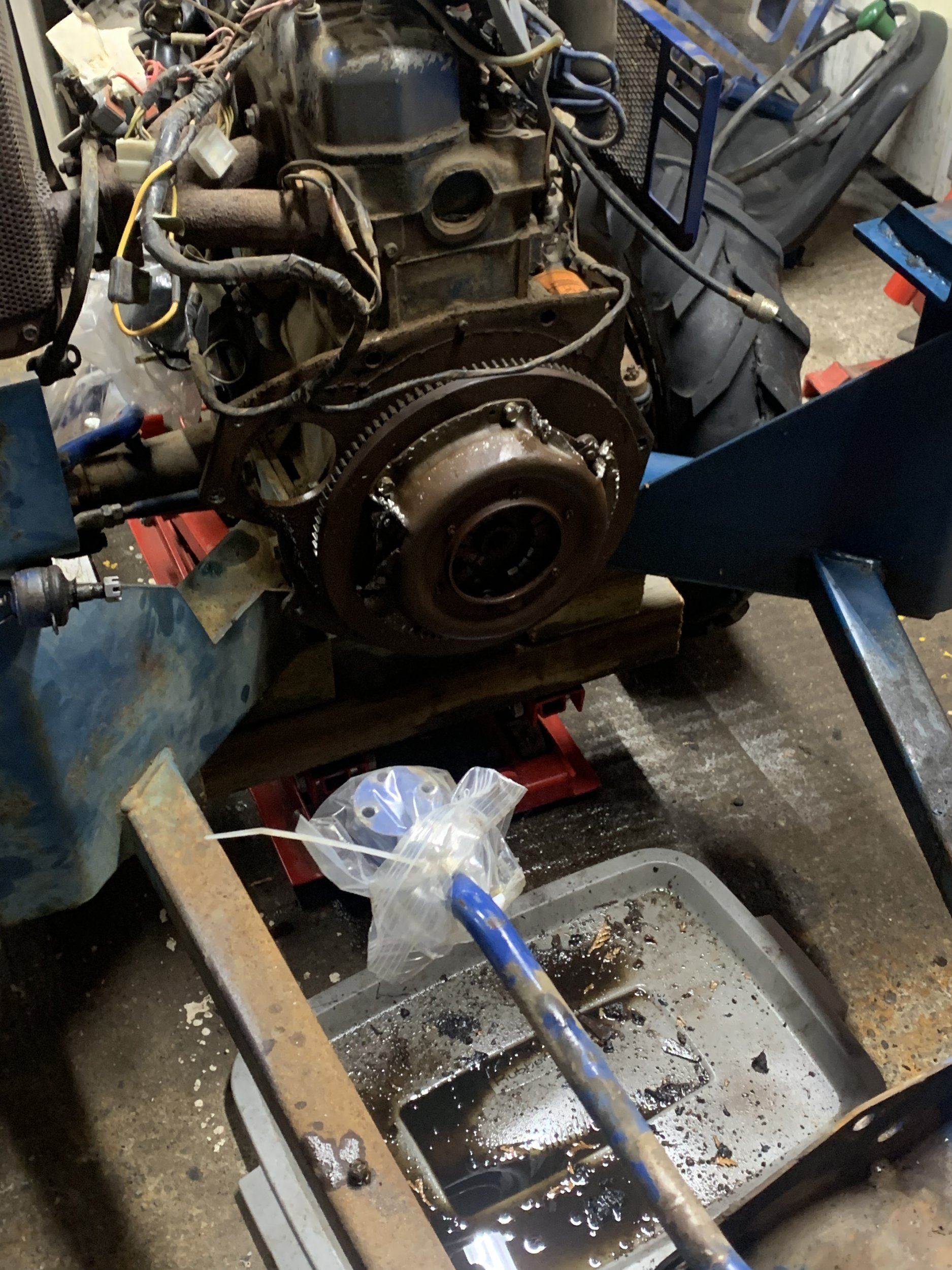

I have a Satoh buck s470d purchased it 2015 haven't used it much but noticed this past summer the clutch was not disengaging all that well as i could hear the clutch still scrapping with the pedal fully depressed. This weekend I went to start it and it now does not disengage at all. I removed the starter tapped on the fly wheel, removed the a lower drain bolt on the housing and sprayed up in the bell housing with penetrating oil. I then blocked the clutch in and am now letting it sit for a few days. I tried taking the 4 bolt out of the base of the steering box to see if there was an access point into the top of the frame to see down inside but could not remove it.
Is the anything else I ca do as I am not looking forward to splitting the tractor.

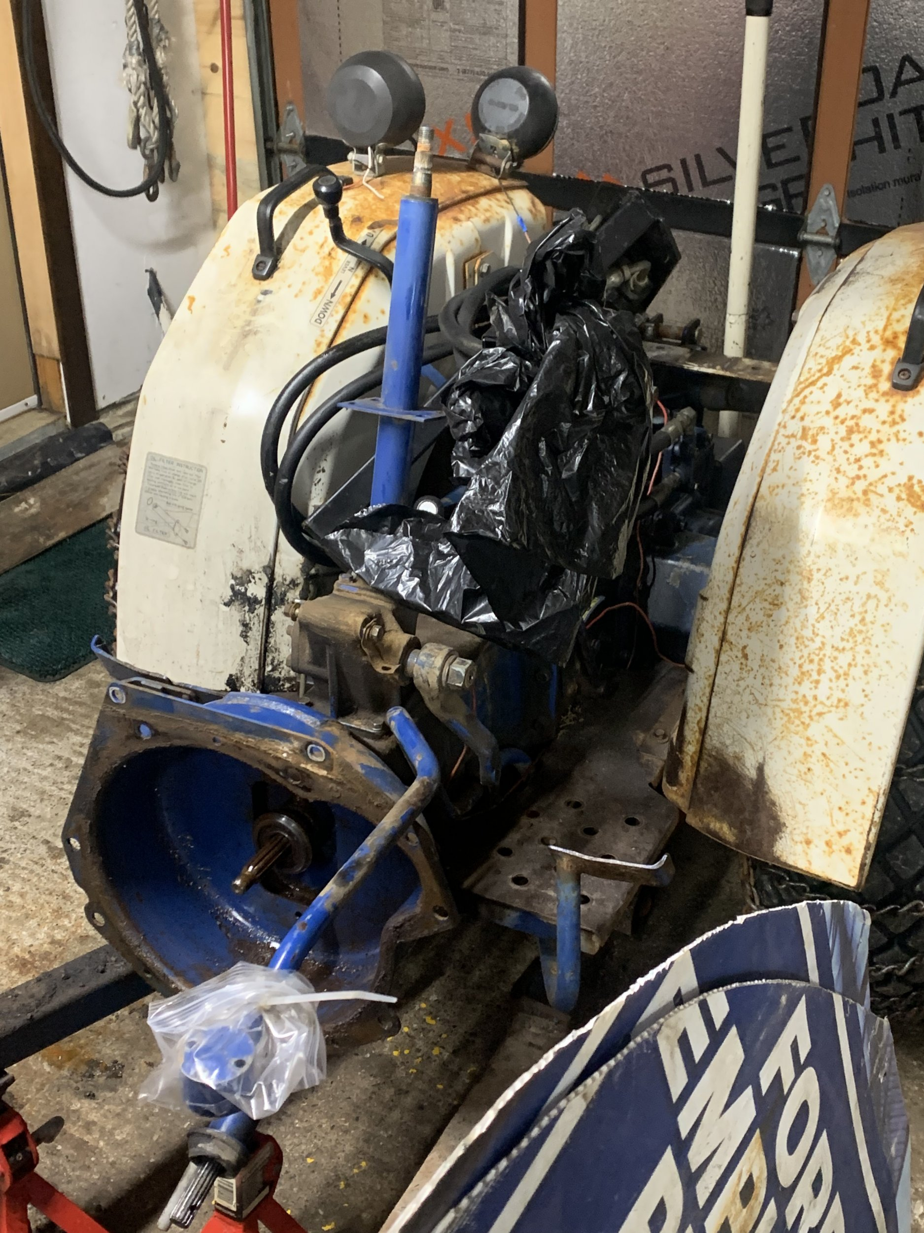

Hello again, so to start when i purchased the tractor 6 yrs ago the outdrive on the starter had let go and was flying around in the housing and that is why it went up for sale. When i got it i used a magnetic pick up tool through the starter opening and got all the pieces i could get. I had the starter rebuilt and for the past 6 years all has been good. As of last week when the clutch started to give me problems I have now split the tractor and can now see all the damage that happened 6 yrs ago. The pressure plate has missing sections and all the mounting bolt heads are damaged. So i will be needing the pressure plate, clutch disk and bearings. Im sure I can mind locally some good bolts to replace these. My question is living in Ontario is there a local source for the parts or does anyone know where I can get what i need.

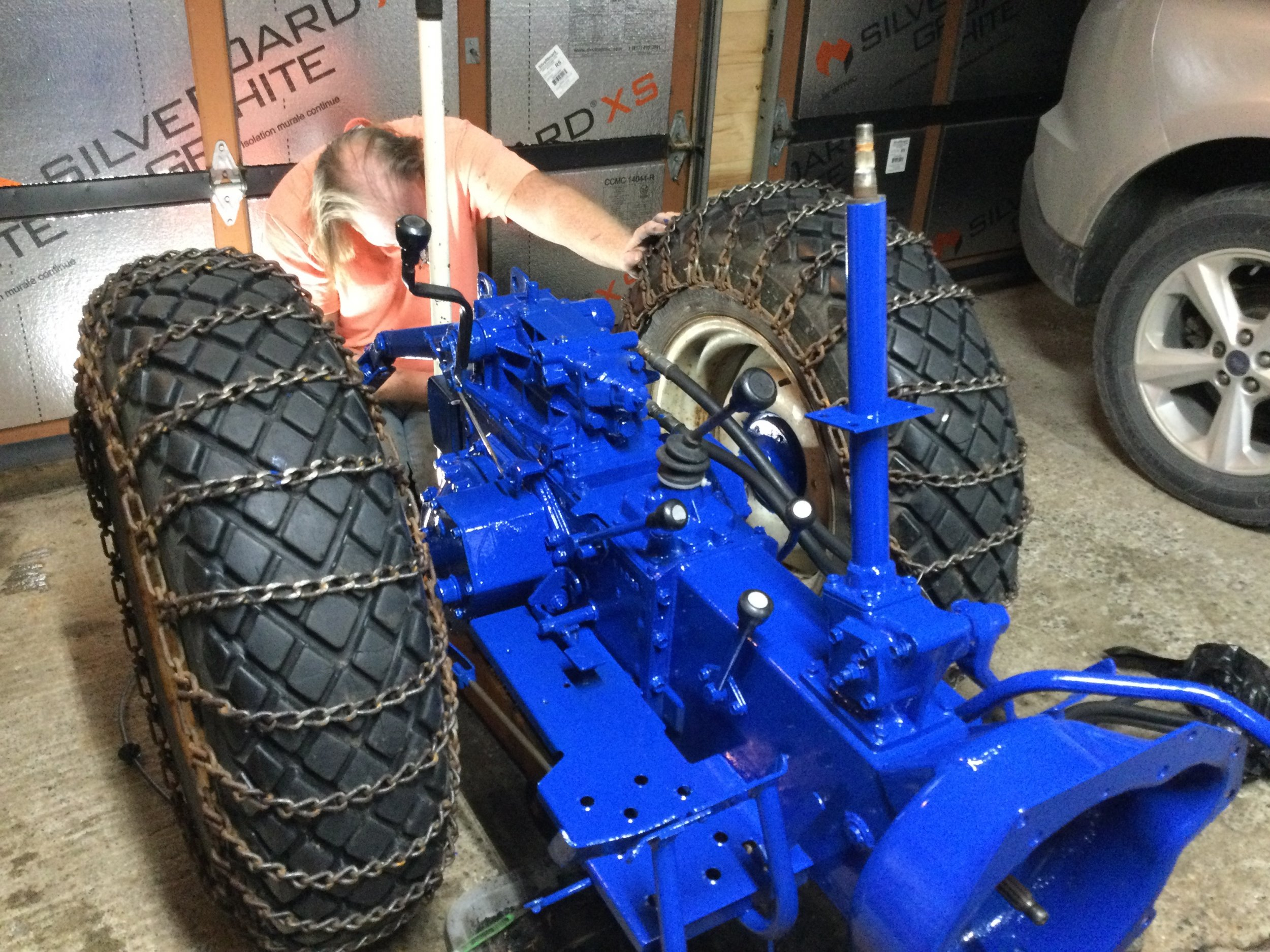

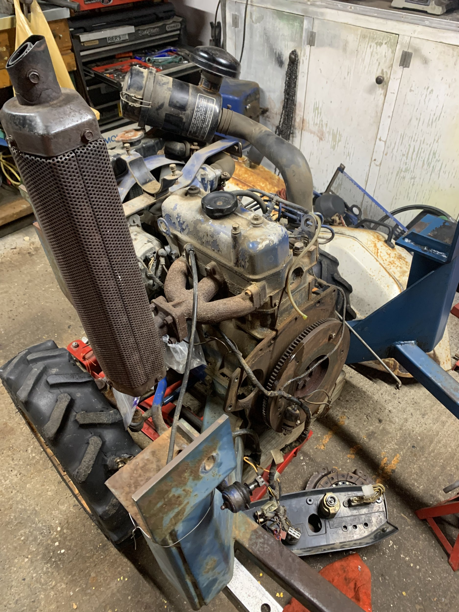

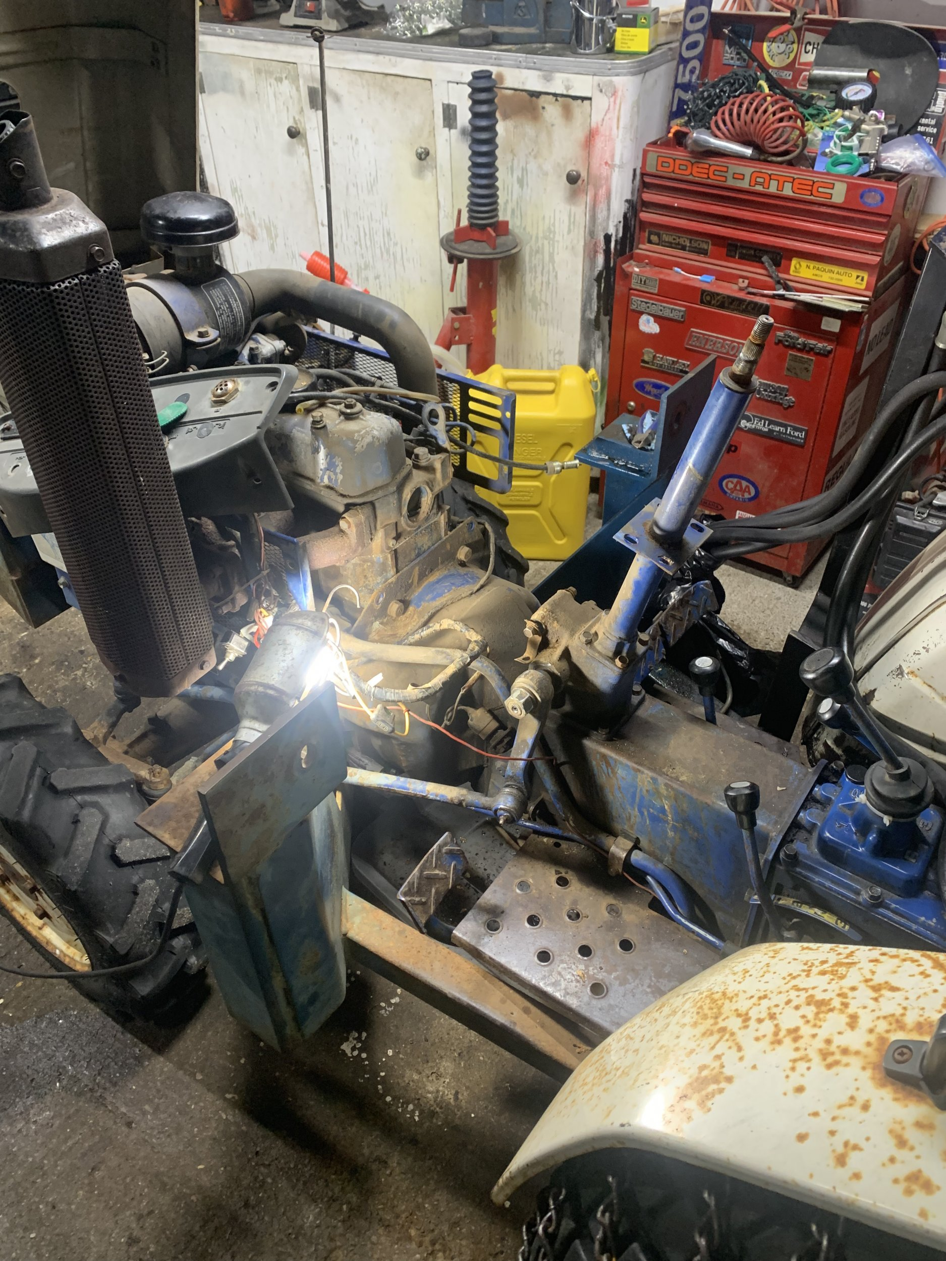

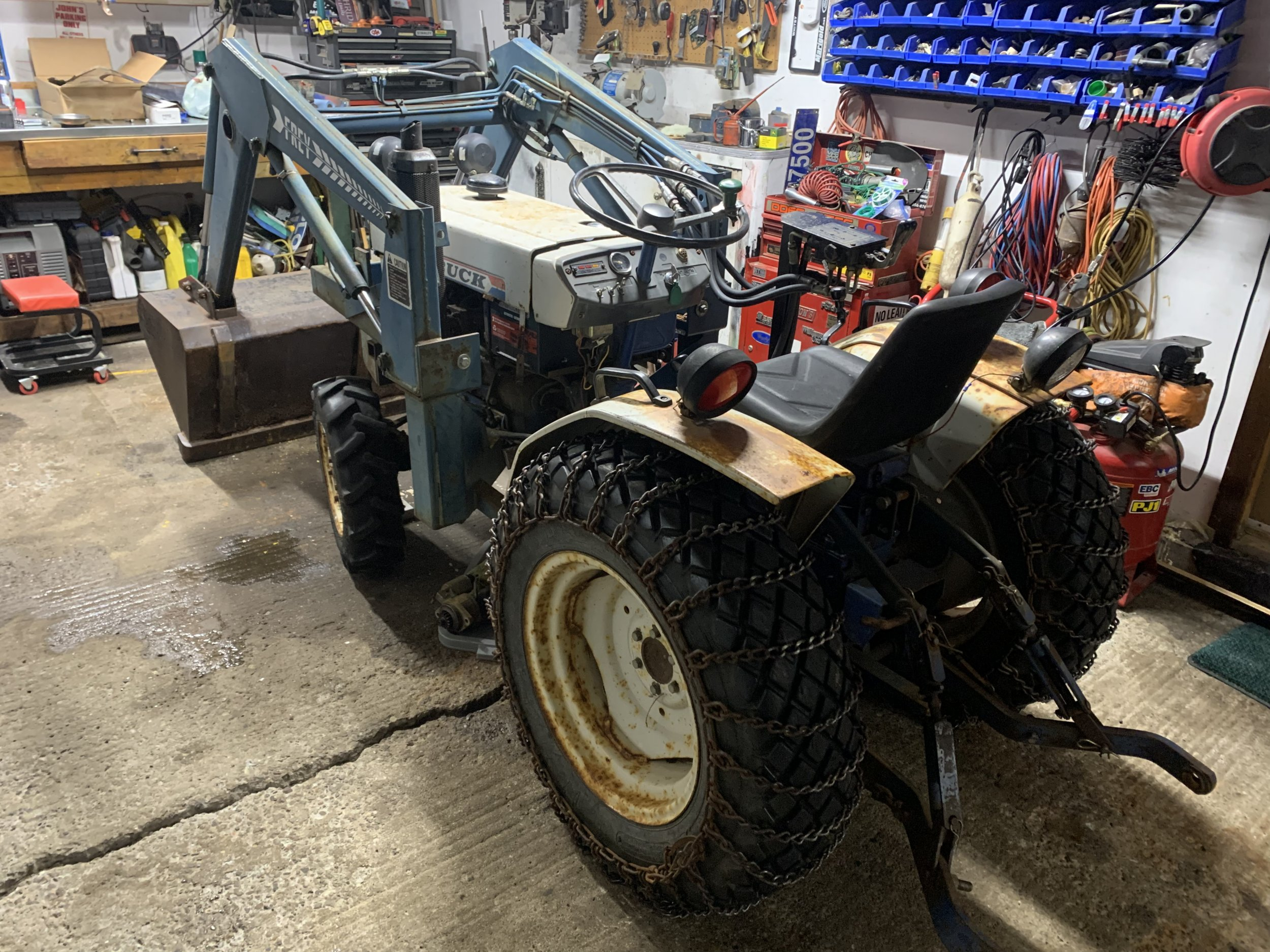

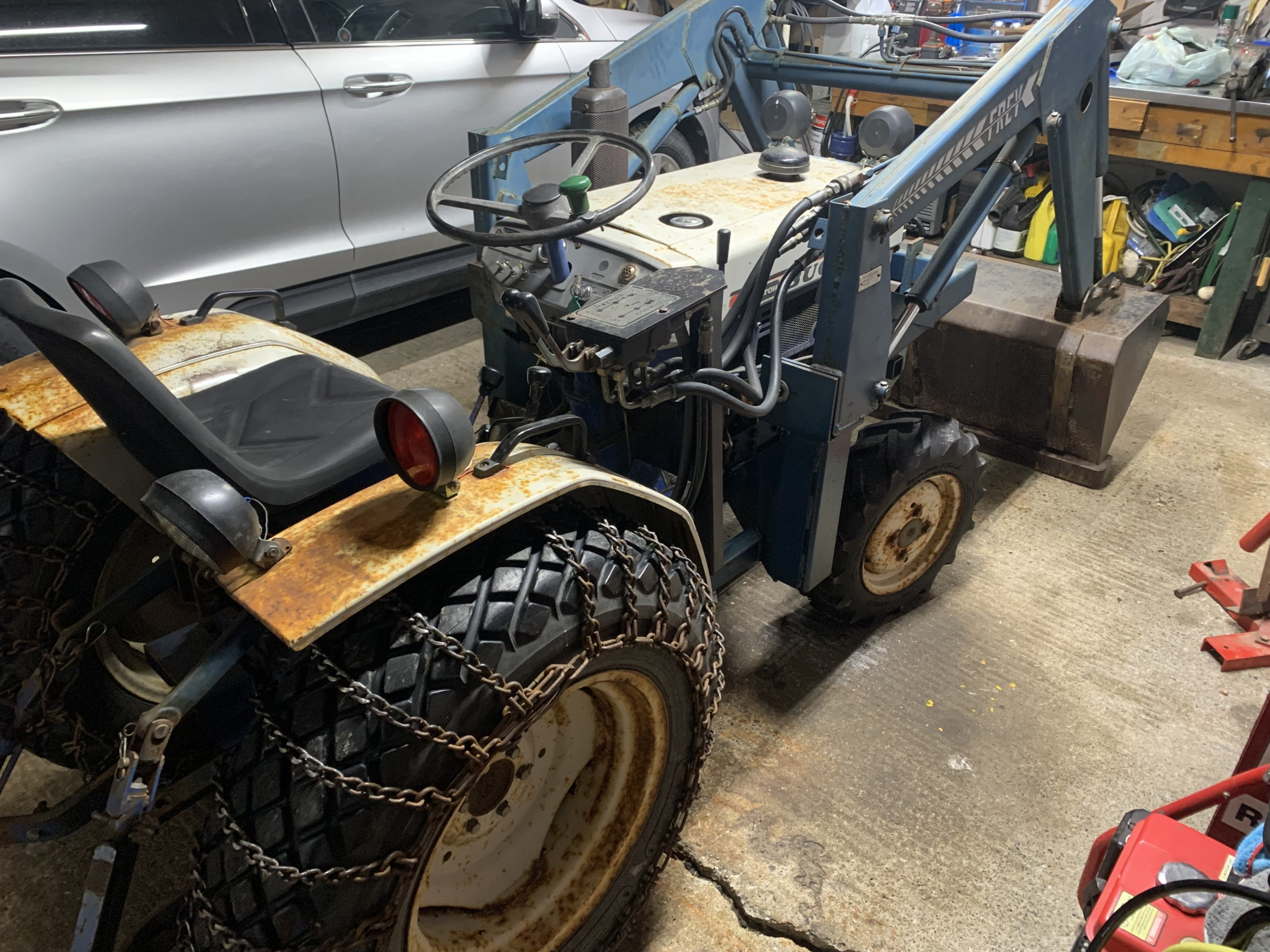

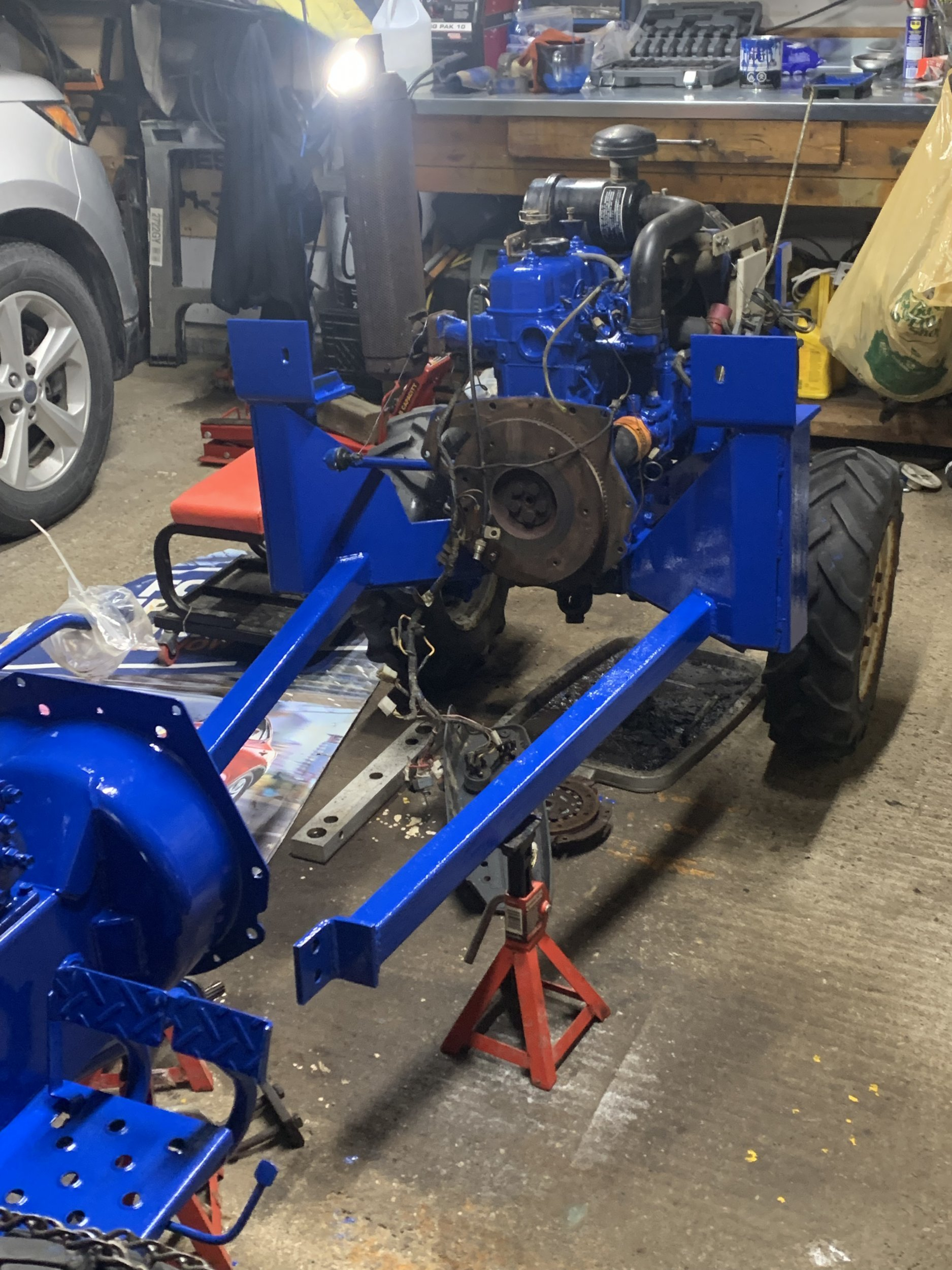

/ Hello All

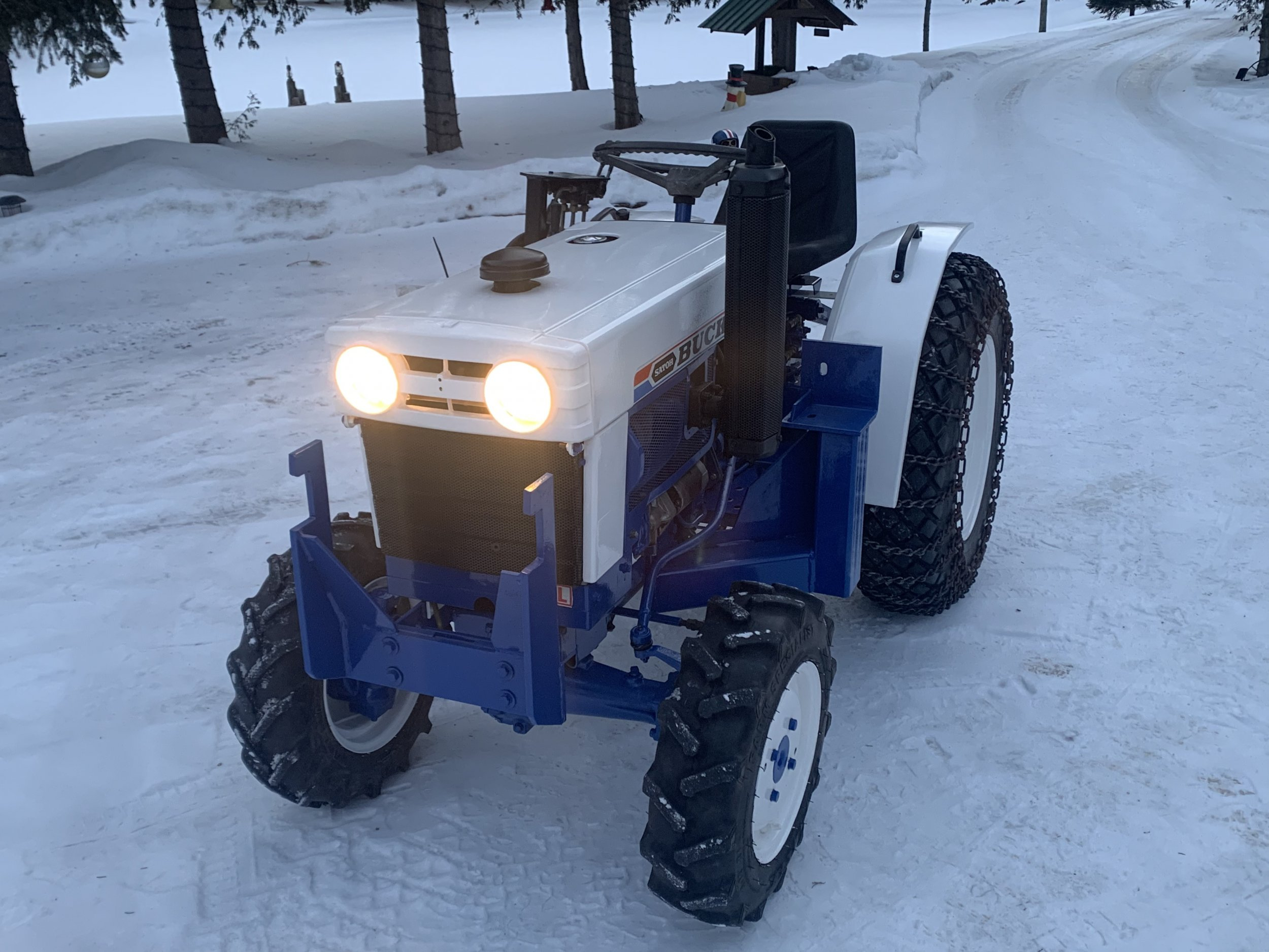

Well almost 6 weeks since I split the buck, valley power was great to order from got all the parts needed-while I was waiting decided to clean, degrease, sand, weld up cracks, do some body work, paint, replace wires, upgrade lights, hydraulic houses and fitting, and make the old tractor look new again.

/ Hello All #11
I can only imagine how much work that was, but man does it look great!
