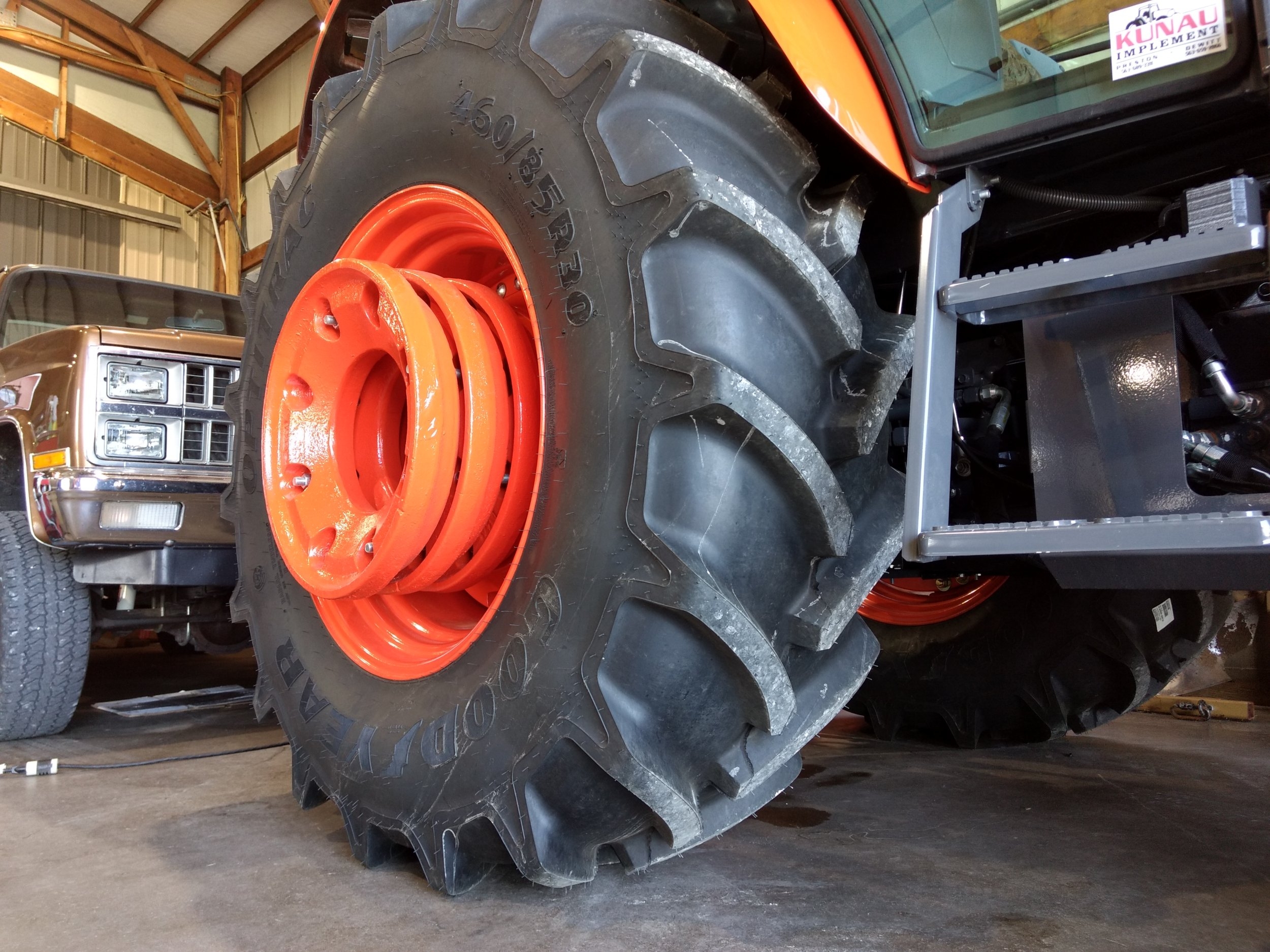

I have a M6800 and I put 2 weights on the inside of the rims and you can barely see them. I took the wheels off and used my motor puller and laid the tires on the floor, put the weights on, raised the wheels up and put them back on. It took me a little over and hour.

Decided to only use two wheel weights per wheel. The third weight just protrudes completely outside the side wall of the tire. So I have two wheel weights for sale if someone is interested. I am located Frederick
Maryland. They are heavy so if you are closeby maybe best to save on freight cost

They are 200 lbs plus so very difficult to handle without a FEL or forklift. They are from the kubota dealer and is a regular option for the M7040. Mounted three rings on each side also have Cast iron hubs as well as filled tires
The Kubota M8126A weights as pictured are 164 Lb. each. The required bolts probably weights another 5+ Lb.s per weight.

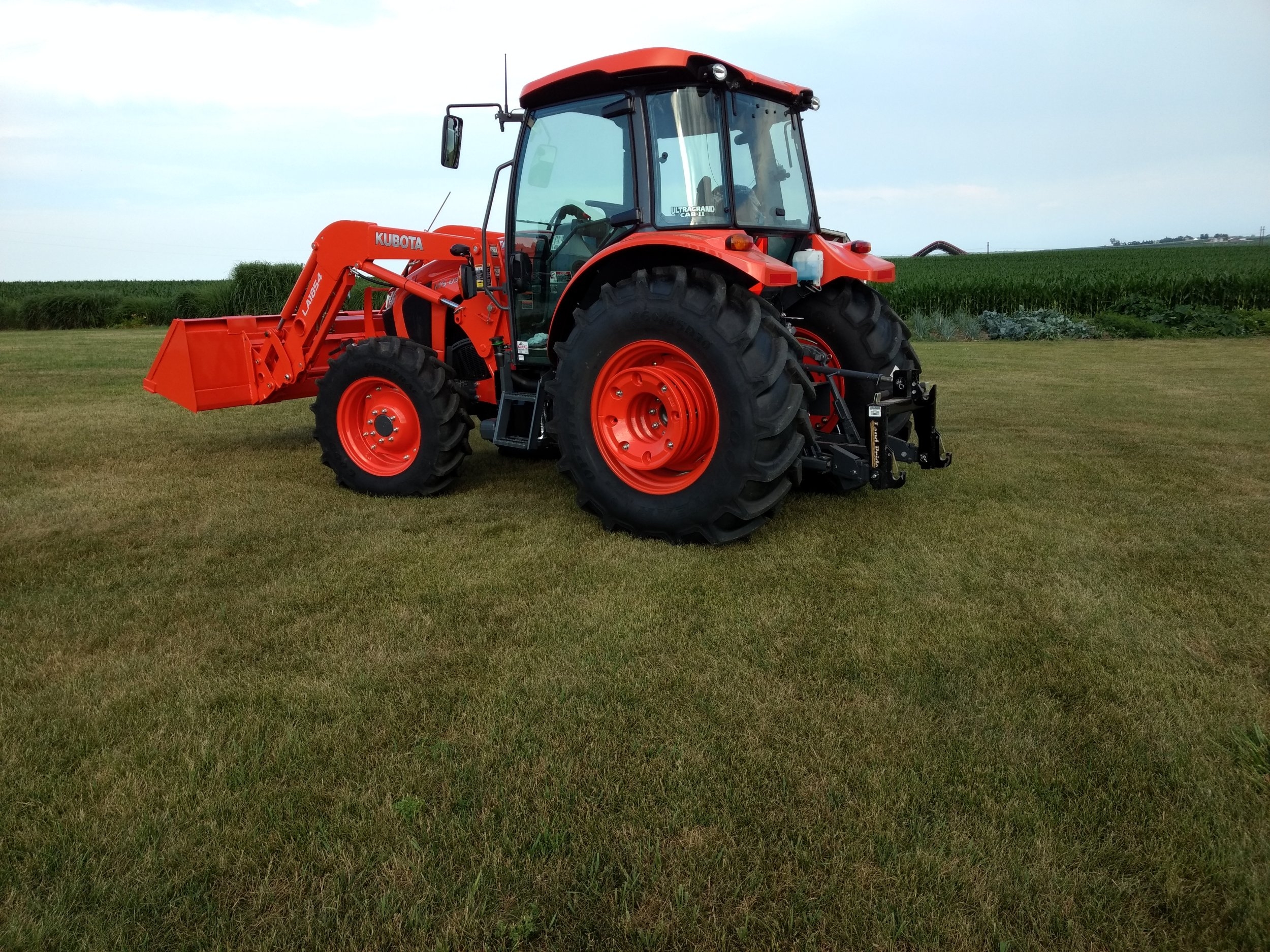

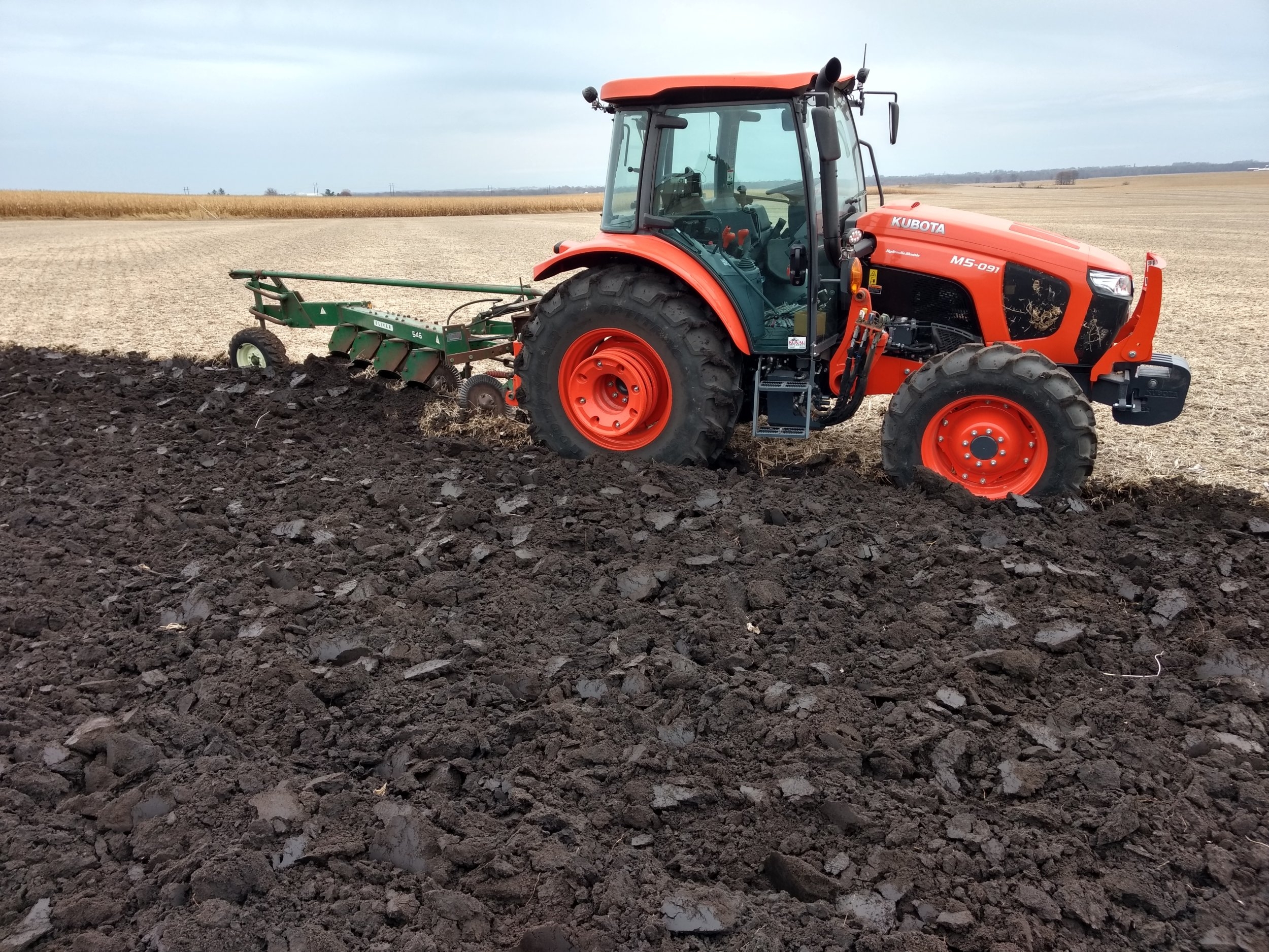

I like my tractors heavy and my chics light. M5-091 cast centers, weights and radials.

Nice ground.
Thanks. I grew up on this farm, I spent many of my formative years plowing this farm with a International 656 and a semi mounted 4-14s plow. When I saw this plow for sale, I couldn't resist, I use it for "Recreational Plowing".
