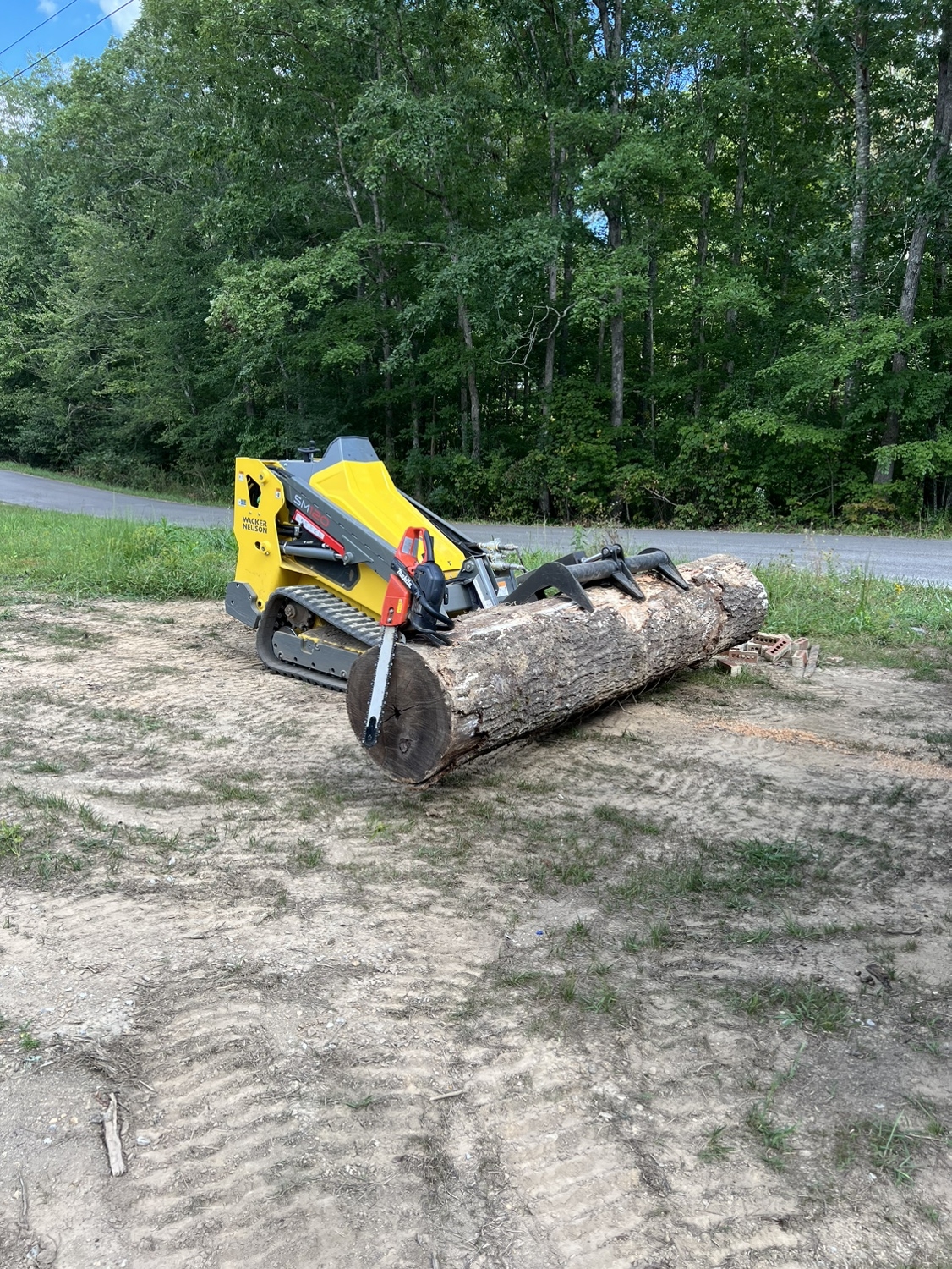

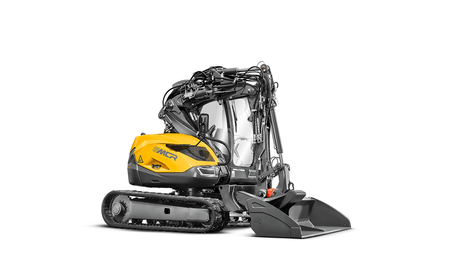

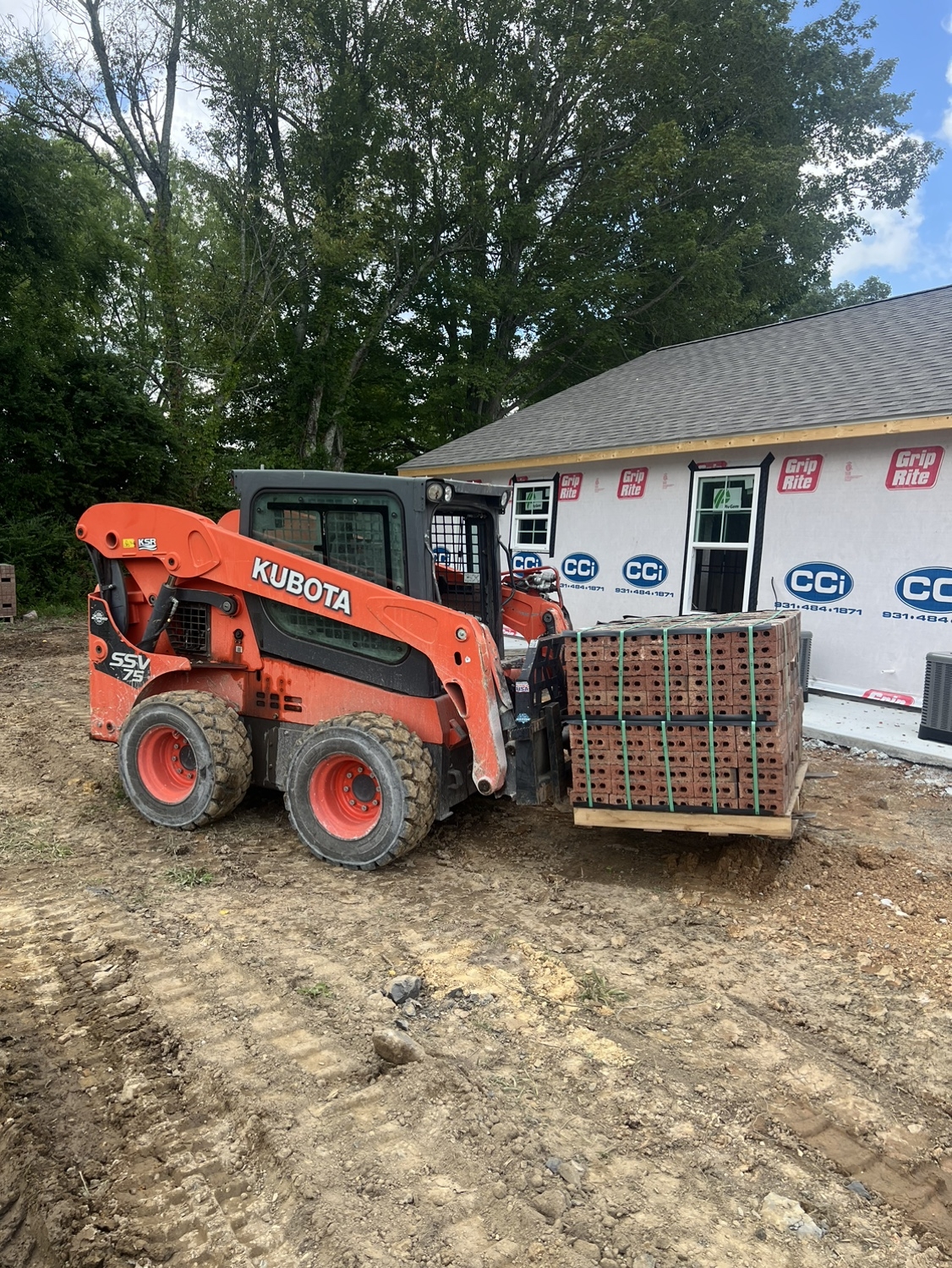

We just doubled the price again but you can have a seat with ac and lift 2 tons. The one with wheels is my neighbor’s machine. It has 3200 hours and works hard on a paving crew every day. A tractor would have been broke every way you could break a tractor if it did the same work.
And one step up gets us into a Mecalac skid/excavator
You get one machine at the price of 2. I can’t make that make sense and and apparently most people can’t either because I’ve never seen one on a job. There’s less money in these machines than what that costs by a good margin.

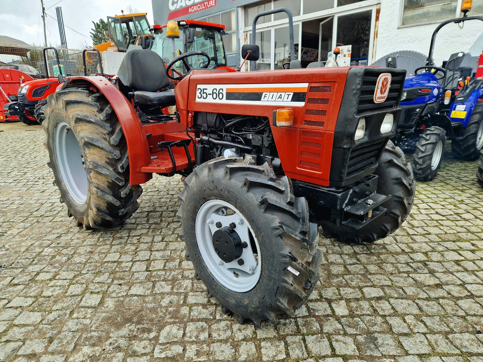

About the only compact I know that could sustain some serious loader work is probably the Fiat 35-66. Arguably one of the best compact tractors ever made.
One of the best things about this tractor is that it has planetary final drives on both front and rear axles. This axle design can handle some serious abuse.
I don't think these ever made to US though.

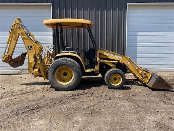

The JD 110 Backhoe was a commercially designed compact TLB. Kubota has the B26 and the L47, but like all things Kubota, they are not built heavy. They are on the lighter side of equipment specs.
/ Heavy Duty Compact Tractor #27
The JD110, the complains ive heard, not home owner, utility companies that had them; so keep that in mind, they ar2 comparing to a JD-35 mini or a JD-310 TLB; 1) Gutless loader when pushing piles/backfilling. 2) low road travel speed
They compliment its back boe digging power
/ Heavy Duty Compact Tractor #28
I agree that they aren’t built to the level of real industrial equipment but neither was the 110. The 110 had more problems breaking than the M59 did.

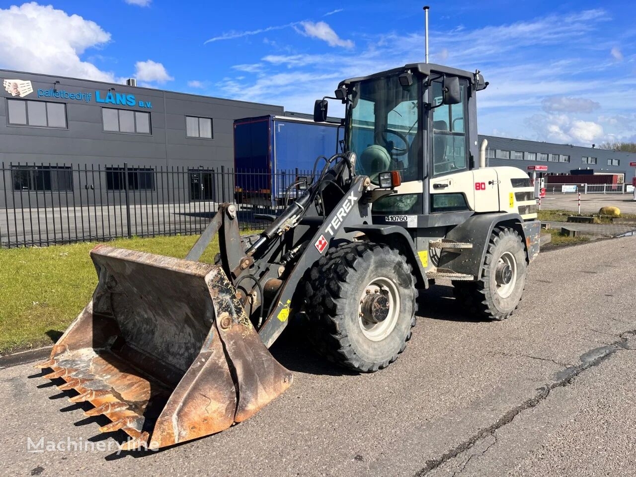

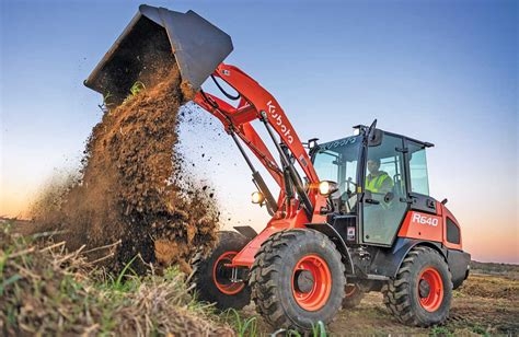

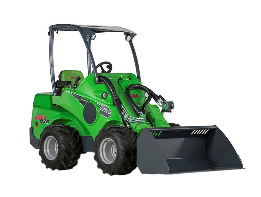

On the other hand, if the OP is looking for an heavy duty tractor just because of loader work, might as well just get a machine that was actually built to be a loader.
Those smaller articulated wheel loaders, like those Avant, Giant, MultiOne and other makes, are designed and built to be a loader. Can handle all the abuse you can put on those. Offer faster and smooth hydraulics with a lot more reach using the telescoping boom.
More expensive than a tractor? Sure but then again, it's built to be a loader.
I would put my old Rhino 554 up against that Fiat as far as the size of castings and things like hubs and rear axle size and weight, the 554 bare weight is 5200lb+ before ROPS, wheel weights, or FEL, with those basics around 7500lb.
The Op sounds like he actually needs an articulated wheel loader.

Here is some Fiat 35-66 information:
Fiat 35-66
/ Heavy Duty Compact Tractor #32
Fiat 35-66
That is a neat machine Lots of gear choices locking front and rear planetary axles and VERY compact.
They don't list any FEL info - wonder what it came with?
