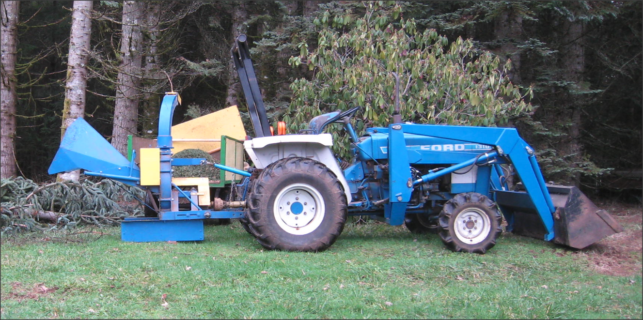

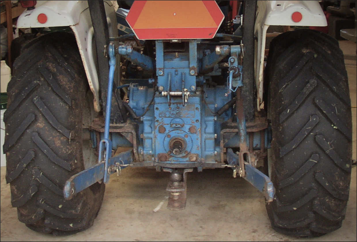

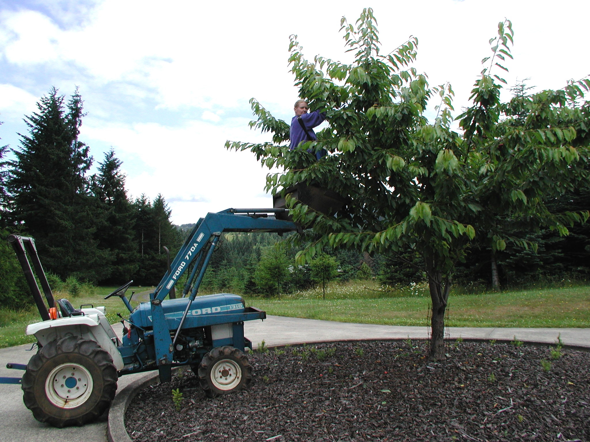

I bought about 900 hour used 86 Ford 1310 for $6000 about 26 years ago and we have used it for all kinds of projects around the property but I don't consider it to be a farm tractor, however it's been excellent for my needs and served us very well.
It's more heavy duty than current models are.
So far spare parts have been available for what little I have needed.

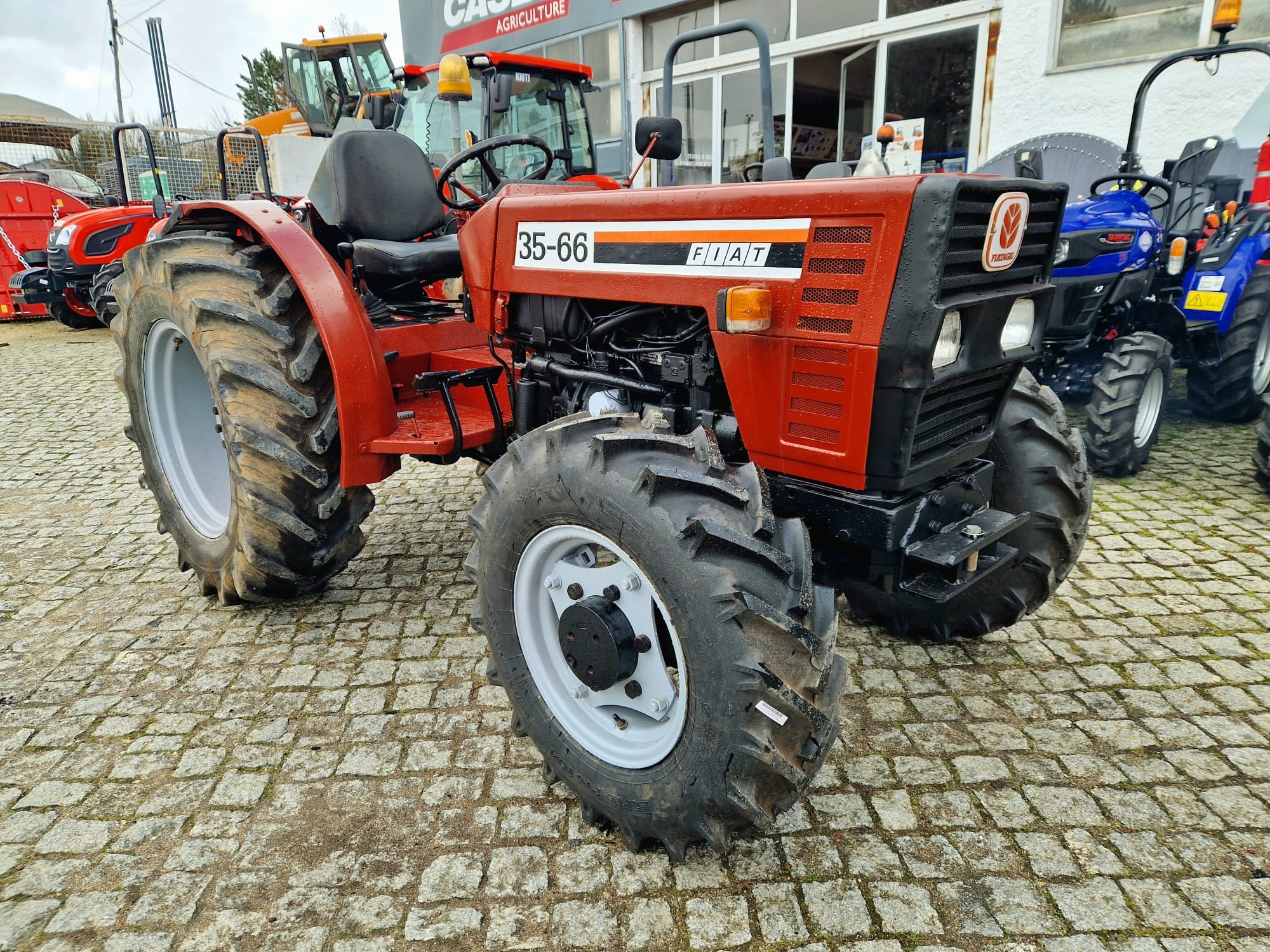

About the only compact I know that could sustain some serious loader work is probably the Fiat 35-66. Arguably one of the best compact tractors ever made.
One of the best things about this tractor is that it has planetary final drives on both front and rear axles. This axle design can handle some serious abuse.
I don't think these ever made to US though.

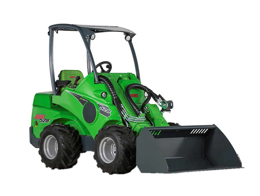

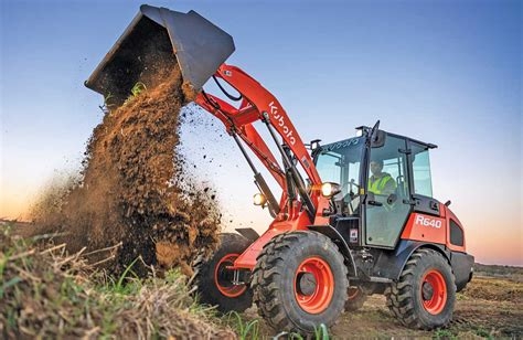

On the other hand, if the OP is looking for an heavy duty tractor just because of loader work, might as well just get a machine that was actually built to be a loader.
Those smaller articulated wheel loaders, like those Avant, Giant, MultiOne and other makes, are designed and built to be a loader. Can handle all the abuse you can put on those. Offer faster and smooth hydraulics with a lot more reach using the telescoping boom.
More expensive than a tractor? Sure but then again, it's built to be a loader.

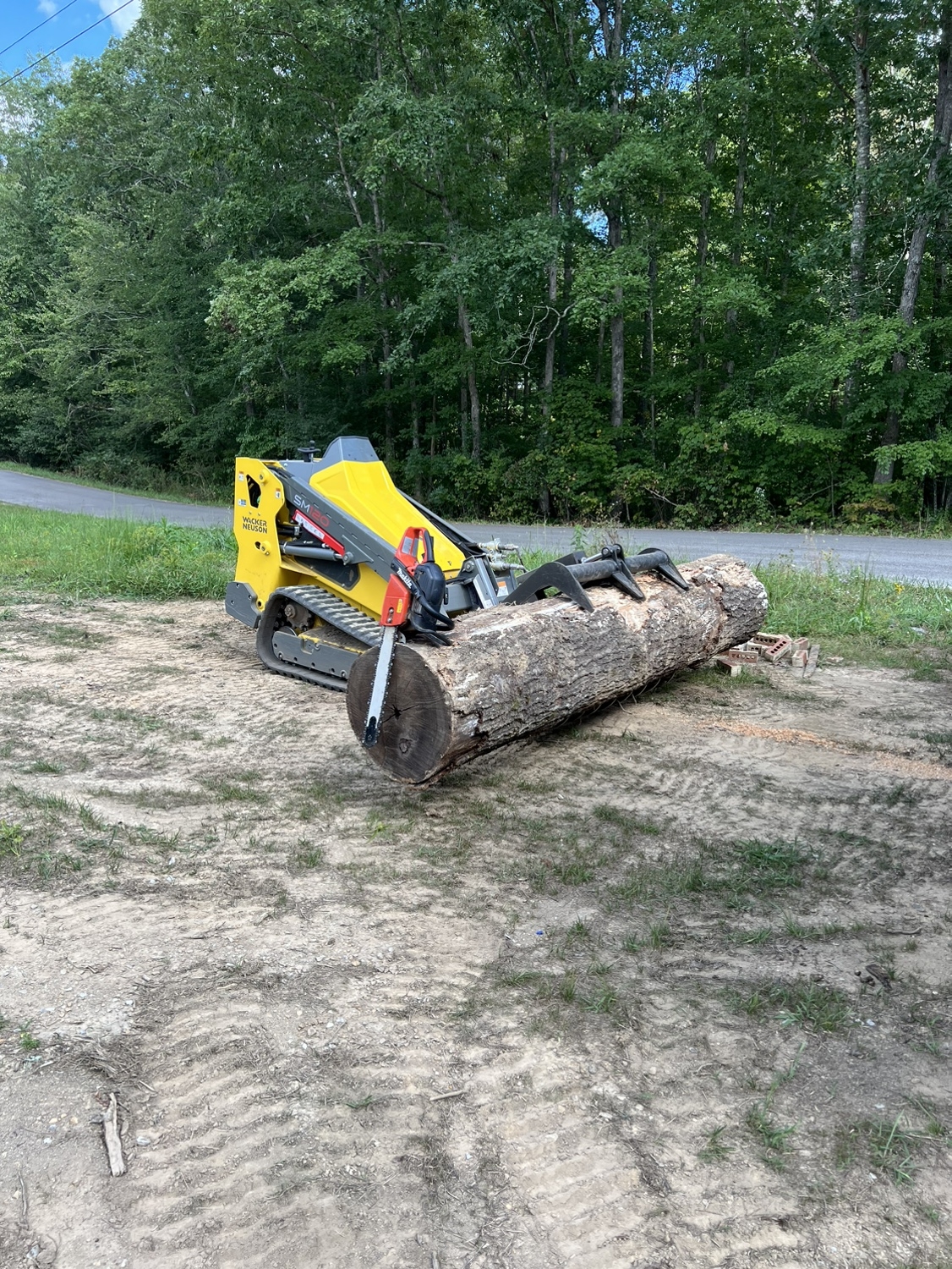

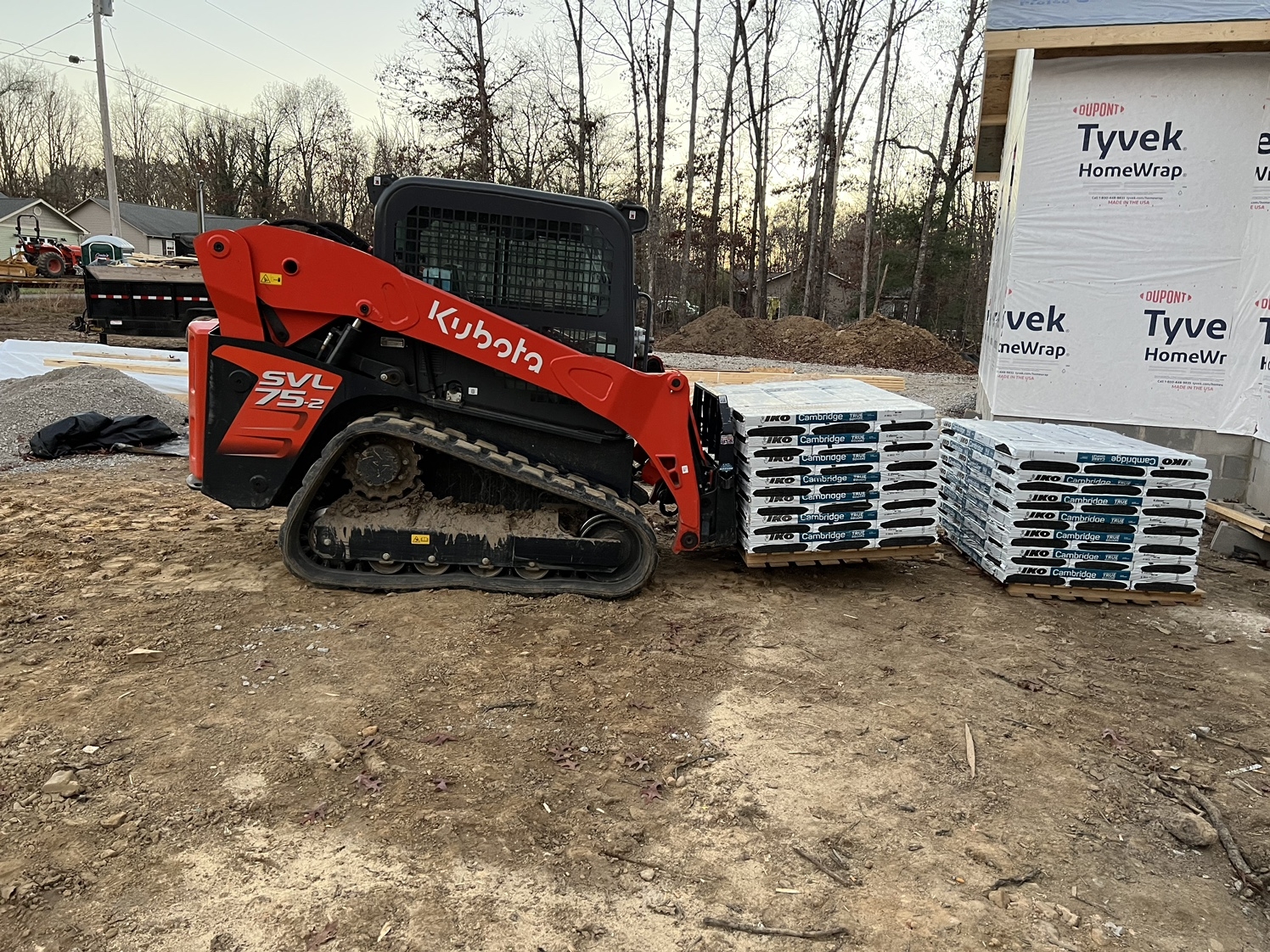

Tractors in general are pretty delicate loaders. As the name implies they are loaders not dozers. A tractor doesn’t come close to the size/lift ratio a skid steer does. This mini can set 2,000 pounds on a trailer. It would take a compact tractor at the upper end of the compact spectrum to do the same job.

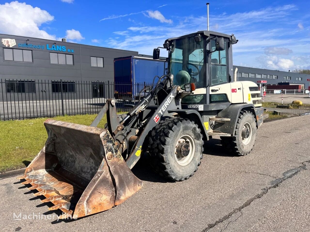

If I needed a really strong loader for not a lot of money Yeah a yellow articulated Loader or for even less possibly a Yellow TLB with weights instead of the full size backhoe. Most are good for 4500-8000lb lift to full height

Tractors in general are pretty delicate loaders. As the name implies they are loaders not dozers. A tractor doesn’t come close to the size/lift ratio a skid steer does. This mini can set 2,000 pounds on a trailer. It would take a compact tractor at the upper end of the compact spectrum to do the same job.View attachment 4028046
I think you nailed it. 👍
Without a doubt those compact stand ons are built well beyond anything with a similar footprint.
There's the little detail of no seat or tractor feel and they're probably double the cost.

You can add Bobcat to the list of the mini wheel loaders ... They can have hydraulics on the front to run stuff like a skid steer, so I imagine a stump grinder would fit ...
If you really want a HEAVY DUTY BH, you gotta think "YELLOW" as in Deere, CAT, Case etc ...as in commercial/construction type equipment, but they are not usually "compact" ... But they are built for long days, all week/month long ... And a price tag to go with the work they can accomplish.

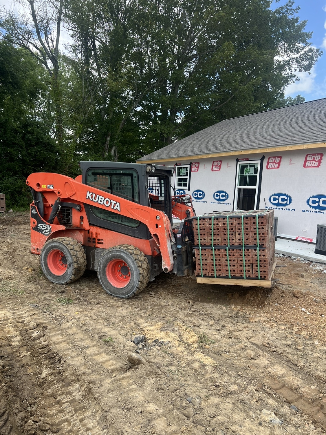

We just doubled the price again but you can have a seat with ac and lift 2 tons. The one with wheels is my neighbor’s machine. It has 3200 hours and works hard on a paving crew every day. A tractor would have been broke every way you could break a tractor if it did the same work.

I think the smaller wheel loaders would have the most stout loaders
/ Heavy Duty Compact Tractor #18
/ Heavy Duty Compact Tractor #20
Exactly what I thought of
