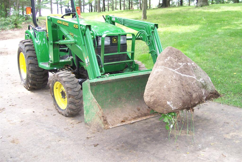

Have not dented my heavy duty one yet.. and it gets used for lots of "heavy" duty. Moved may a rock in its day, living on the terminal moraine of a glacier.
