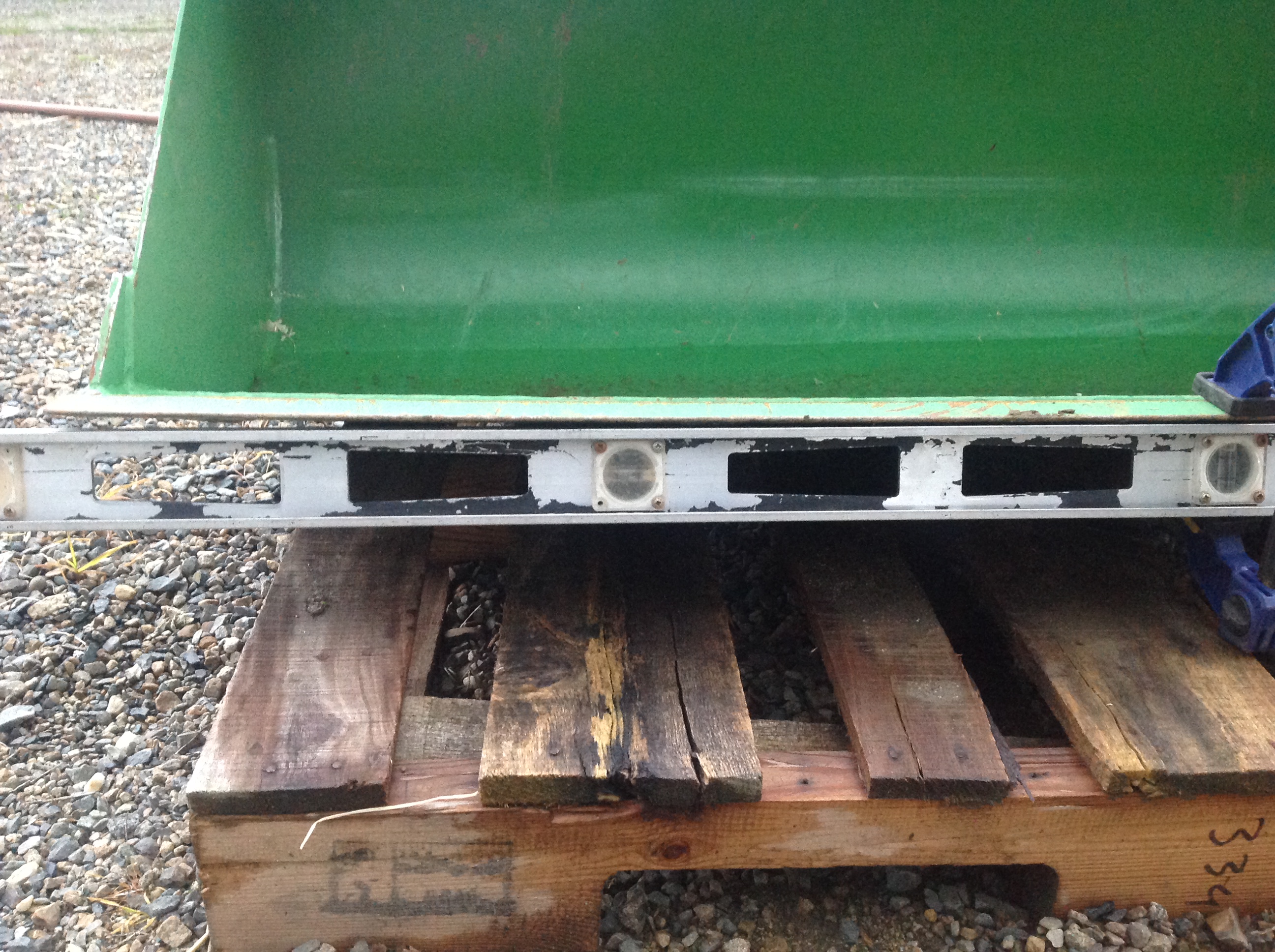

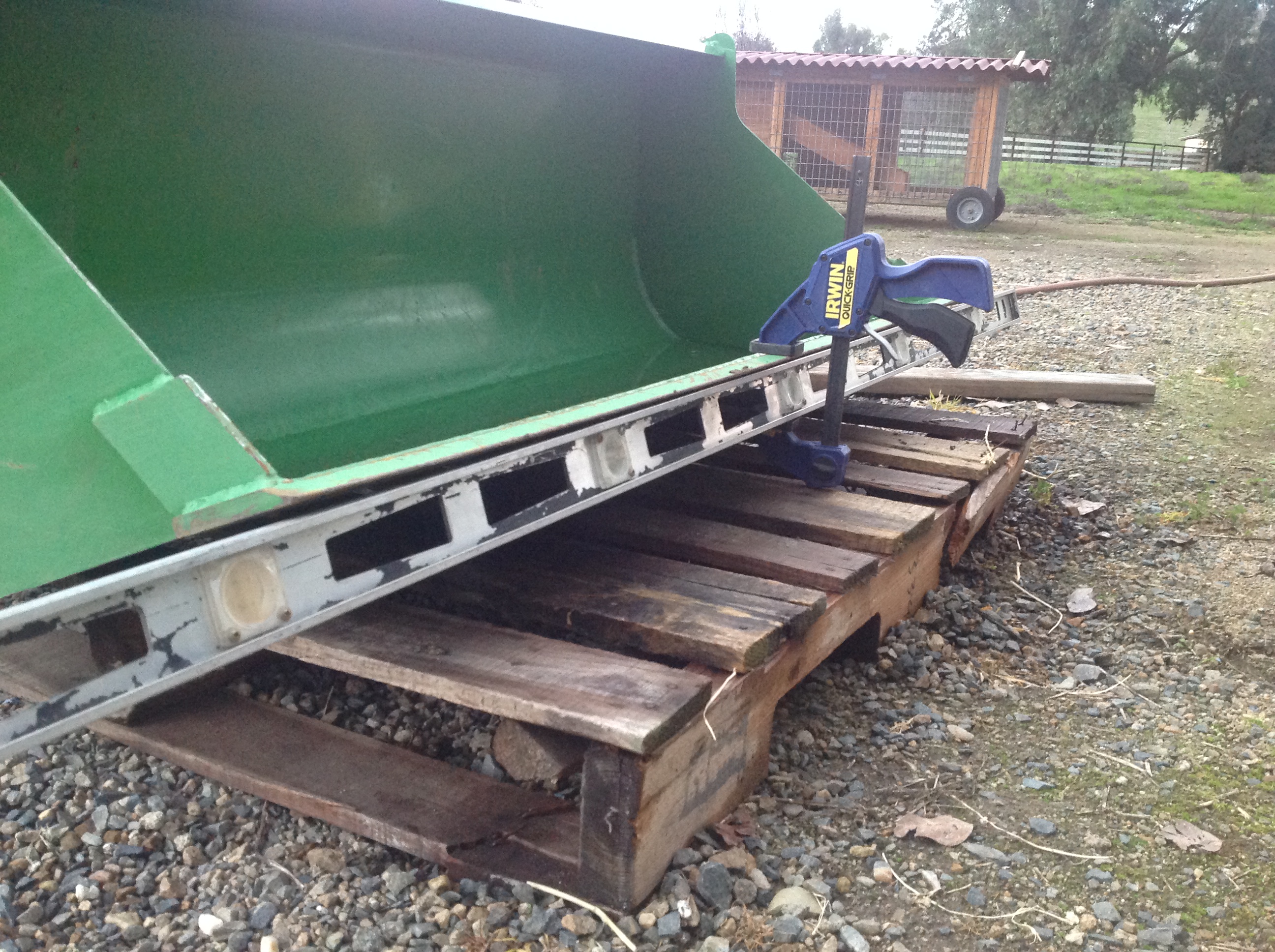

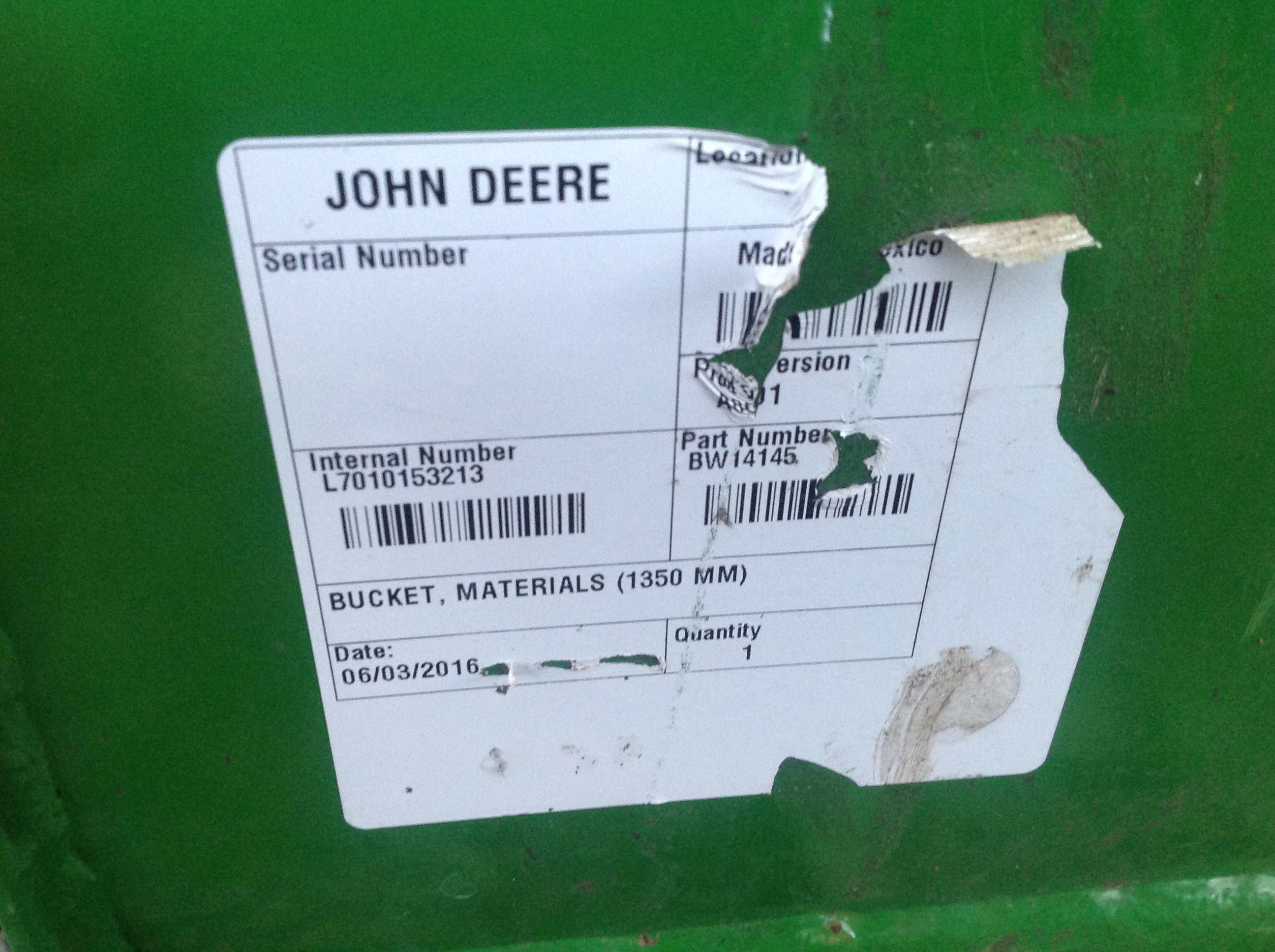

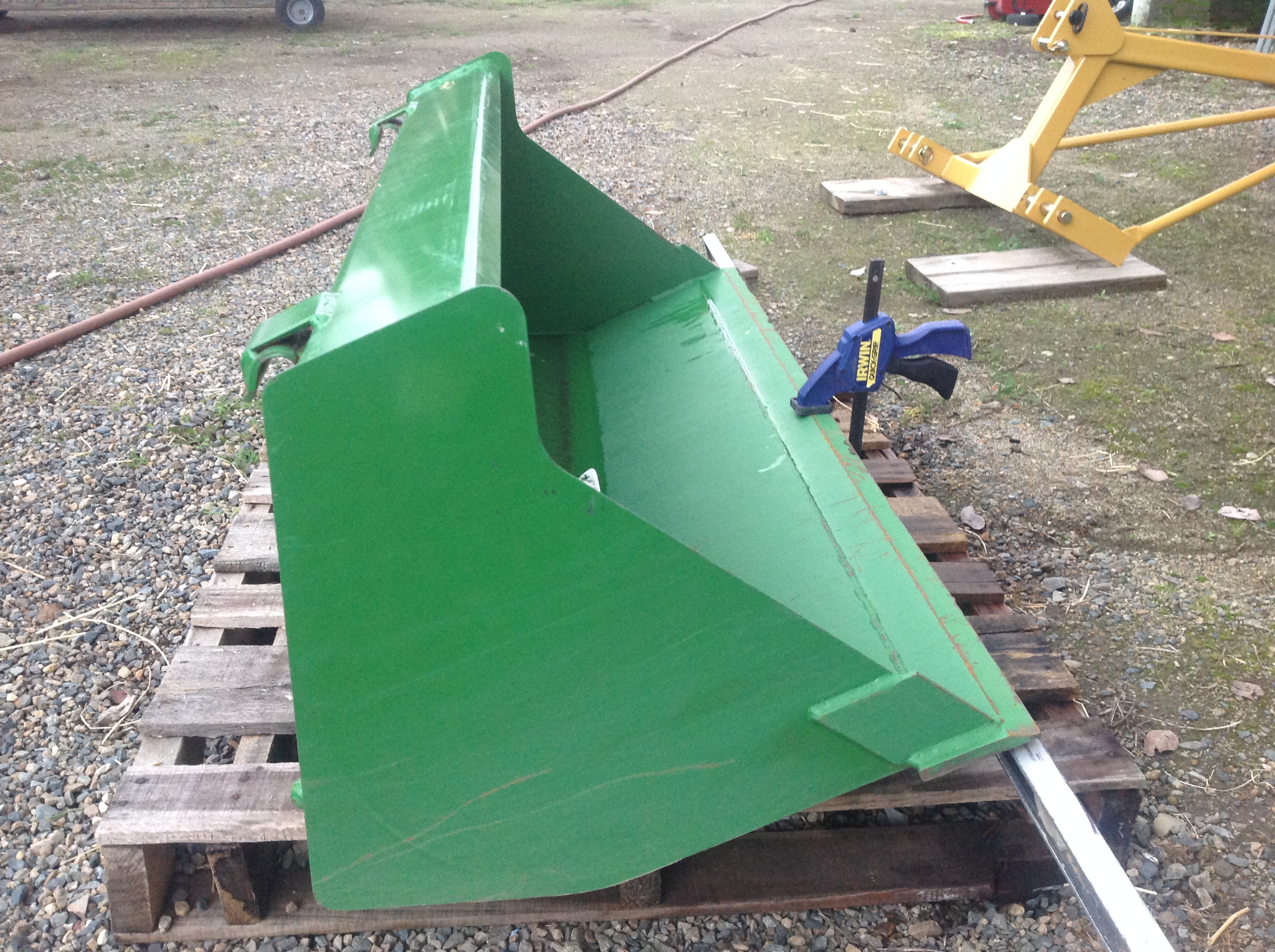

I take it that this must be the light duty bucket, I bought the tractor with 34 hour on it and I have not dug out any tree stumps. Is there a way to straighten it and reinforce it.
