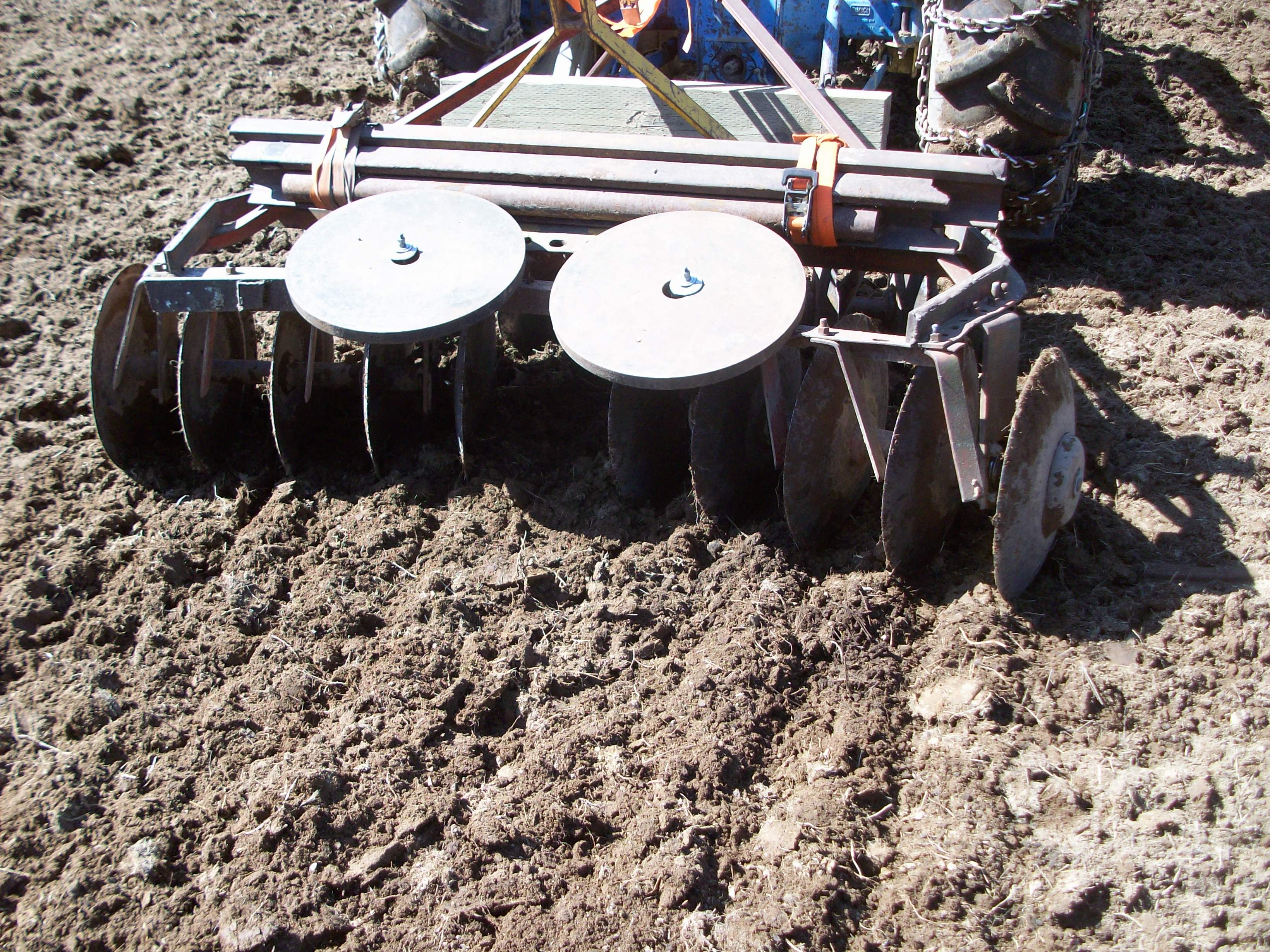

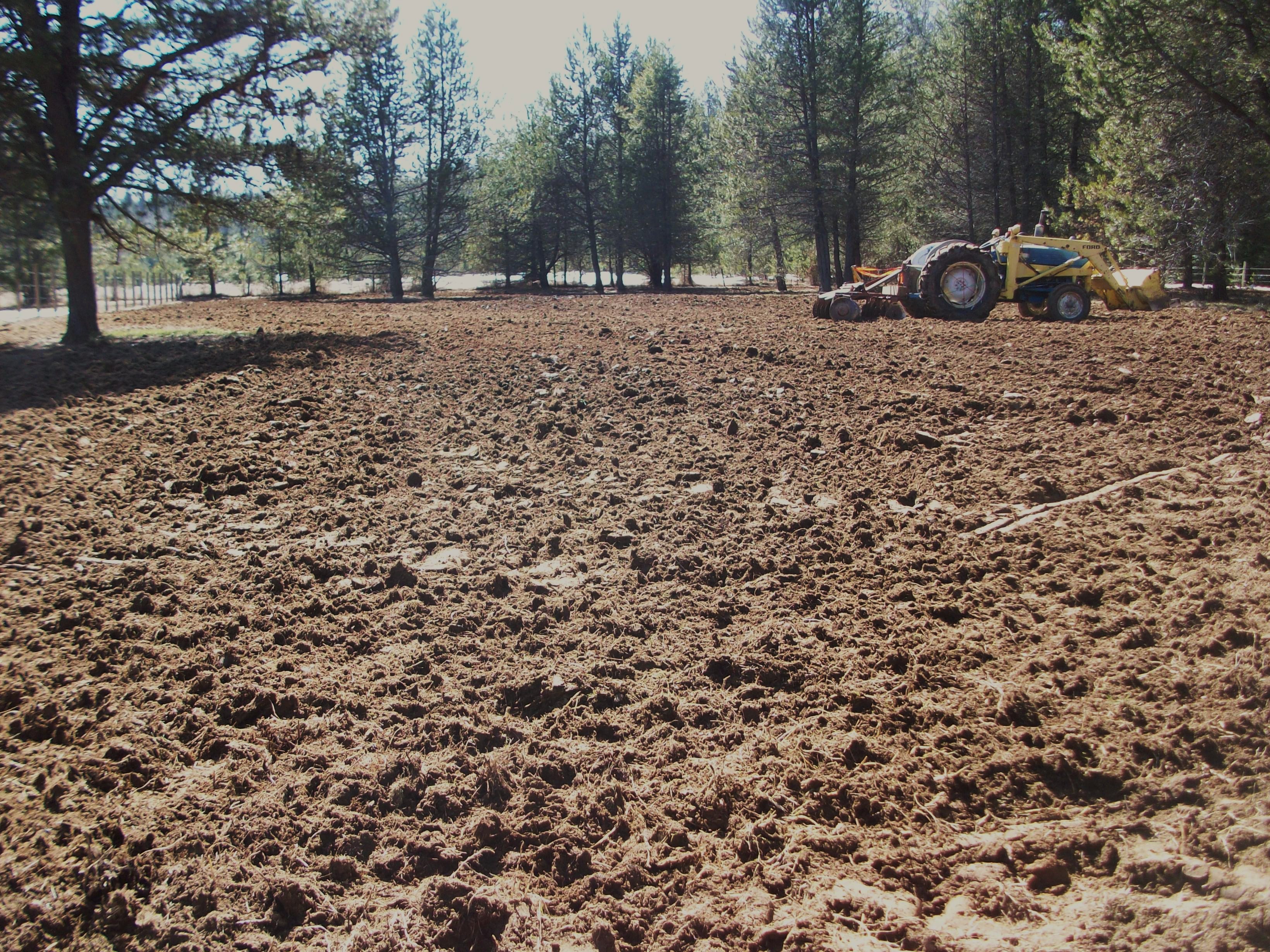

i think the lighter one should work fine. if you break the ground first with a plow.
here's a couple shots of my old cheap disc with the 3000 discing 006.JPGdiscing 008.JPG this disc is considerably lighter than the medium duty one you are considering- i would think
The trade off with a lighter disc like mine, sometimes requires loading the disc up with whatever you can.
Also since you have no front ballast It seems like the medium disc would be a better choice for keeping the front tires grounded.
