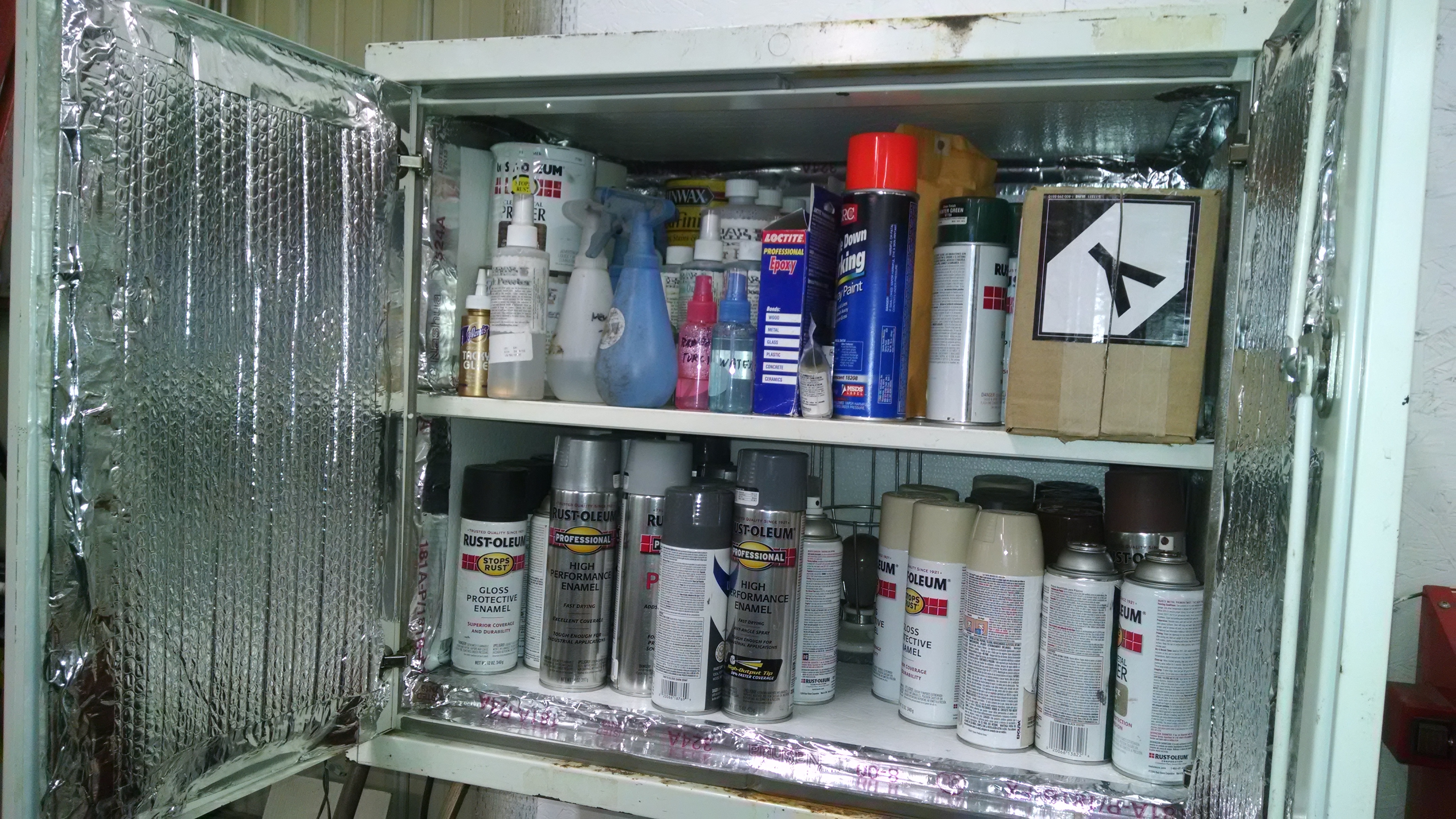

Was wondering if any has bought or built a heated storage cabinet to keep glues adhesives, tool batteries gaskets adheive etc warm in an unheated barn or garage.

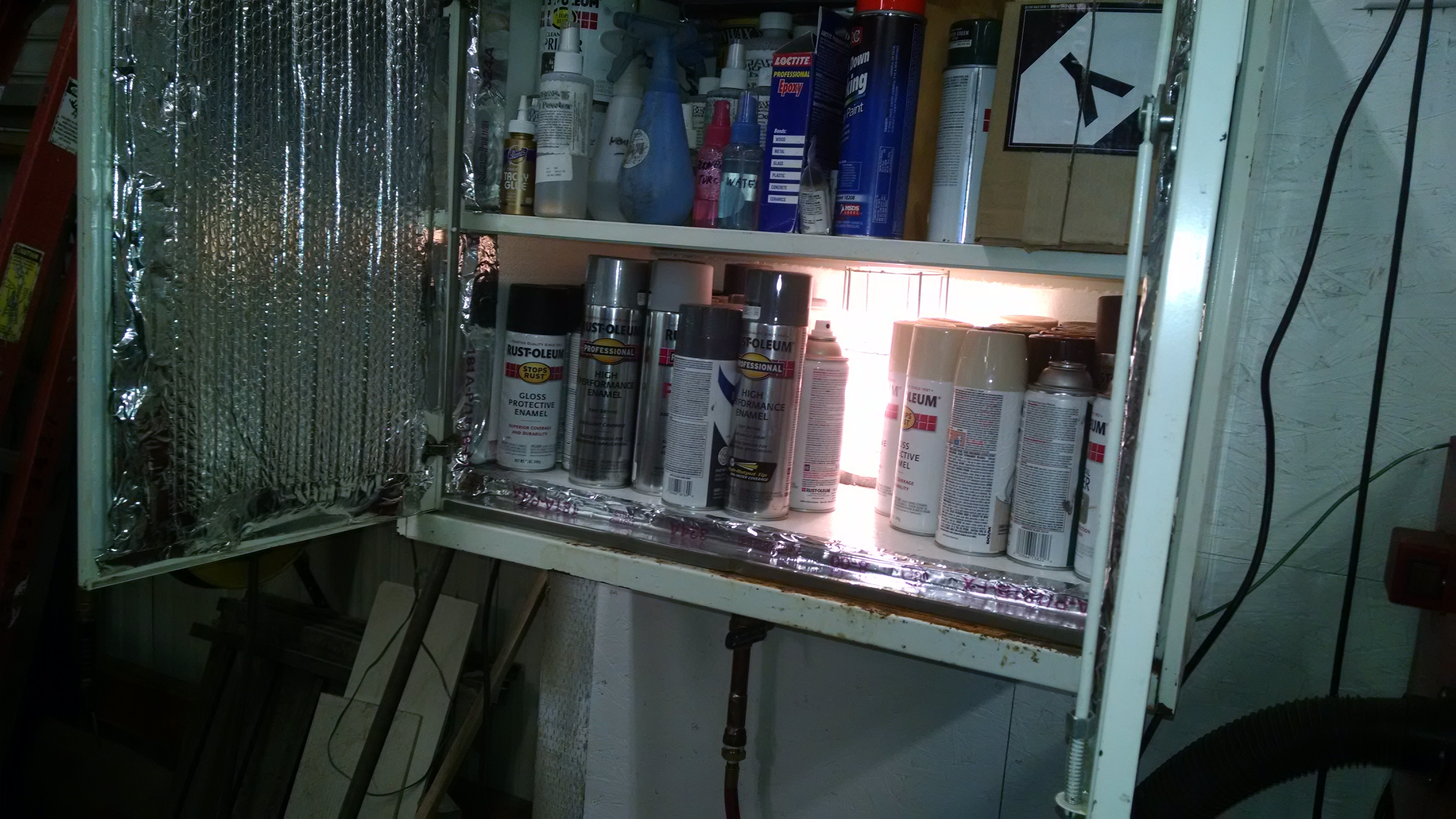

I used a old refrigerator, put a box and porcelain lamp holder mounted on the back wall all the way at the bottom, used a 40 watt bulb
Just make sure to keep anything from being too close to the bulb

I have a small cabinet with a light cage encased 60 watt incadescent lamp. Use it to prevent freezing of stuff. Cabinet is insulated. i added a thermostat that controls light bulb.

I have an IKEA cabinet with a cheap 1500 watt ceramic heater sitting on the lowest level. Paints, caulks, etc.. fill the rest of the cabinet,

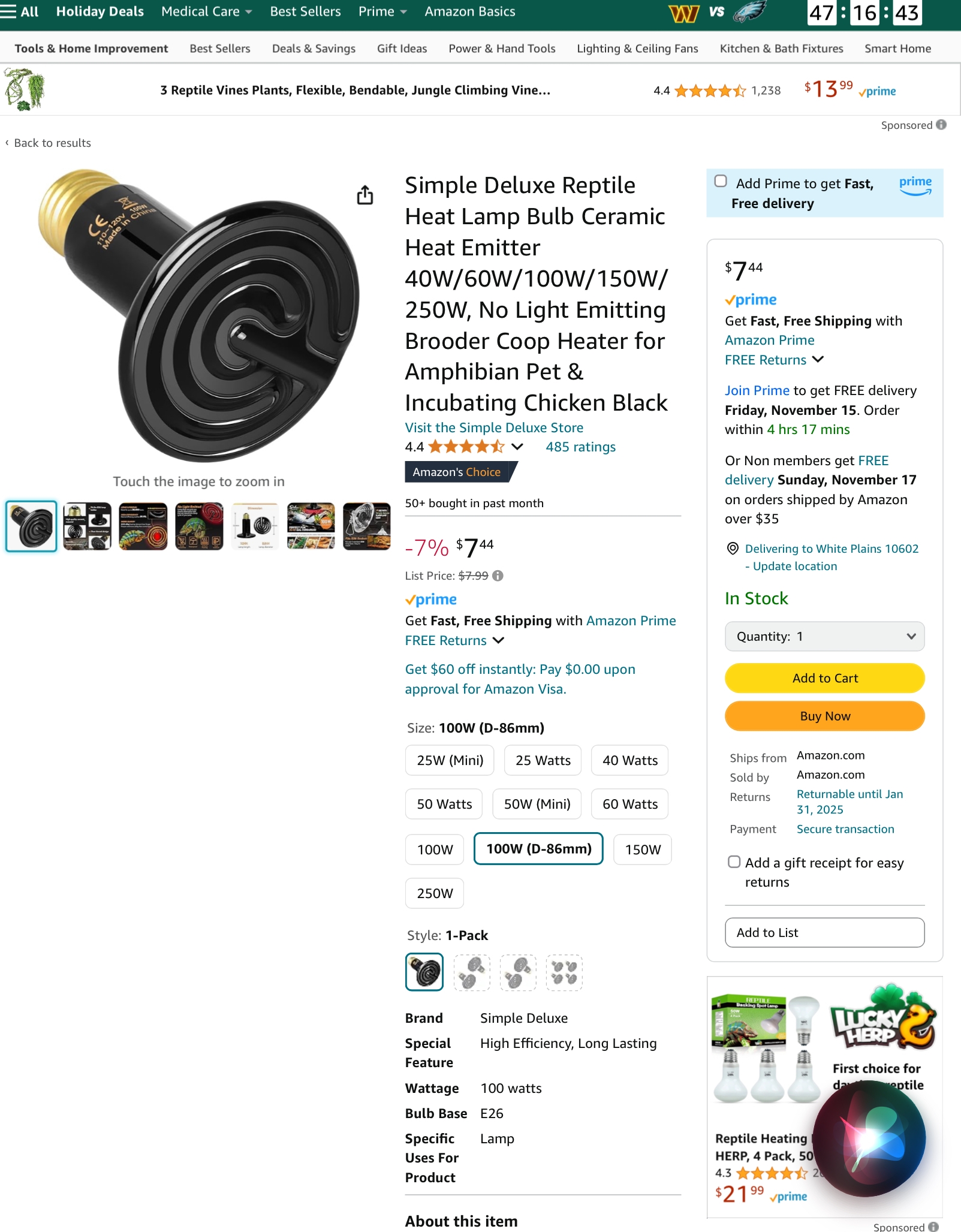

Think I’m going to go with a metal cabinet, insulate it and instead of a light bulb was going to try one of these. They’re ceramic with heating coils embedded in it.
Interesting. Sounds like something I would do in those conditions. (y)

I looked at the gun safe dehumidifier rods and almost went that route. Can get them up to 24W. Then the frugal part of me kicked in. Free incandescent bulb, $32 dehumidifier rods, $7 dollar ceramic heater. Going to try the screw in ceramic heater, if that doesn’t work I have a box of bulbs in the loft.

Lots of 40 watt appliance incandescent bulbs still available as well as heat lamp bulbs.
I use a refrigerator with a light bulb also myself.
