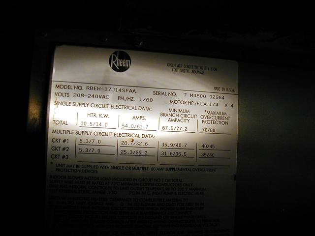

Sigarms said:
Bird, your outdoor unit is a two and half ton thirteen SEER heat pump. Keep in mind, depending on what it's "matched up" per the indoor coil/blower/air handler, ratings may differ per the manufacturer (one example would be if an expansion valve was installed or not).
Surprised that for the time (it was made on the 24th week in 1999) that someone did actually put in and spend the extra money for a 13 SEER unit.
Hmm, I remember hearing something about an expansion valve, but don't remember what it was.:rolleyes: Anyway, I thought I had a good picture of the unit in the attic, but I don't. I'll attach the picture I do have and see if the numbers are legible. At any rate, the model number is RBEH 17J14SFAA and the serial number if T M4800 02564. And it has an Aprilaire 2200 air filter system.
And that's about the size I would expect. It only has to heat and cool about 1,295 square feet.
