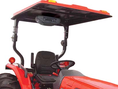

/ Hearing Protection #53
Reason I responded to this thread is attached. Saw a neighbor's kid bushhogging with one of these things (or just a garden variety boom box - too far away to tell) attached to the ROPS of his tractor. Gotta be a bit noisy, playing a boom box (advertisement cites 200 watts of amplification) just above one's head at sufficient volume to hear such over the tractor noise. Now, I don't believe the level of protection cited on the package for plugs or muffs --- if used under "real world" conditions (the original EAR stuff, widely distributed, was on subjects sitting quietly in a sound proofed booth, not sweating, talking - jaw movement can displace earplugs - and the like, over the course of a workday). Hence, the NIOSH correction factors listed in a prior post.
But, whatever one uses must be better than no hearing protection at all, plus a boom box playing above the ambient level sufficiently to satisfy a bored adolescent.
