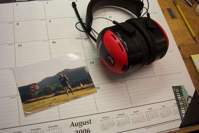

Afternoon Carl,
Those look like a good set ! When Im on the tractor runnin the bush hog I wear these, some station fade up in the mountains but not bad !;)

Howdy Scott,
What brand are those if you don't mind my asking? I have a set of the Peltor "WorkTunes" that look a bit like yours, excepting mine are yellow and black. Yours appear to be a little higher quality, at least in the picture. I'm not overly impressed with mine, but I can still hear. I'd like to find a better grade, maybe with better reception.

Hey Bill,
They are Bell and Howell, I got them through the Heartland USA catologue. If memory serves me I think they were on sale for $19.99. Up in the mountains I listen to Froggy 107.1 country ! ;)
