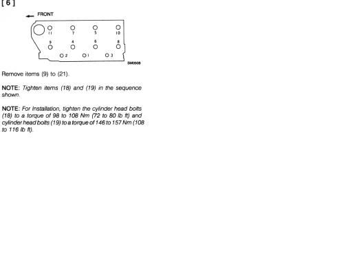

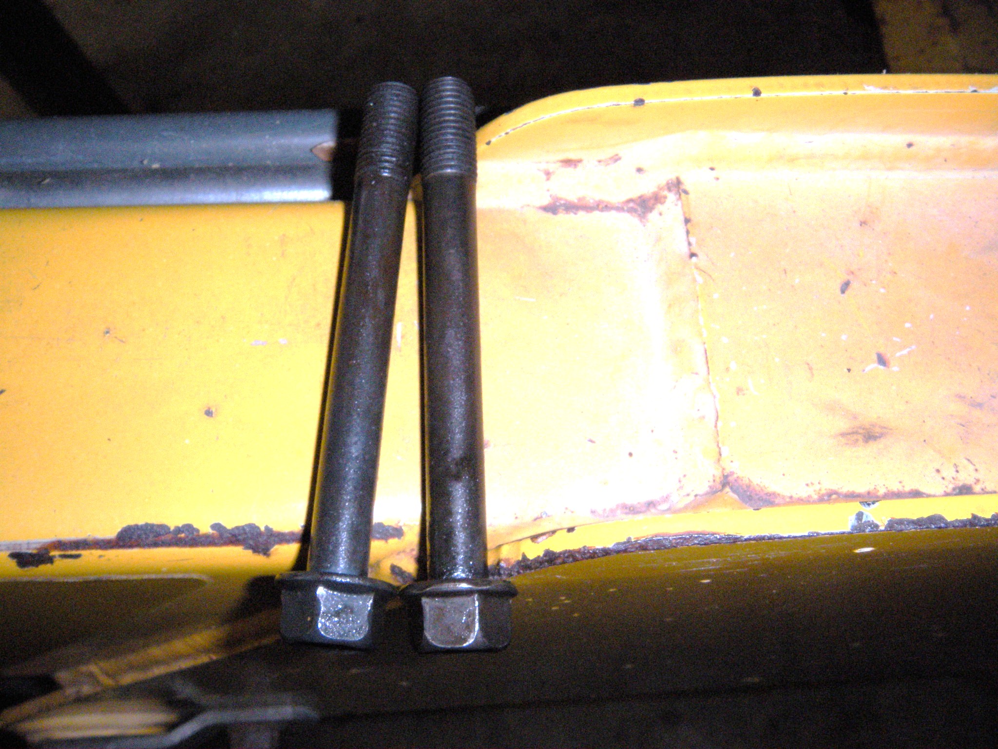

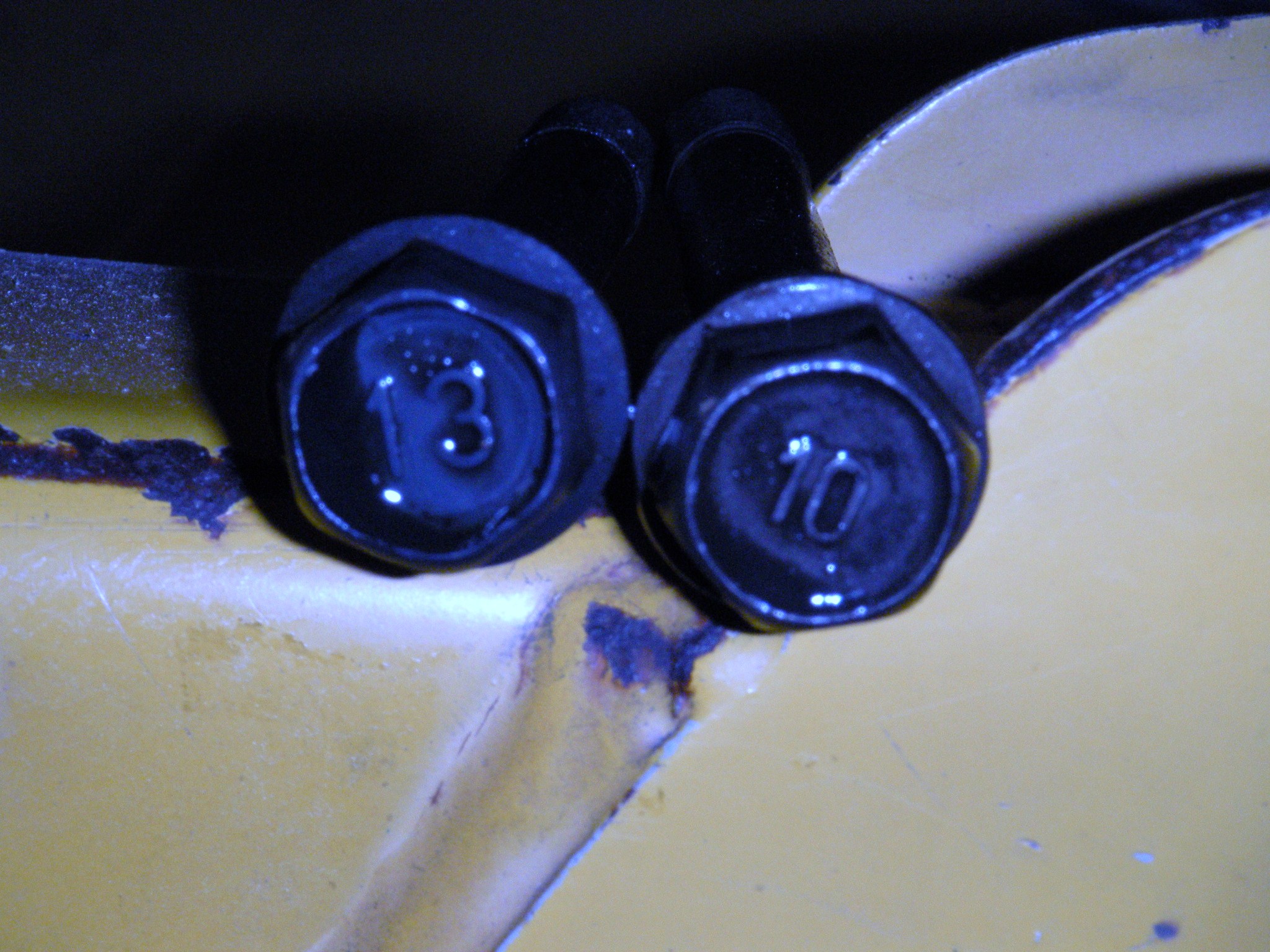

Well I went to get pictures of the bolts for Tcartwri & I checked the bolt count & now I see I was wrong on the bolt count/I'm now more unsure. There are 8 number 10's & three number 13's... eight bolts surround the actual cylinders & 3 bolts are for the do nothing edge of the head surrounding the exhaust ports on the head.. Now it looks like if the number 10 represents softer bolt, the softer bolts surround the actual cylinders...
I tried to cut & paste the cylinder head picture with the bolt pattern from the manual but it's a locked document & you can't do that...

The clamp force of the bolts is a function of torque, thread pitch and friction, not bolt strength or stiffness.
Your bolts are all M10. It's a little strange that they have different strength ratings but it doesn't matter as long as they don't break when tightening.

Ok, after a little bit of research, these bolts appear to be JIS ( Japanese Industrial Standard ) The clue is the large whole numeral on the head.
They are not Metric, nor SAE. Thread pitch and counts are different, and there is also a difference between 'JIS Metric' and older JIS hardware, which more closely resembled BS ( British Standard ). Is that confusing enough...
I cannot find a reference online for torque values, but it was an education. :confused2:
When you have the cylinder head picture on your screen, push the button on your keyboard marked "Print Screen". Then open MS Paint. After MS Paint is opened click "Edit" and then "Paste". This will save a copy of whatever is on your computer screen into the buffer and then paste it into MS Paint where you can edit and save it. You can then post the MS Paint image to TBN.
