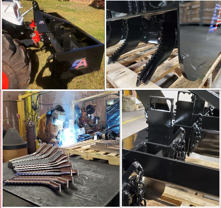

Hi All,
Looking to buy a heavy duty box blade this coming spring. Seems like there are a lot of options out there.
Looking for a true HD model for a 52 HP compact tractor. Rear tires are 66" so im looking at 72" wide on the box blade. Trying to get the best cost on a really well built unit that I can.
So far it seems that the two best on paper are either the Woods BSM or the heavier duty model from Everything Attachments.
The EA model looks nice and well designed, and is obviously we'll reviewed, but I am thinking that it has benefited from a lot of online popularity and marketing. The woods is heavier overall, and I believe is made of a heavier gauge steel.
Just looking for any guidance between these two, or any suggestions for other brands.
Don't care about brand, just want good quality for as good a price as I can get.

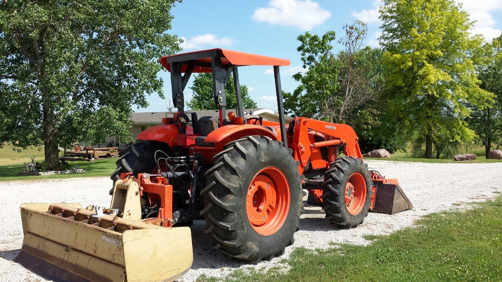

My 52 hp MX came with a Landpride 72" Gannon with hydraulic rippers. It is a very strong unit that will last the life of the tractor.
I saw the same Landpride scraper box on the Kubota MX5400 at the dealership.
