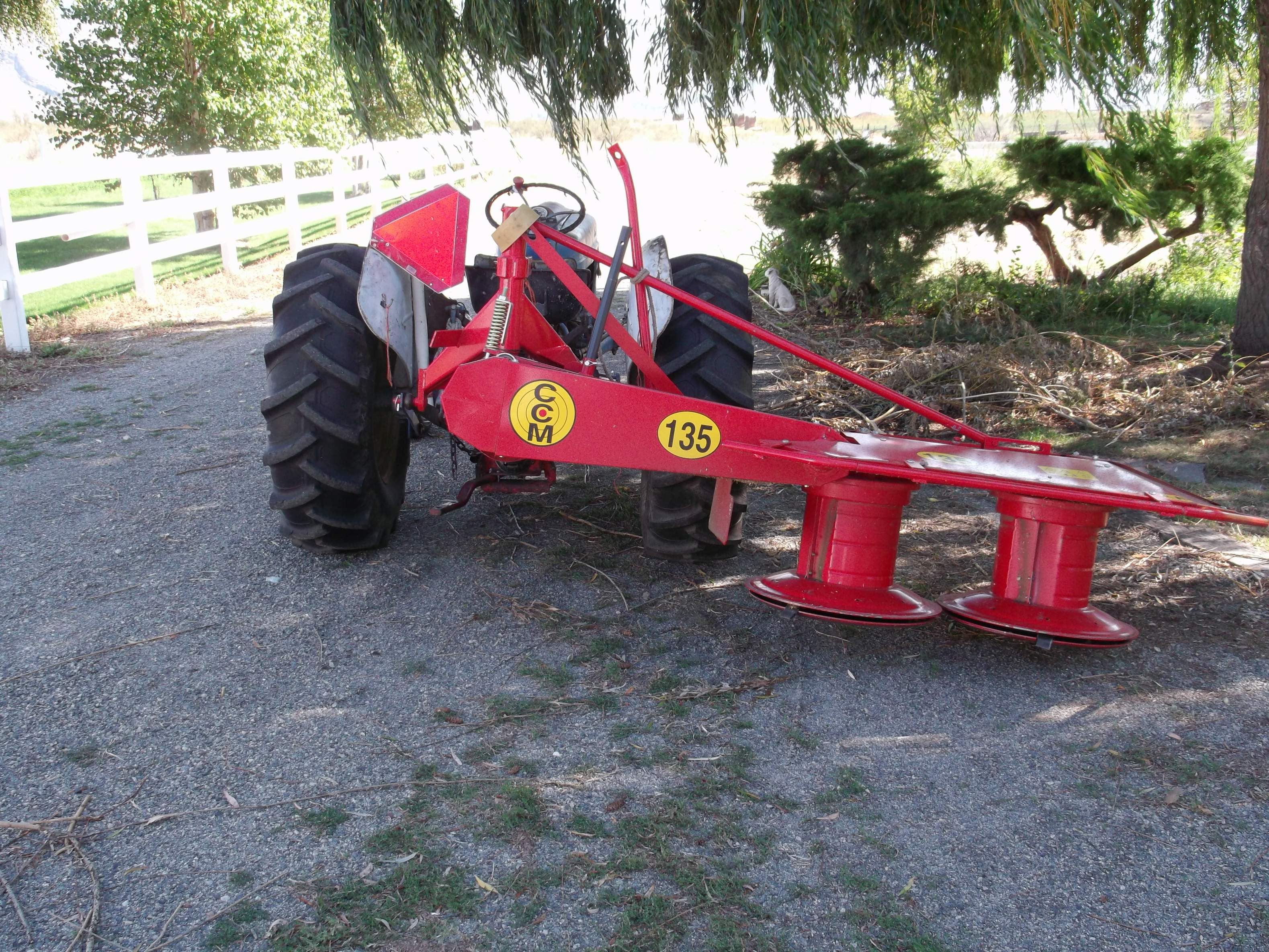

How much is your budget? You can find decent used square balers around here for 1K. Anything less and they are junk. Make sure it has been in the shed out of the elements. Get something with good parts support. My experience is limited to New Holland but Deere is good also. Rol-A-Bar New Holland rakes go for a little more in the $1500 to $2500 range around here. You can get used disc mowers in the $1500 to $2500 range but maintenance and upkeep is important. You may want to opt for a newer style drum mower but you will then you will probably need to add a Tedder. Once all of that is settled you will need a larger framed and heavier tractor. Others have mentioned a MF 135, or Ford in the 3000 range. Get live PTO and power steering if possible. On top of that you will need a wagon. If you are a one man operation figure a day to cut, a day to ted, and day to rake, and a day to bale. Then you have to stack and load.

Yes, you can hay with 26 hp if you pick the right equipment. Unless I missed it you never said how many acres you would be doing?
If the acres is small then going with all new equipment is gonna be a very costly endeavor as you will simply never recoup the cost of that new equipment haying a few acres only. Frankly you will be literally paying to hay and working for free to boot on top of that. But hay (pun intended) if you are wealthy and can afford the expensive business proposition of buying all new that will never make any money then go for it. Lots of people have expensive hobbys. If the acres is large then why try to do it with only 26 hp?
For me, I piddle on on 4.5 to 6 acres of hay each year for over a decade now. I literally got my start using a Kubota L285 (only about 23 hp at 540 PTO rpm) but I use all cheap junk equipment that was carefully selected to work with the hp I had and also for its literal scrap iron prices I paid to purchase each and every piece. In other words, I have almost no money invested in purchasing the equipment but do have some sweat equity in keeping the ole junk workable. I enjoy tinkering with old antiques but this sort of thing is not for everyone as most of my stuff is 50 to 60 years old. I am not really making any money on my adventure either as what little money I do usually make I end up buying another hobby piece of antique iron. Regardless, I certainly am not pulling money out of my household budget or my retirement investments for the privilige of making hay. In other words, I make the hobby pay for itself (and yet I still work for free).
