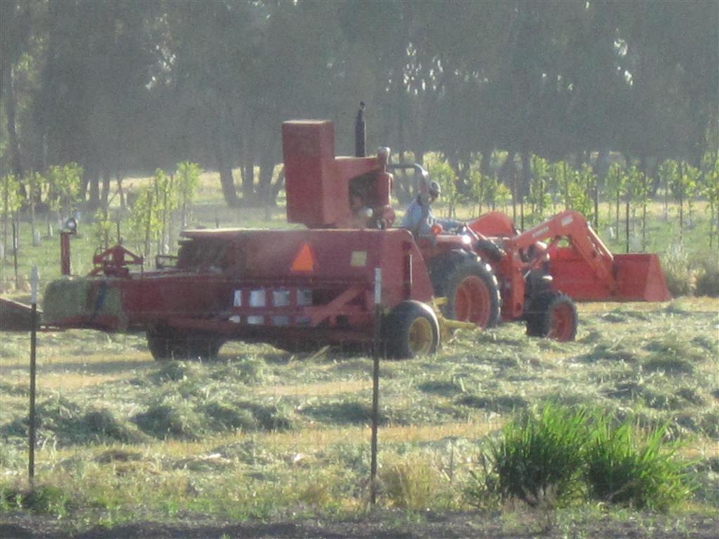

My neighbor has an NH three-twine baler with on-board engine that he tows around his hayfield with his Kubota L4630. It's a nice rig, like yours.
