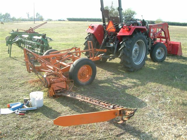

Here's a video of me out there cutting it. I was using a 6ft Massey Ferguson #32 Sickle bar mower, with new serrated blades of course. :)
The biggest issue I see is that you are missing the divider which goes on the very end of the blade (part of the shoe), which rolls the material back and provides a clean area between the "rows". Without the divider (especially in thick grass), you are not getting a clean path for your gear box shoe to ride on during the next pass/round. Thick material will tend to bunch up underneath the gearbox shoe and cause a drag.
Most of the dividers on the older mowers were made of wood. You can probably fab one from a hoe handle fairly easy. I agree that a more speed would help, but I would add a divider first.

I will definitely look at getting a swathboard put on. I did have some clogging issues in the thicker grass. Thanks for the suggestions guys i appreciate it.
