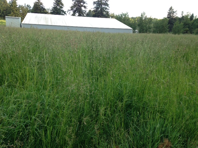

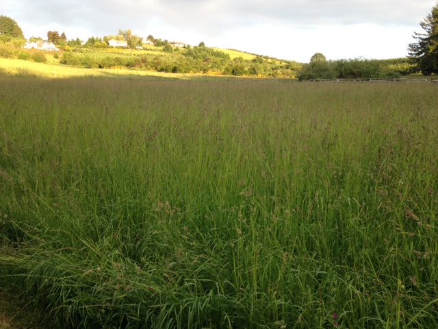

What kind of yield(50 pound small square bales) can I expect per acre with grass like this? There's quite a bit of orchard-grass and I believe fescue in it. It ranges from 4 to 5 feet tall. I fertilized with 16-16-16 at the rate of 200 pounds per acre back in March. I'll attach pics. Thank you very much for the replies guys I really appreciate it.

At 4'-5' tall a lot more sq bales per acre than this old man care's to haul. I'll guess 80 per acre.
