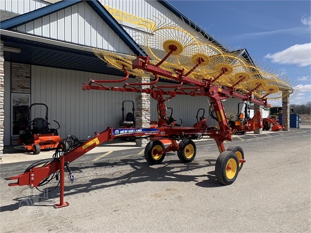

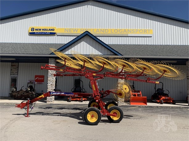

Here’s the rake I’m considering. One of my better dealers has 2 coming. Looked at Pequea too, but their transport width is too wide. I like the 15” tall double bogies on my rough ground and the walking beam axles, too.
Gonna be funny not having a PTO shaft!
/ Haying changes next year ? #15
I know technology on wheel rakes that fold into the air similar to your photo have advanced a long way in the last 20 yrs BUT I'll still chose my H&S bi-fold rake over that style. With my rake I can rake any width of hay from 6' to 28' by just moving tractor scv control lever. I can change windrow width without altering raking width by simply turning a crank. My rakes wheels push hay with no frame or wheel spindles blocking hay flow vs rake wheels pulling hay instead of pushing hay with wheel spindles readily accessible for wrapping. I've seen windrow width variances with worn fold in the air rakes that I've never experienced with my 20 yr old very experienced(many 100's of acres) Bi-fold rake
I feel confident Bi-fold rake is much higher $$$$ than fold in the air rakes but IMHO worth the extra $$$$.

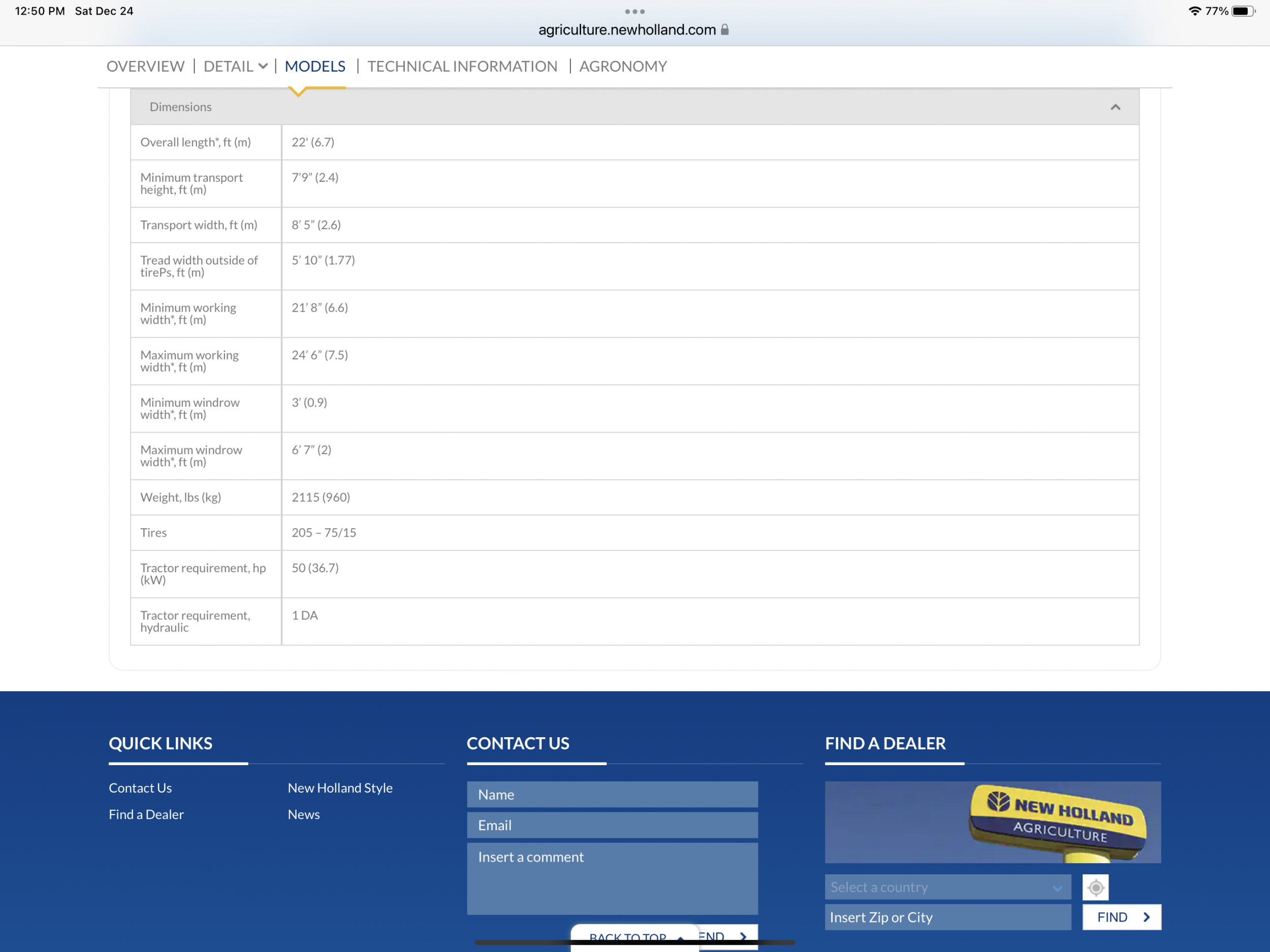

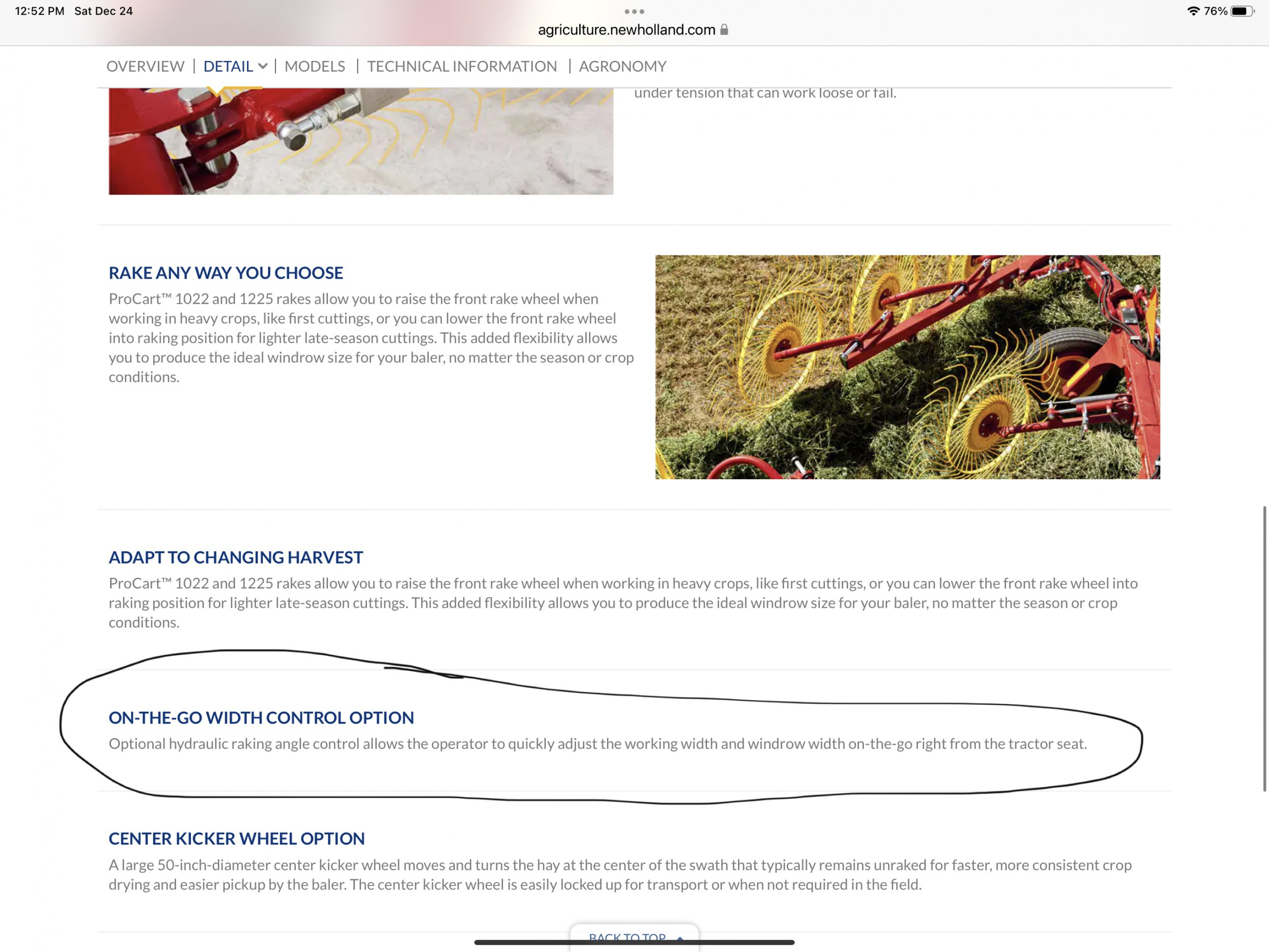

The wheel rake I am looking at has hydraulic width control, so some adjustability is available.
Does changing windrow width alter raking width? It does on older fold in the air rakes but I have no idea on rake in your photo. How many feet can one alter raking width?
I inspected rake brochure & now see one can raise 1 front rake wheel on each side to lessen raking width. I didn't see how to hydraulically change windrow width.
I've discovered on my bi-fold rake if I encounter tougher raking conditions changing angle of sides by narrowing raking width increases rake wheels ability to gather hay.
There’s a hydraulic adjustment or so the salesman tells me.
I will find out soon.

Yes, changing the windrow width on that rake does change the raking width. There is a pair of hydraulic cylinders just behind the lift arm that changes the wing angle to narrow or widen the windrow, and they move the other end of the wing in the opposite direction due to how the wings pivot on the lift arm, and you do this with the rake moving if it has the hydraulics on it (the one below does, I can see them.) The raking width can change by several feet, and depending on your mower and swath widths, it may be no big deal or you may miss hay or catch part of your previously-raked windrow.
