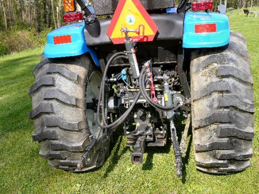

Here's another idea that may work for you. If you add a receiver tube to your draw-bar you can slide any attachment into it that you like. And unlike a 3-point mounted hitch it won't ride up and down when you don't want it to.
