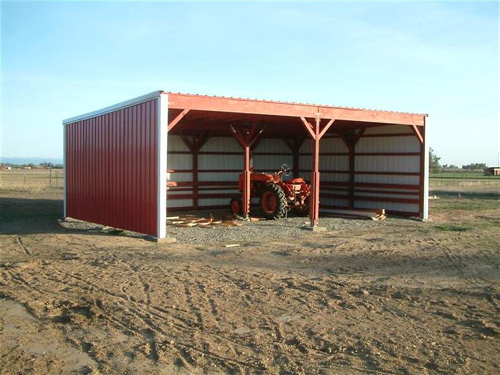

I don't see why you're agonizing over hay storage. It's simple. Here's a shed I built myself: 20 x 28 ft, 11 ft height in front, 10 ft height in rear, 28 ga metal sides and roof. Total material cost: $3600. Simple design. Easy to build.
Good luck
