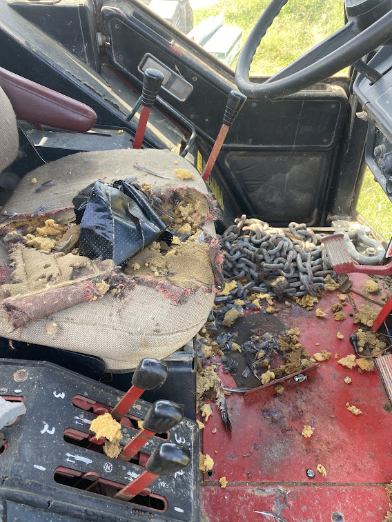

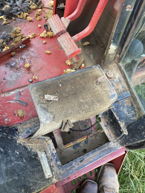

What happened to the cab interior?
Sorry to hear about the truck. You have been having a terrible year, the weather, the equipment issues. I know its easy to say but don't let it get you down. I hope things get better for you!
/ Hay Making on a Different Scale
#343
Raccoon came up through the battery access door during the winter.

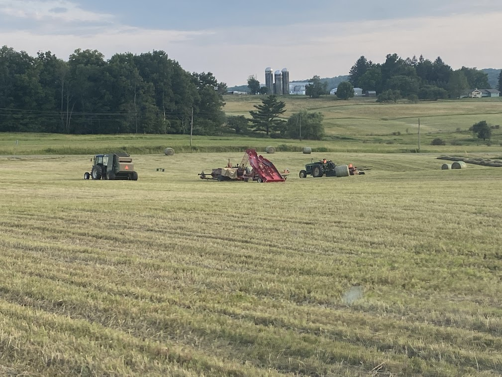

50 acres done. Only 120 more for dry plus all the baleage we have yet to do. Round baler is now down indefinitely. Neighbor baled up my rounds with his Krone. 172 4x4 round bales and 1222 small squares. Today is load out for rounds.

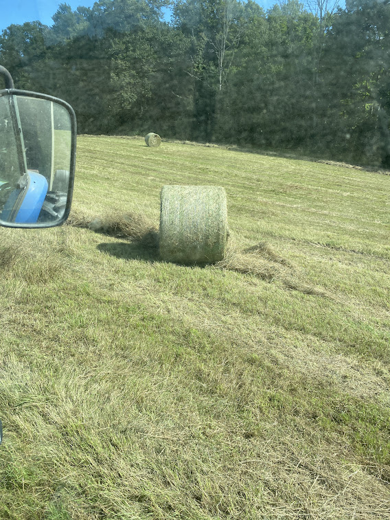

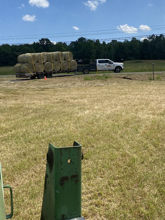

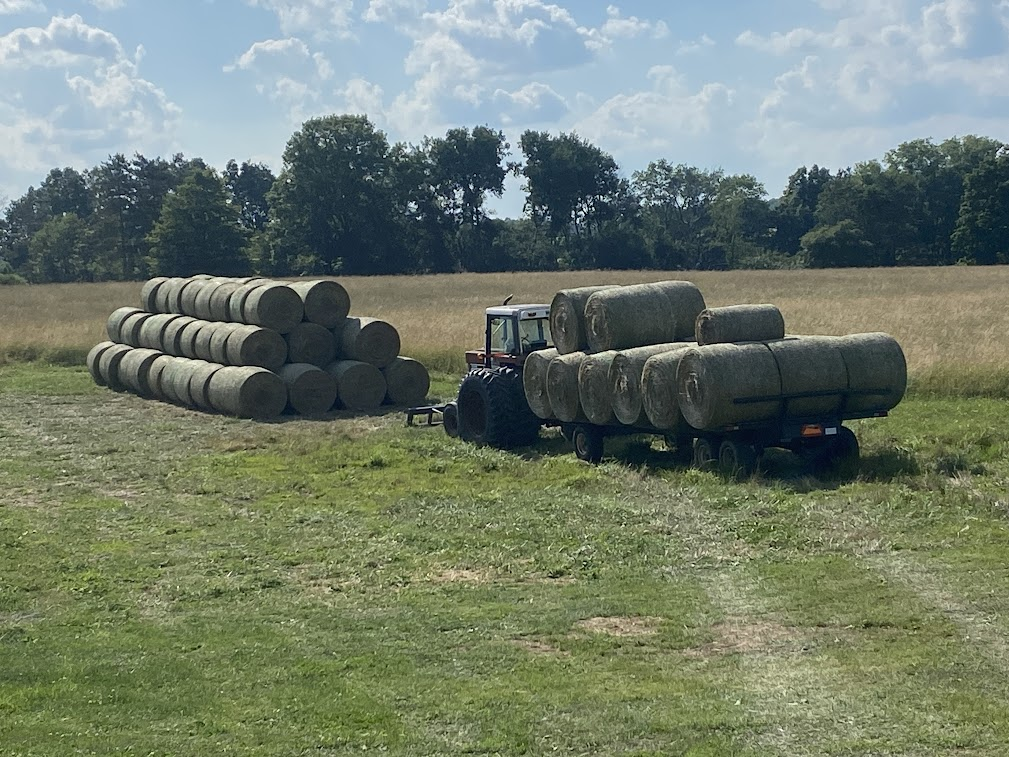

Interesting you load 'eye to the sky' not something I do, I always load 'eye to the side' on my customer's flat bed trailers. If I store them in the barn however, it's always 'eye to the sky' simply because I can stack them better and they keep their round shape and don't get oval from rounds on top of them.
I presume you are rolling 5 x 5's and not 4 x 5's. Only reason why I can see loading like that or you have a bale grapper...
Rained here again, almost all day. Strange weather this year. Very hot and humid and rain almost every day. Reminds me of Georgia, not Southeastern Michigan.
#356
4x4's and their method of hauling. This customer is one of our best ones. Almost 300 rounds. Yes have a grapple but to slow. Bale spear.
