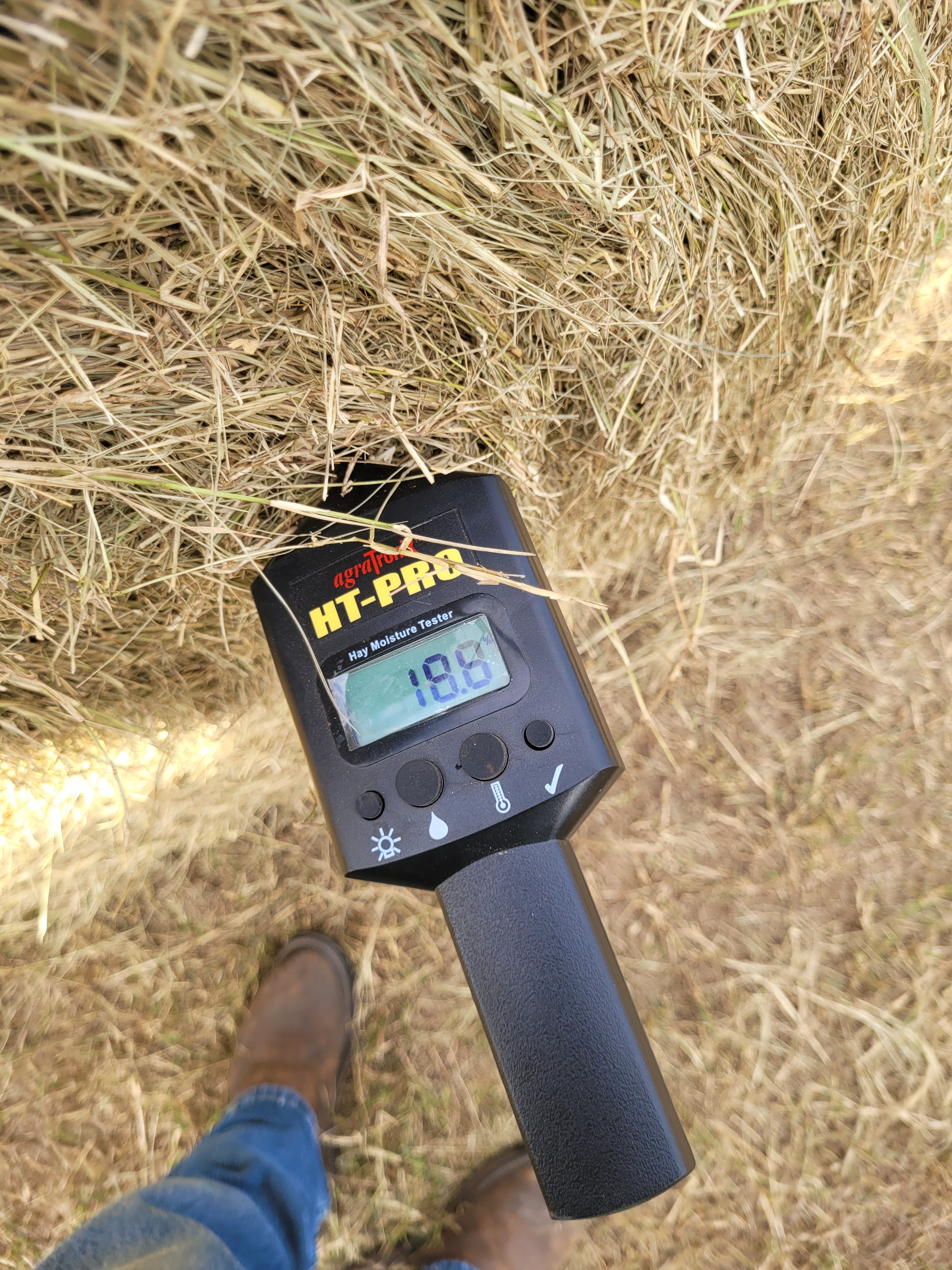

18.8 wouldn’t sell up here for feed hay.
Me? I think it’s BS, I feed 18.8 all day long. Might be a little dusty for horses, but for beef it’s fine
I just delivered these and the buyer wants every bale probed.

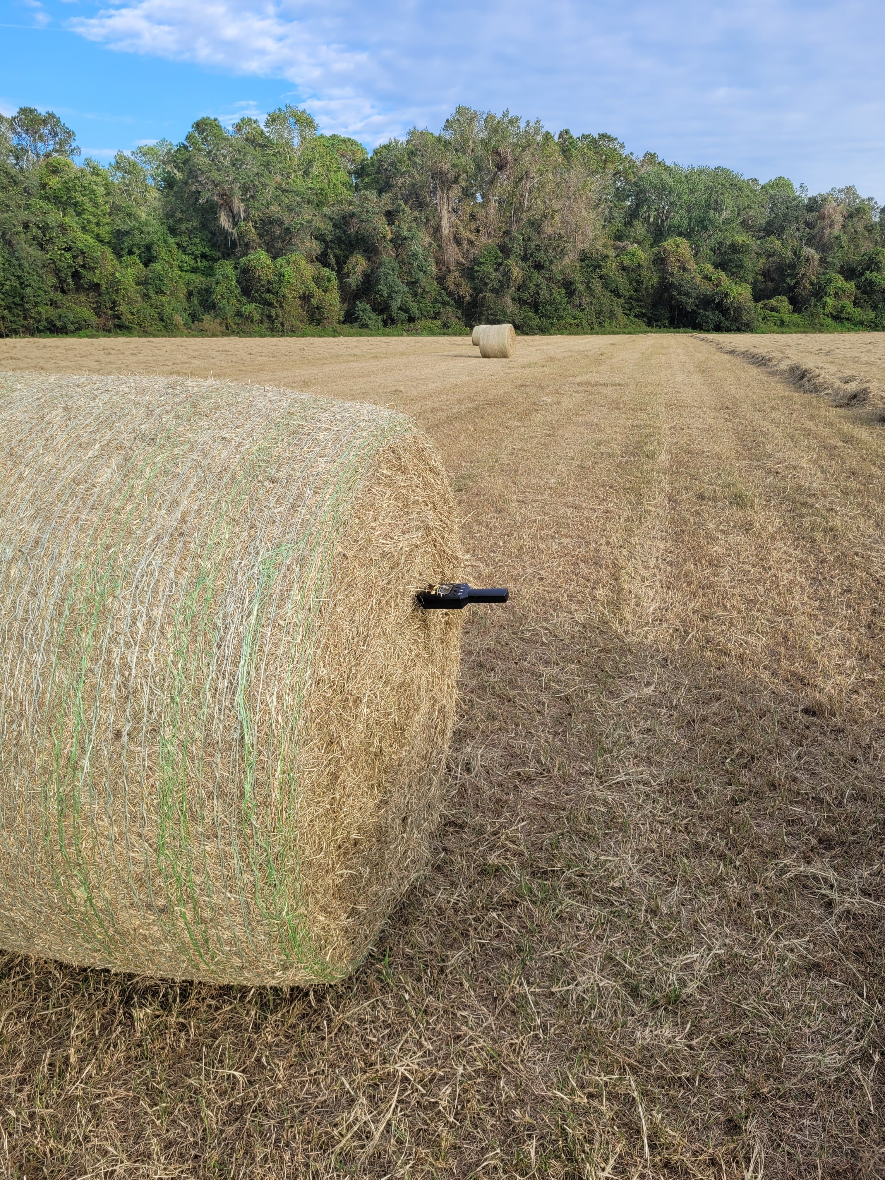

My experience from utilizing a hand held moisture tester for over 30 yrs is if round bales are probed on rounded part of bale vs flat side of bale one will see significantly higher moisture %
Your right I didn't catch that. When I have probed rounds I do as you described and it is a ^%$# sometimes to get the probe in. I would bet those are easily 5 points higher now

Large square bales have similar readings.
Probe the twine sides and readings are higher than sides without twine.
When I deliver a load of bales I get a kick out of watching the little gal try to get a probe in my bales with the twine side out
