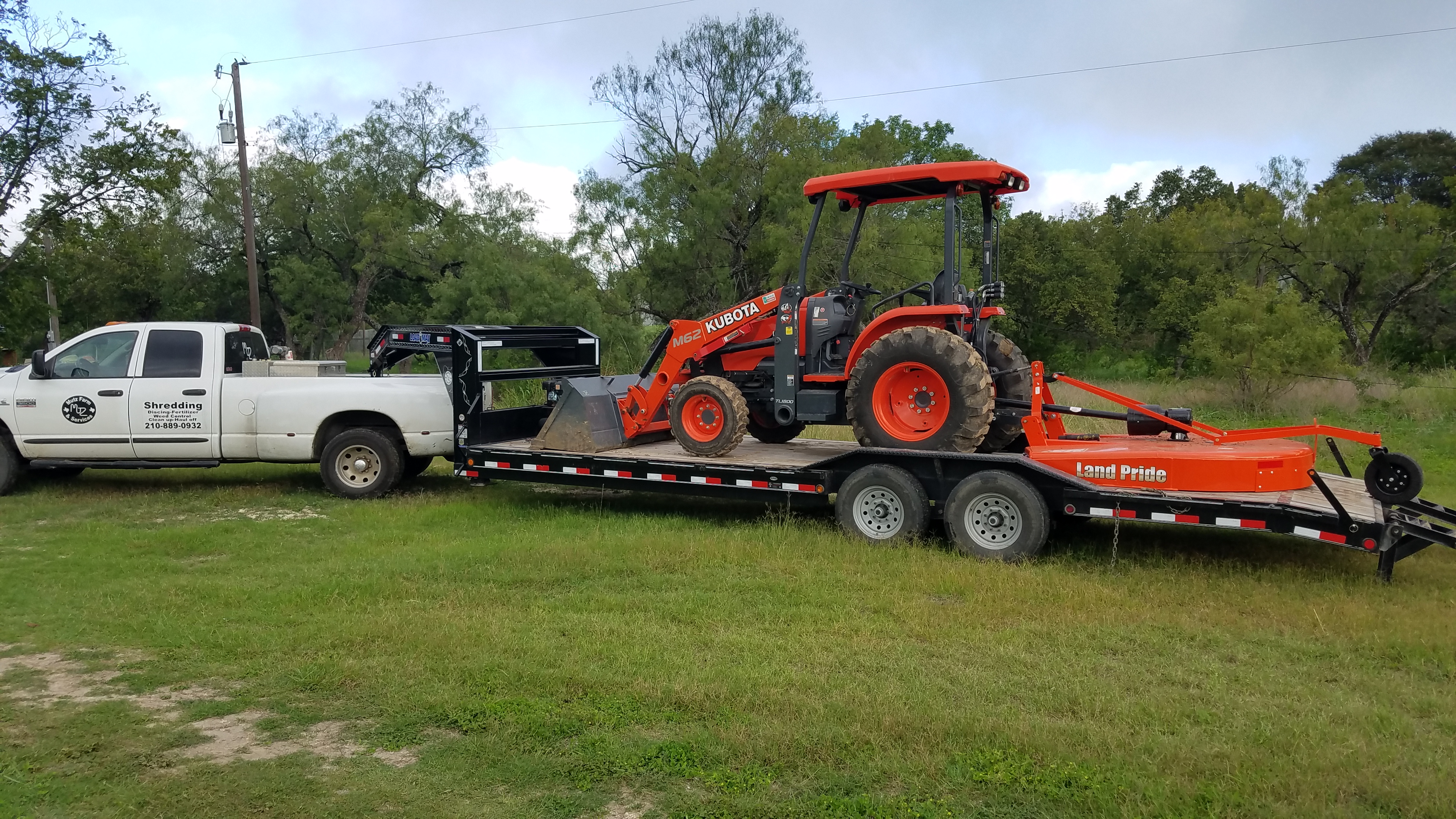

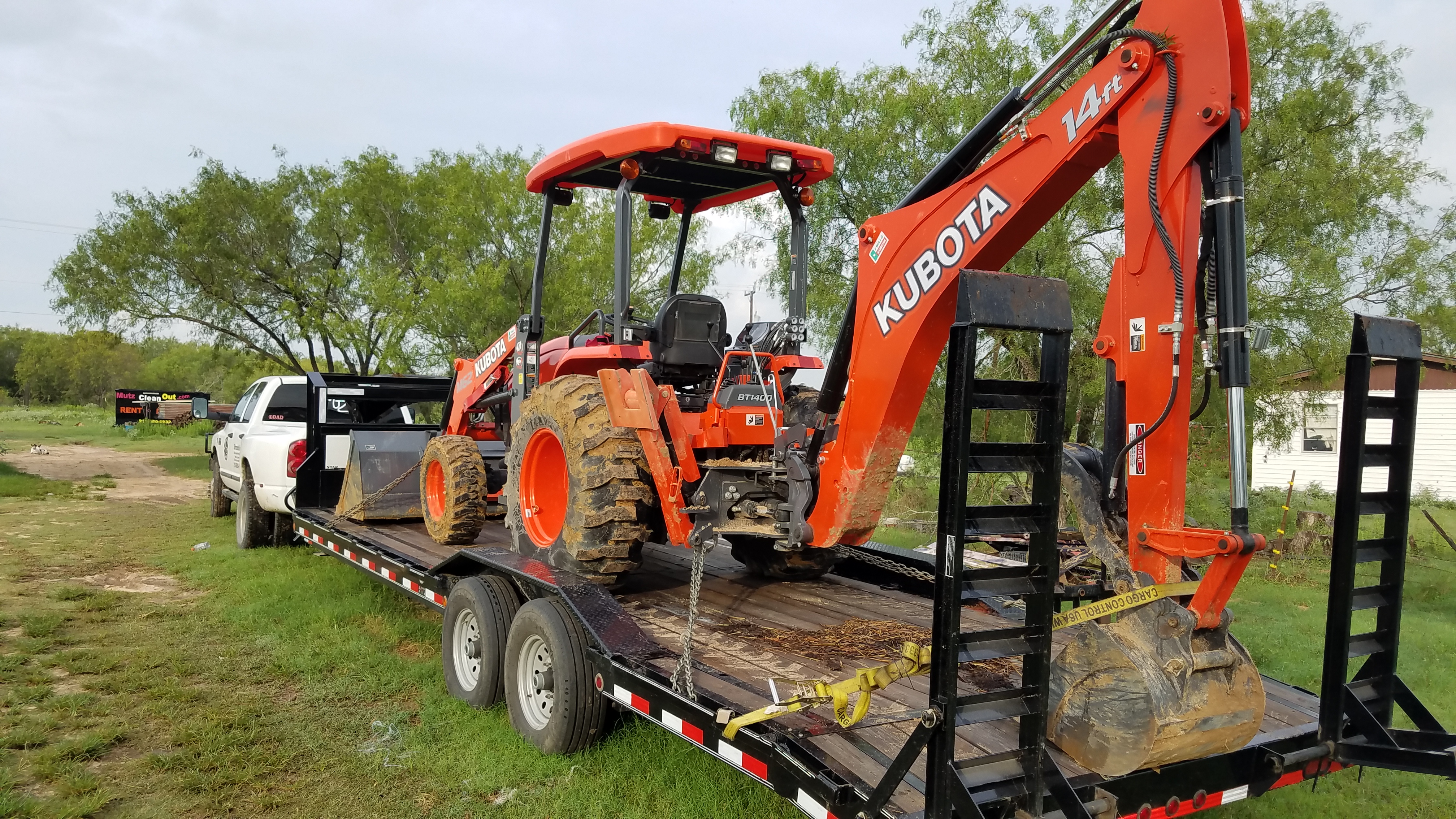

MutzFarm, I'm interested in what trailer you use to transport your M62. I'm lookin for a good solid heavy duty gooseneck to transport my M7060, but quite honestly I might run out of truck, as I only have an '02 Ram 2500, 5.9 Cummins quad cab long bed. I'd be pushin it.
I think you will be ok as long as it is every once in a while, but weekly or daily yea you might be in a bind. My trailer is a Load Maxx or Load Trail as they have merged. It is surprisingly solid. At least in front of the axles. Behind it is solid but flexes a little more. There is a little less steel back there. I went from a 20ft C and M with rails, two 7k axles (14k gross) and slide in ramps to this one and it was like climbing in a Cadillac that had a couple military tank features. This one is 26ft (24' deck and 2' dove tail), fold up ramps, two 7k axles (14k gross), upgraded tires to.....16 ply.....Maybe 14 (tires gross 15,500lbs), and 102" wide.
I wanted a 24'. This is what was on the lot I love it. It feels like twice as much trailer as the other one. Fold up ramps sure are back savers. I thought bout this unit with mega ramps, but the tail end is lower and this one is a hair to low already so that was a no go. I bottom out about once every 4 - 6 months. If I got the mega ramps I think that amount would be cut in half.
Keep in mind that trailers are designed to transfer so much weight to the pulling unit. If I remember correctly this one transfers approximately 20%. The trailer weighs about 5k. SO that comes right off the 14k leaving 9k pay load. Then if you figure in 20% you get more. I just keep 10k in my head when figuring what I can haul. Also remember your state laws etc. Regular class C driver license is only good for 26k. Some states will even hammer you if the pulling unit can gross more than 10k. Of course around here I see these guys pulling tandem axle, dual wheel trailers with 1 tons and more less at capacity with no DOT numbers or anything of the like, but one day it can bite them. I have a class A driver license so I would probably get in more trouble if I got caught doing what they do. This is why I do my best now to keep everything under 26k gross.
