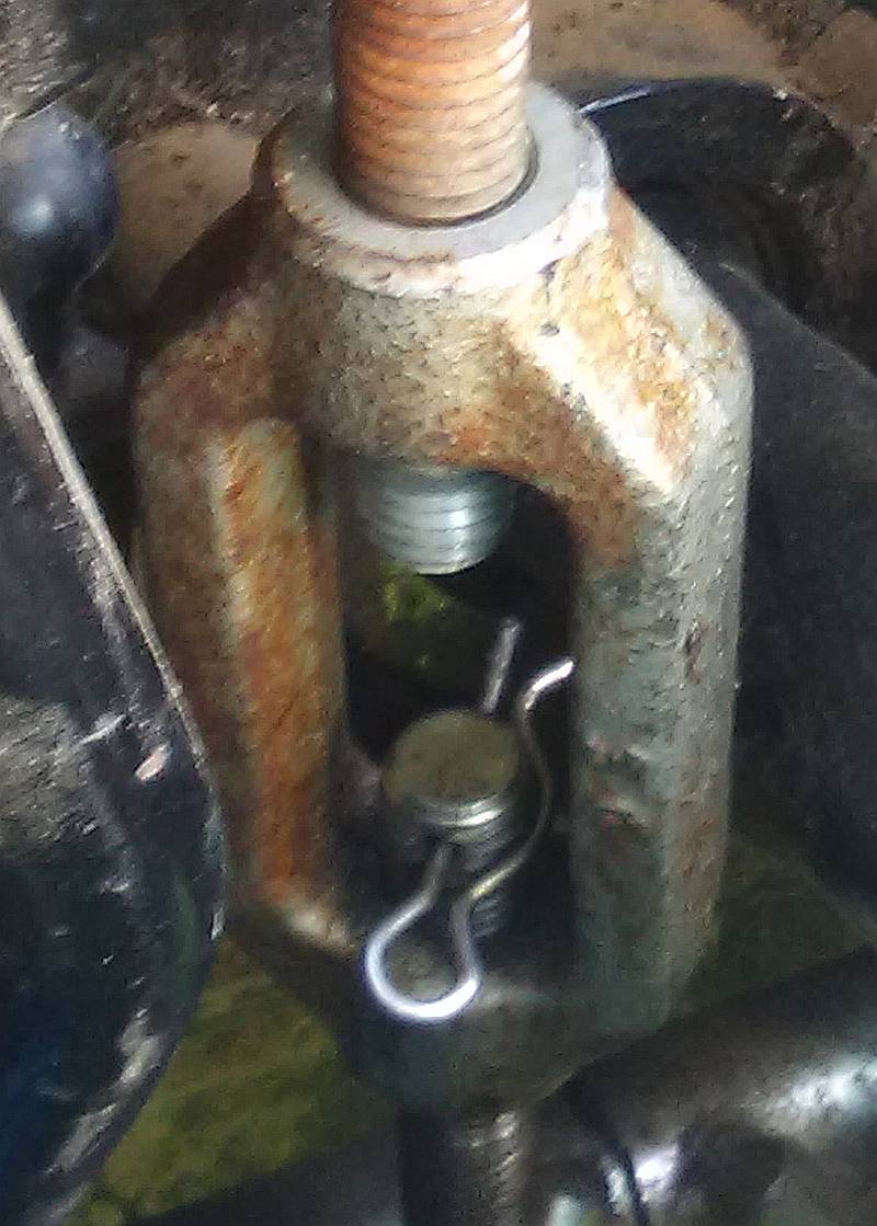

I'm not sure we've gotten to the crux of the OP's issue, which I'm not sure they've clearly explained. My turnbuckles have these keeper pins that prevent them from turning either way once adjusted.
I've not seen that method used before. Looks fairly simple yet effective.
