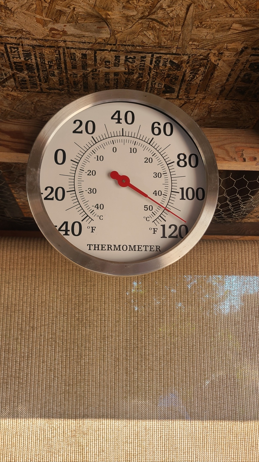

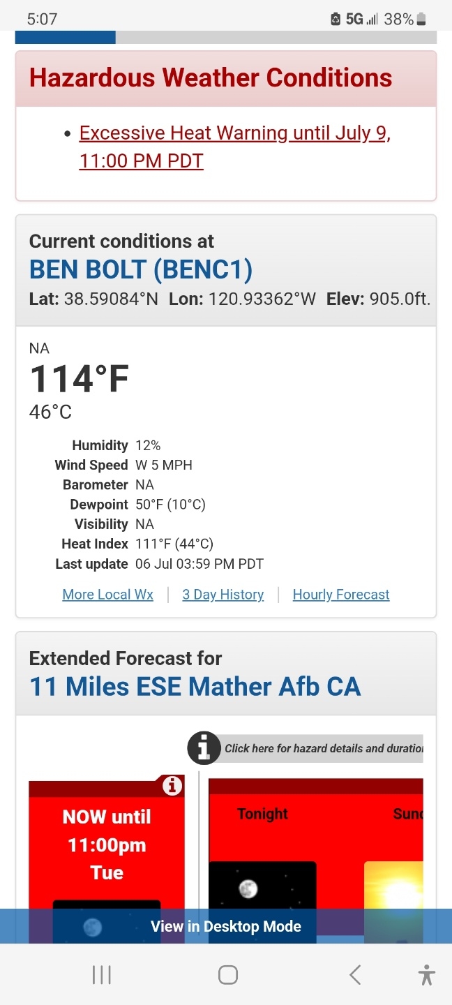

You won't be disappointed with a mini split air conditioner that should be more than 19 seer(mine is 21 seer)
(SEER stands for Seasonal Energy Efficiency Ratio The higher the SEER rating, the more efficient the system)
Past July, 2024 in central and northern California temperatures were more than 110-115F degrees for 15 days straight.
The mini split unit I installed was a life saver.
I turned on the unit 24 hours 7 days for 2 weeks with auto, eco functions.
The electric bill was 15% lower than last year even though the temperature was a lot higher and longer than last year, very quieter than the old one and a much cooler feeling.
I won't look back to the conventional air conditioner. Period.
