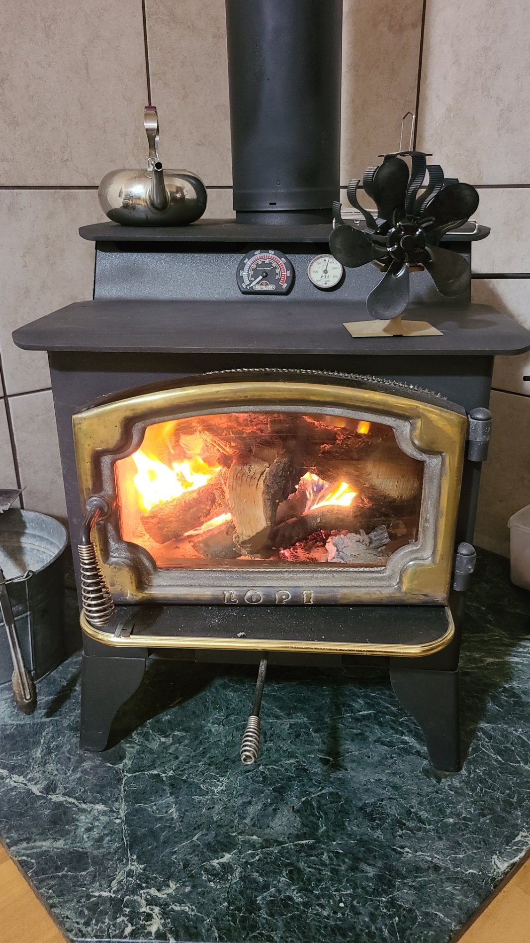

I really need only AC in the very hot Northern California summer season.
During the winter season, I have had a Lopi wood stove since I moved to a rural area more than 40 years ago.
No cost for firewood because I can get it as much as I want every year from my property and selling the left over.
Also, it makes such a comfortable and warm environment for the entire house with no comparison between the electric or gas heater.

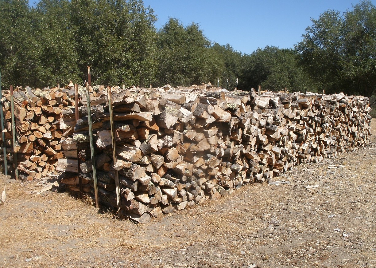

Nice cord wood... how is the market and curious the cost delivered or picked up?
   / Have you ever thought about changing the central air conditioner?
#15
The price of the live oak firewood per cord is around $400 with no delivery but pickup only. (firewood guy charges much higher)
Live oak tree firewood is the best, the densest, and heavy wood, burning very hot and not much ash left in my experience.
No comparison to the soft firewood like walnut, maple or even almond.
