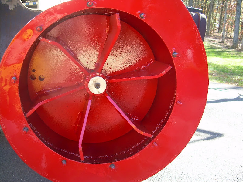

I would like to see pictures of the blade that does all the work if anyone has any?
I have built one of these type fans and cut material for another. Here is the cad image of the more complex fan (used a log splitter to curve the blades in a die). They were tabbed to the disk so alignment was perfect. Dynamically balanced to 8 grams after welding, then further balanced by removing material from the heavy side.
The photo is from the simple fan. There are claims that the curved fan moves more volume, however, nothing is proven yet.
Both are 12" diameter. The curved fan runs on a 8hp and the straight fan runs on a 5hp - used to run on a 10hp until the connecting rod wanted to show itself outside the motor!
