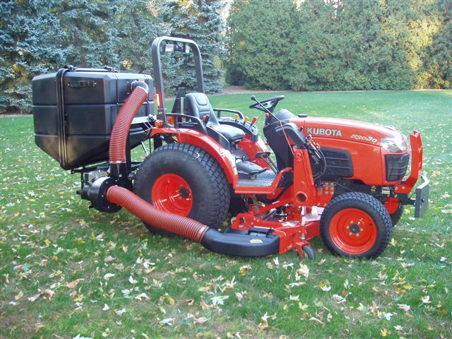

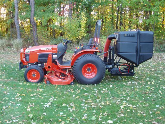

I used to have a vacuum with a 3HP engine that I used with my JD318. It had a cloth bag that had a big zippered opening in the back so you could clean it out. It worked well but did not hold many leaves and it was a dusty mess to empty it. I found a pull type EZ-RAKE with a 1 cu/yd capacity hopper that opens up and emptys itself. It works a lot better and is easier and faster to use since I didn't have to empty it as often. When I bought my B3030 last year I decided to put the 3PTH to use so I modified the EZ-RAKE to do that. It is supposed to work on mowers up to 48" but it does well enough on my 60" MMM to satisfy me. I only have to slow down if the leaves are really heavy. The EZ-RAKE is now sold by Bluebird. I highly recommend it.
The second picture has the foot pedal circled that you step on to open the clamshell hopper. Gas struts help lift the rear part and hold it open.

Toolguy..... that is a nice setup ! I'm going to look around a bit more before i decide to build or buy a leaf collector. Yours looks like a good sized bin for me. I've read up a bit on the Cyclone Rake here..... and though owners say they work well, it sounds like they make ALOT of dust due to the hopper being made of fabric. We have a new DR Power store i need to go check out about an hour from me. I had thoughts i could come up with something with plenty of suction that wouldn't look too butchered together for reasonable money. Wish me luck !
