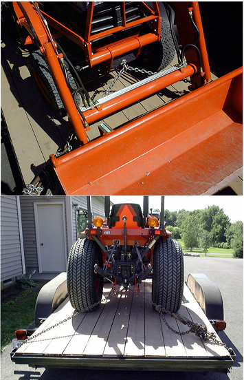

Kent, I think stepping up to a bigger trailer is the smart thing to do. I use two grade 70 5/16" chains with load binders to secure the tractor to trailer. (see photo) I think chain is better than straps, as it won't cut like a strap can. I use a 16' trailer and have no problems with the tractor with FEL and rotory cutter on.

Kent, Yes, two chains. One in front and one on the rear. I now have two ratchet binders instead of the lever type. They do a much better job. I was using these old binders and chain that my grandfather gave me years ago. Age and grade was unknown, broke a binder one day when loading it up. Thought this is nuts, have $18K invested in tractor and am too cheap to spend $100.00 to secure it right. So got what I needed and now I don't have to worry when I trailer the tractor anywhere.

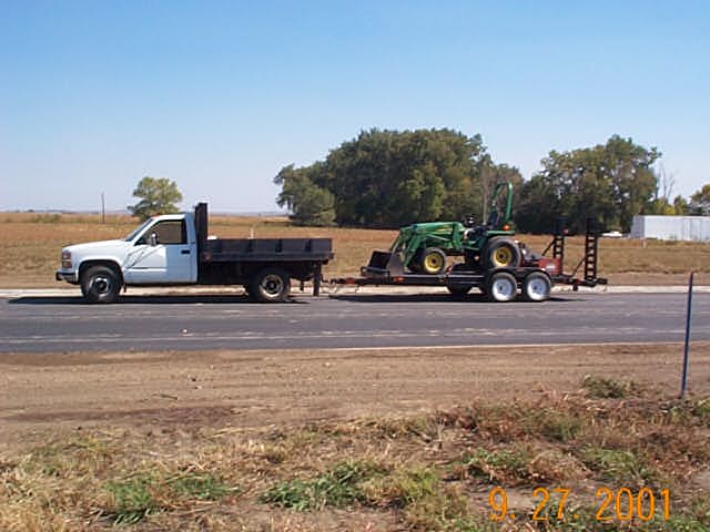

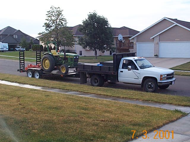

I bought a 16' t/a axle trailer for my tractors. It's rated at 7000# GVW, and I haul about 3600# max weight. It has brakes on both axles, bought it new for $1800. I chain the 955 on each side, the 1050 is chained front and rear. I'd rather use the ratchet binders than the current lever binders.
Paul

Here's one with the 955 on the trailer.
Paul
