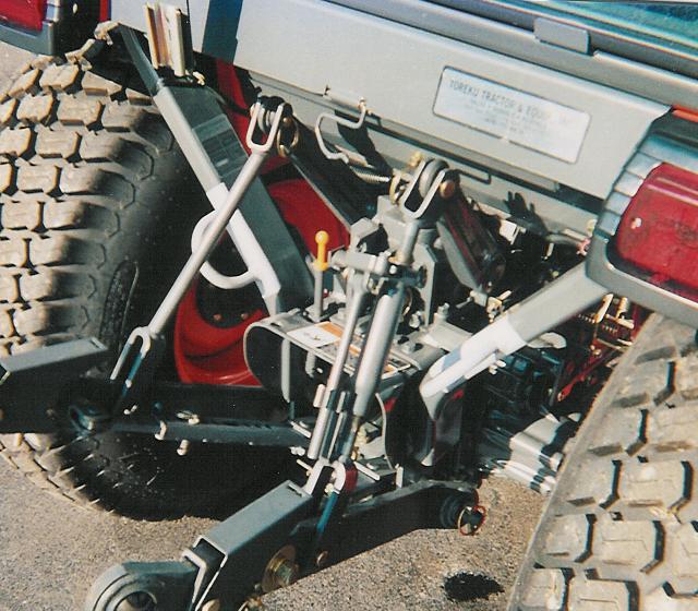

I use chains on the rear and the straps on the front. I figure the most pressure will come from a sudden stop rather than me trying to accelerate. This setup has really worked well for me.

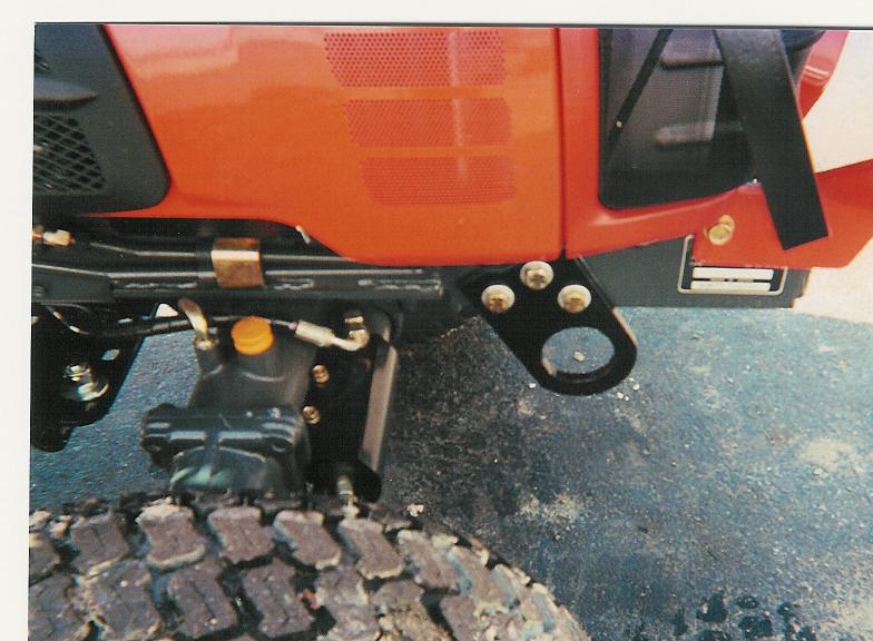

I have custom brackets to run chain through on my machine.

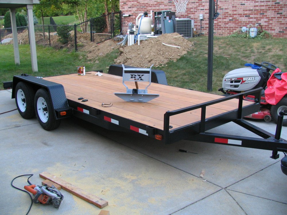

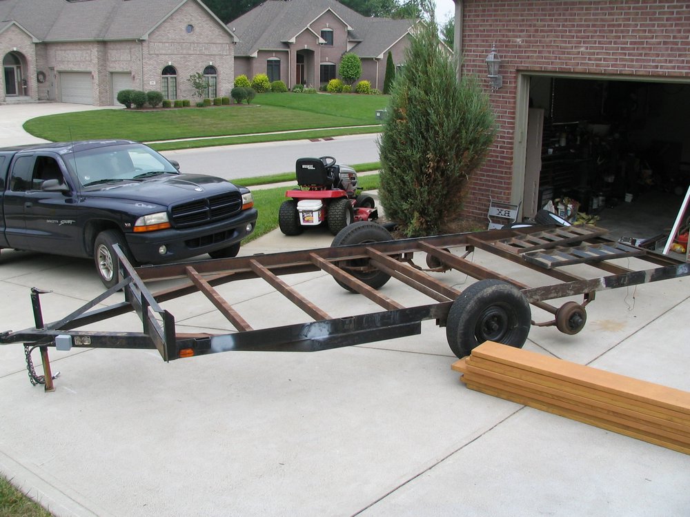

Original and rebuilt .... $750 for the trailer and about $500 in tires, fenders, new deck wood and paint. The back started out straight and I cut it so the back 2 feet dropped down. Fun project ....
Nice .... its the little things that work so well. You kinda wonder why something so simple was not part of the machine straight out of the factory.
/ Hauling the Bota #19

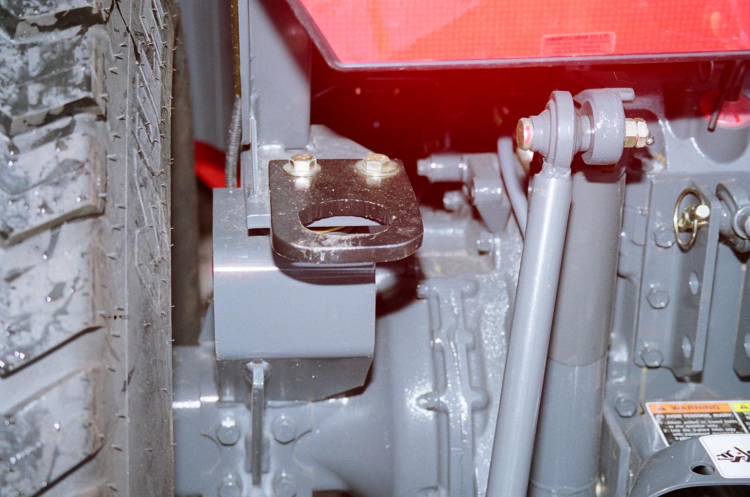

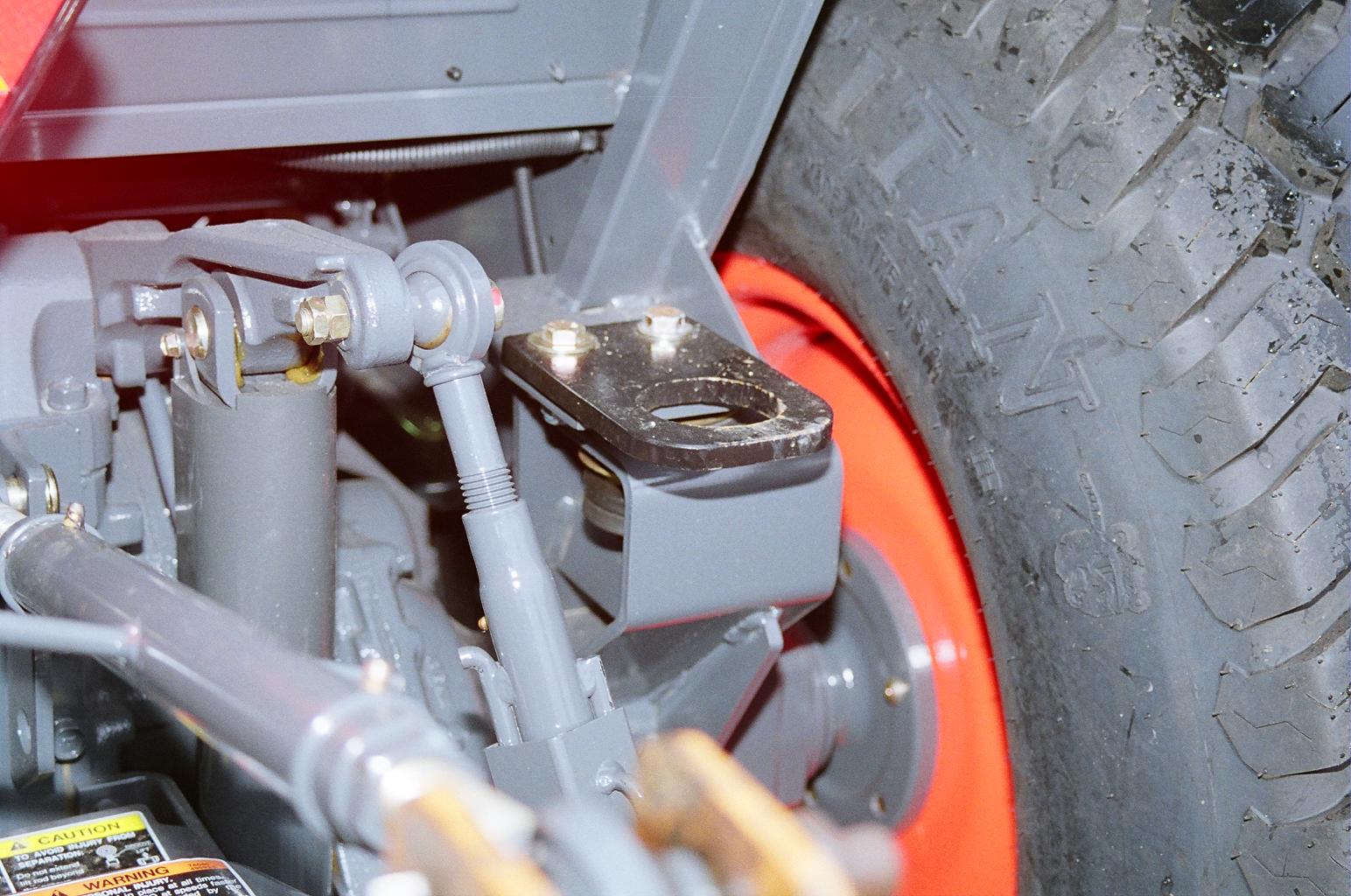

I had to have them installed on all my machines, im trailering my machine 3 or 4 day a week in peak season! There is just no good places to chain or bind into these machines. these are the rears i installed on my B3030, the fronts are the same on both machines.

Great job BX, now you have the perfect trailer for what you need it fore. Looks great and I know you will have many years of good use out of it-Good job!:D Lawn_King, I love the added simplicity you manufactured. I usually just hook the tie downs to the tph dead mans in the rear and then I can just put the hooks the the corner of the frame in the front one my BX 2350 but is the same result as you!:cool:
