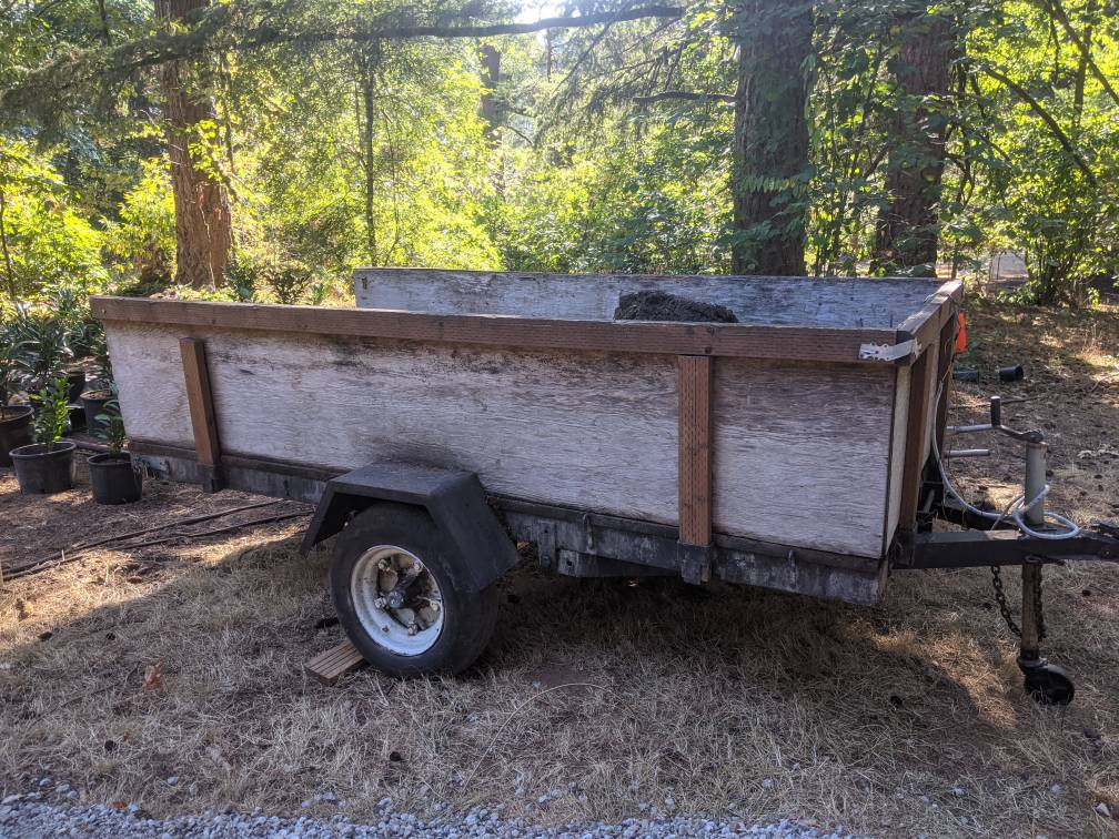

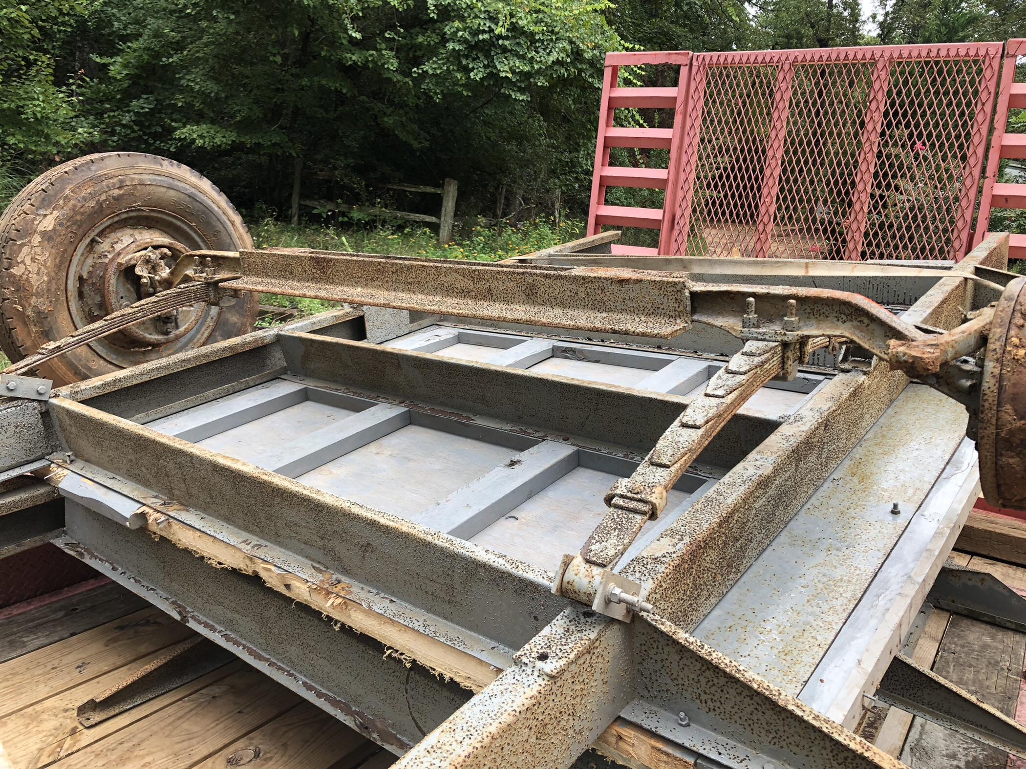

That looks like quite a few homebuilt trailers I've encountered. The axle looks to be mounted at the midpoint of the cargo box, which balances the gravel load all on the axle (mobile home axle, too). Slipper springs, and light ones at that. A properly built box trailer should have closer to 60% of the box in front of the axle, so that tongue weight increases as the load does. Proper tongue weight is important - too light will cause the trailer to whip at speed, and that's pucker time! Quite often results in a very bad day.

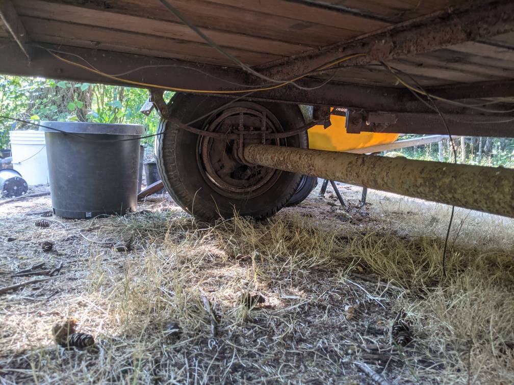

I just scrapped a 24’ homebuilt travel trailer I found on CL to get some steel to weld with. He told me if I brought fresh tires I could tow it home…glad I didn’t even attempt that method. Pretty scary that this was holding a 24’ travel trailer, he had torn it down to the deck before I got to it but the floor was 2x6, 2x4, and 3/4 ply construction and weighed a crap ton so can’t imagine what it wheighed as a complete travel trailer.

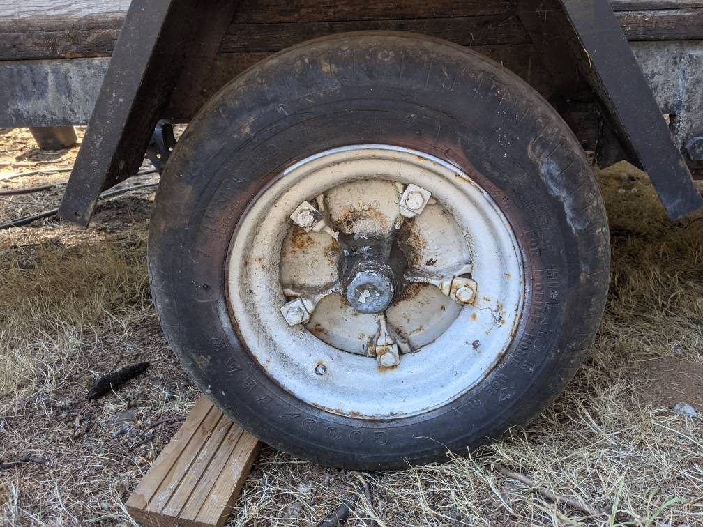

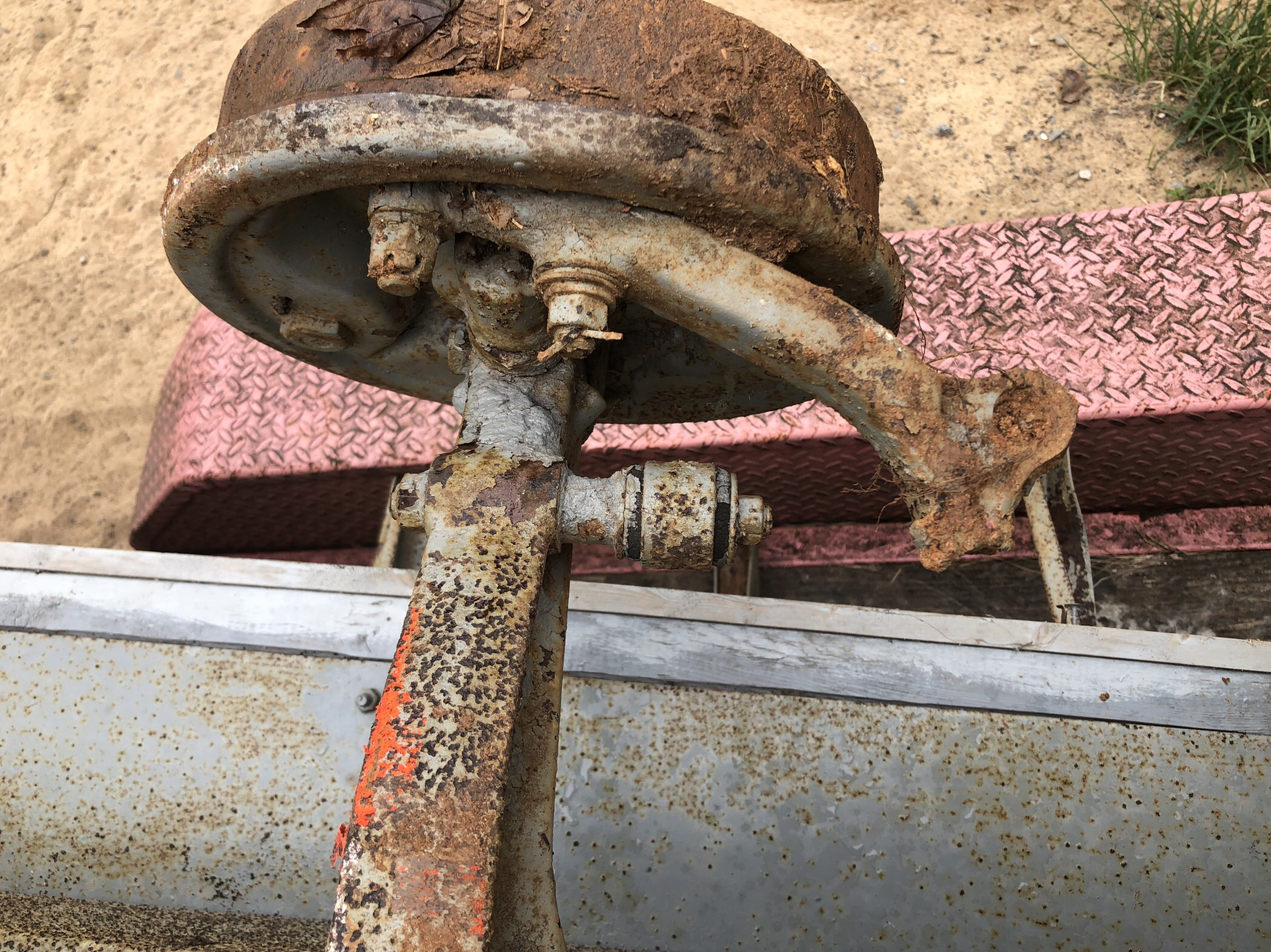

Looks like that "one-ton" trailer has a 6K axle. It looks like a mobile home axle, but that hub is for more than 2000 lbs I believe. You could expect your SCUT, with loader, to come in at about 1800lbs. A yard of gravel is about 2700 lbs - more for some grades - so if it handled that with grace, your tractor would be less of a load. The leaf springs appear to be your limiting factor.

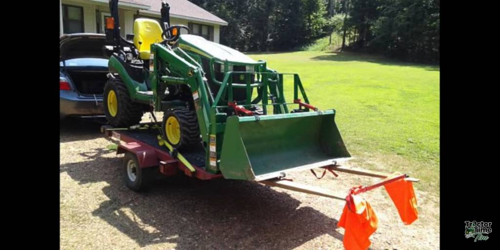

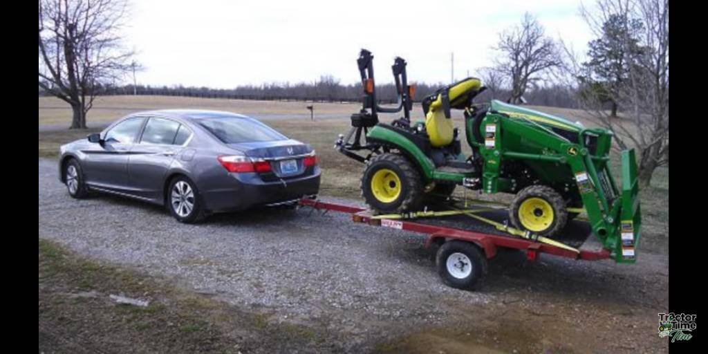

All you need is good trailer brakes and weight balance. If your underpowered, then gearing and patience. For instance, this set up here requires all of the above plus an additional abundance prayer. :)
That may be a smart car, but not smart driver. Ha

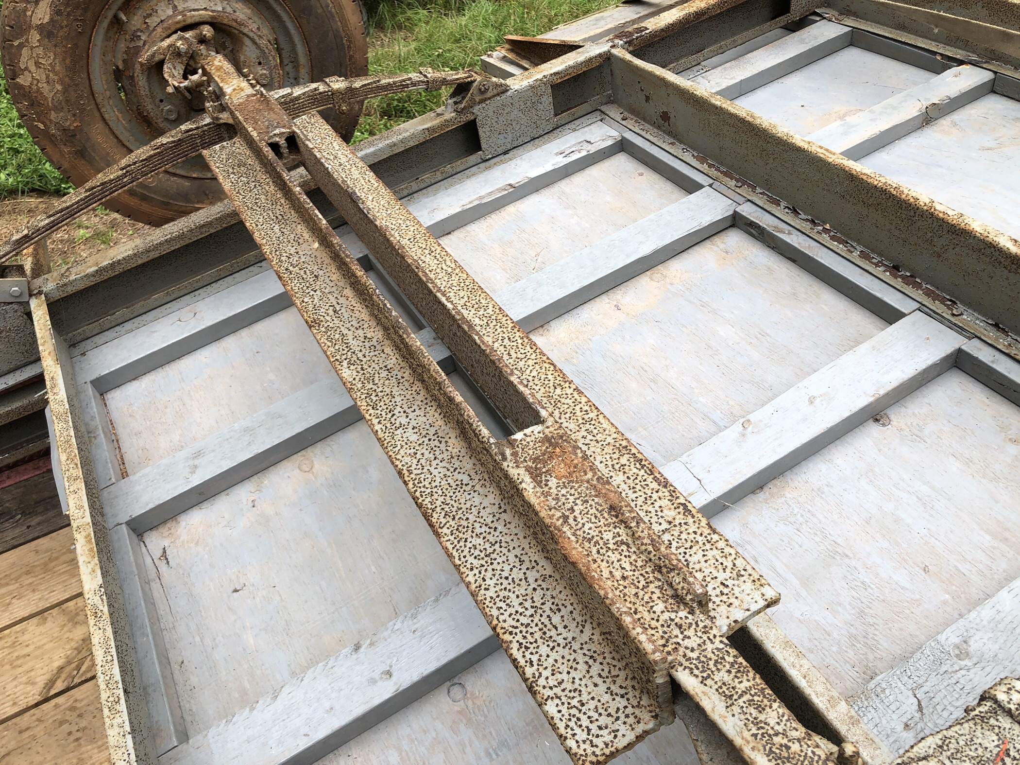

View attachment 712206View attachment 712207
NOT a mobile home axle. This is a older pickup front axle that has had the spindles welded to the axle and the axle itself cut in two and had some angle iron pieces scabbed on to make it wider. Even the springs and perches are from a truck. This is a recipe for disaster.

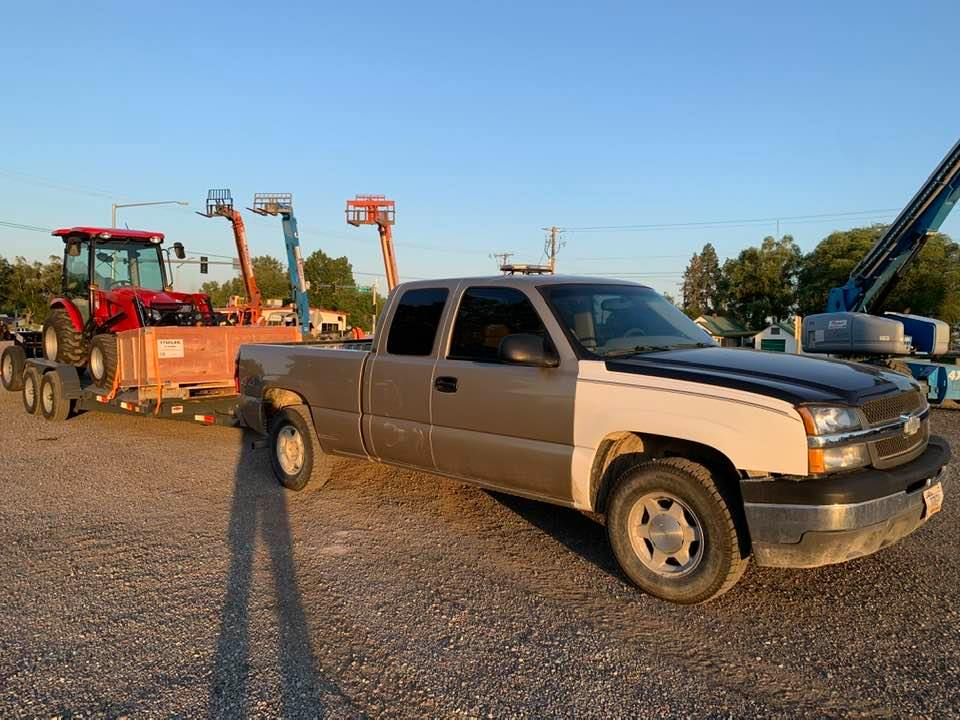

I wouldn’t haul my BX on less than the 7k GVWR car trailer. It only has brakes on one axle, which sucks, but otherwise it’s much more trailer than required. I prefer to be well within the envelope, not smashing out of it, when possible. I also prefer to not have one tire, on each side. On the car trailer, it’s a cakewalk. In my dump trailer, it’s even better.
My first truck was a 1500 Silverado. It was okay, but had the wrong rear axle ratio. My dually is a much better puller, though unnecessary, for a SCUT.
Silverado pulling a rented dump trailer:
Current truck with car trailer:
Current truck and dump trailer:
