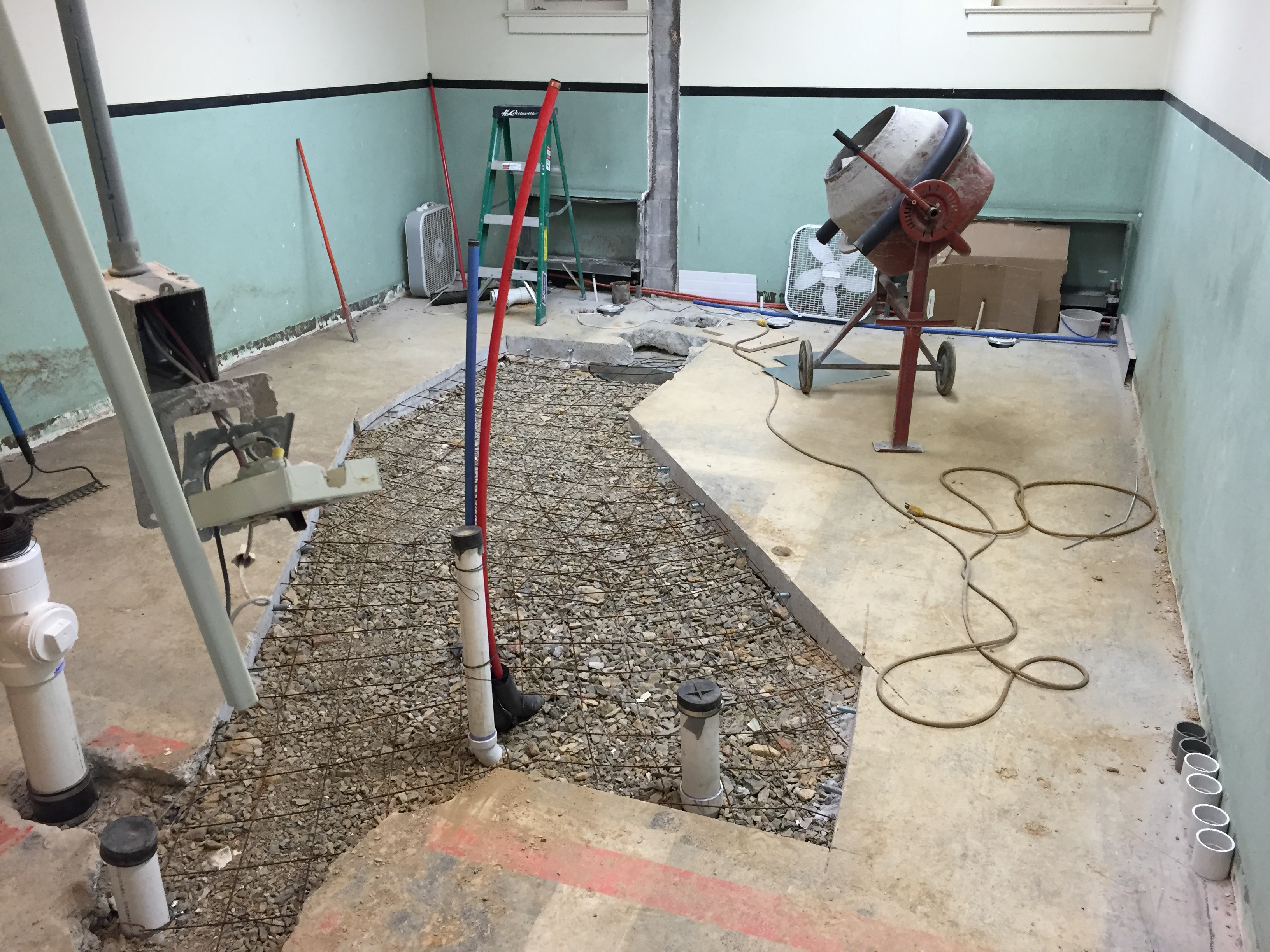

Not seen was that one person mixed the plastic fiber in, others were at standby to give anyone a break. And 2 people added mix to each mixer. We had a vibrator, water pump, everything was powered by 2 little 2000 Honda generators.
Pouring via bags can work! :D We'd never-ever haul wet mix via trailer....
