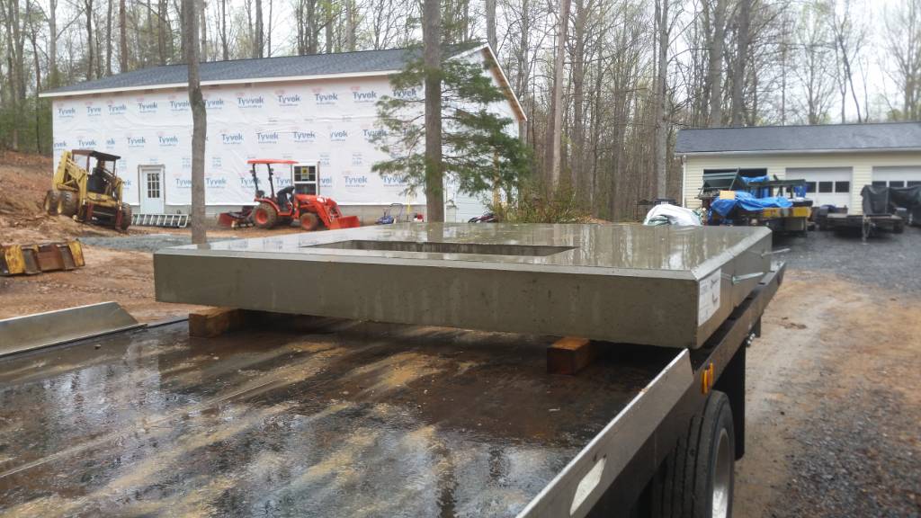

I know this has a large footprint and a steel deck but it was about 7k lbs, hauled it on a rollback. 20180424_121113.jpeg

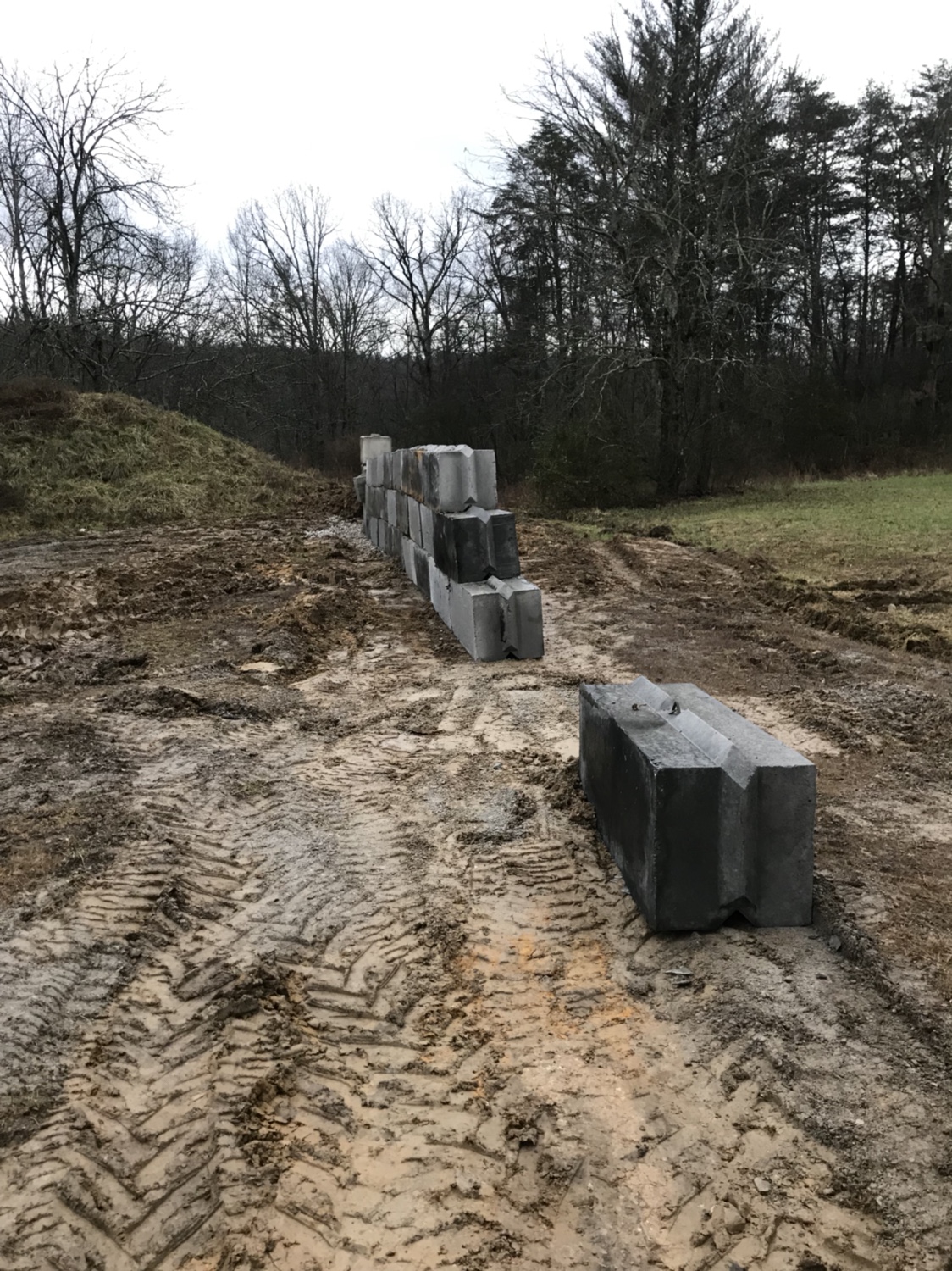

I got the concrete wall put up. The whole project was pretty much a train wreck but hauling them went smooth.IMG_1048.JPG

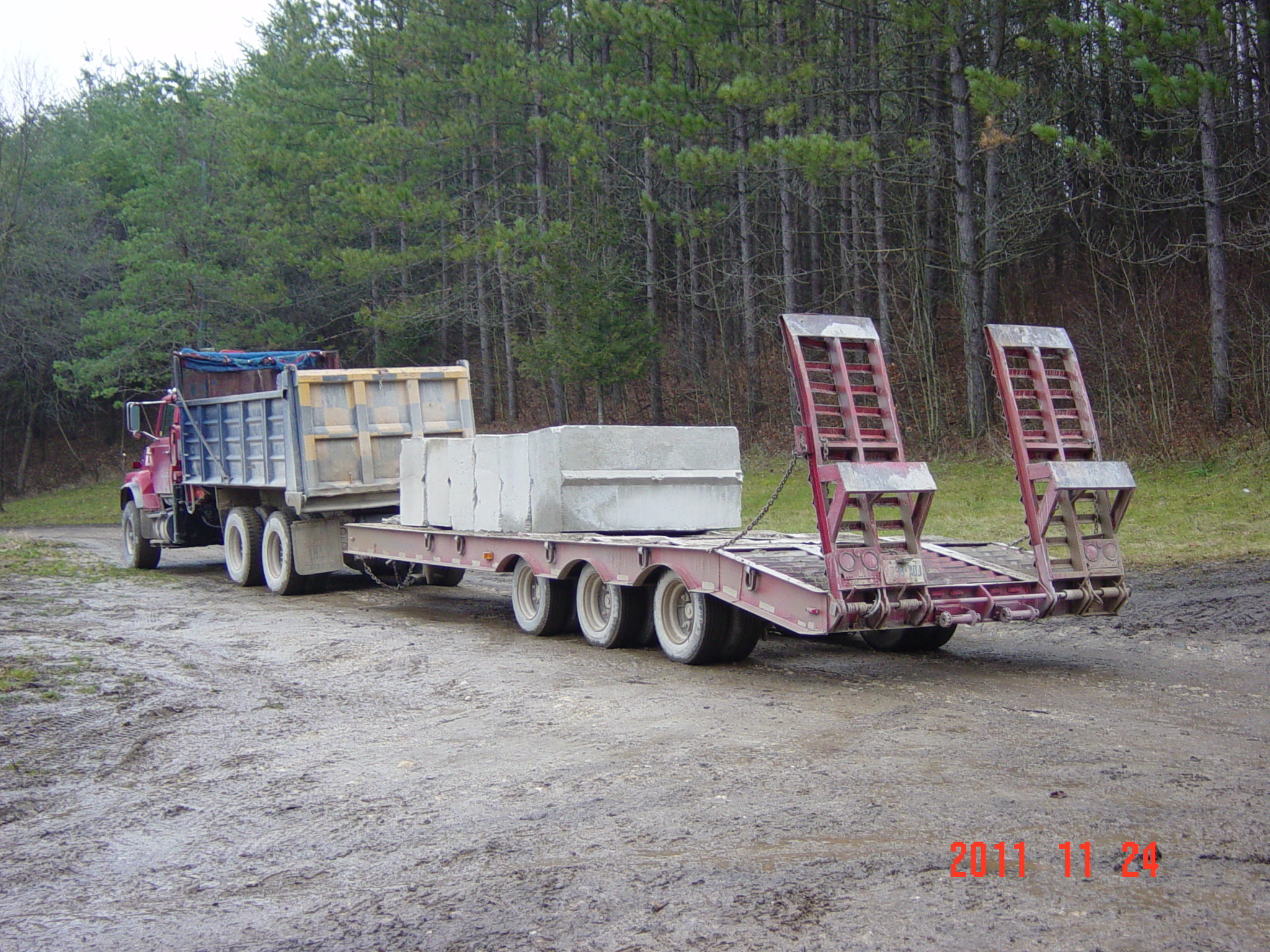

My Contractor hauled these about ten miles. Not sure what they weigh.
There’s 2 different load distributions.
- split between wheel axles and tongue
- distribution on main beam.
In above picture, one could of put a block behind or above rear axle which would severely lessen load on beam, yet could have a similar tongue weight by moving one or two forward.
Above picture looks good having significant tongue weight as the braking is shared by the trailer and truck’s rear brakes more evenly.
