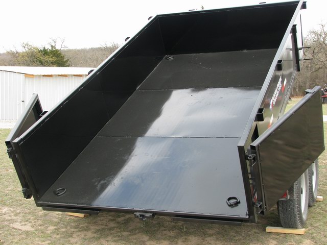

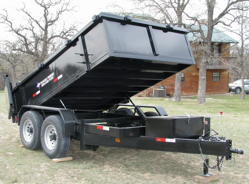

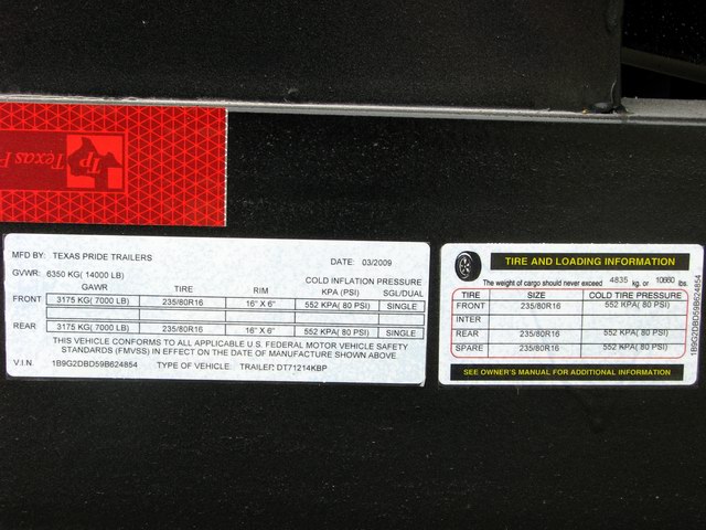

My new dump trailer came with D-ring tiedowns in each corner of the bed. Check out the load dataplates for hauling capacity. Also, the beds understructure is plenty strong for any hauling you might do. I think you'll be happy with your dump trailer even though they might cost over twice what the non-dumpbed trailers cost. The company that sold my dump trailer charges $1000 for each additional 2' length: 12' to 14' to 16'. . . .

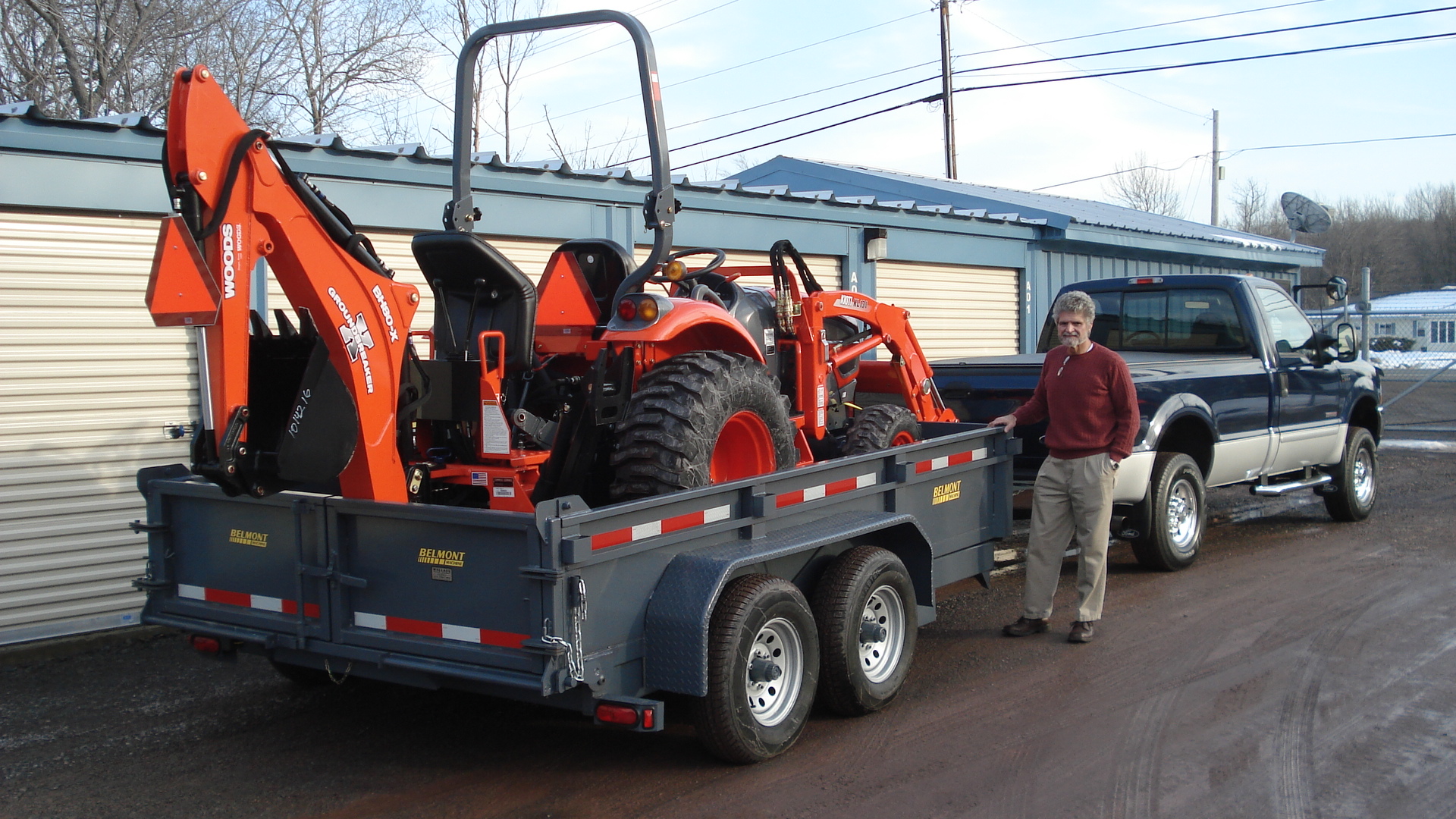

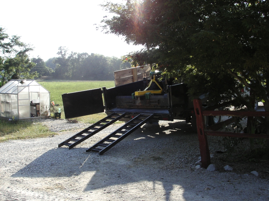

This is my 6'8"x16' trailer and 3/4 ton truck. With 7,000 lb axles I can carry about 10,000 lbs of payload. I upgraded the hitch receiver on the truck from the factory 2" unit to a 2-1/2" receiver (Titan hitch from Reese), and will be adding air helper springs and possibly a weight distributing hitch.
I highly recommend you check the load rating of your receiver, ball mount, and hitch ball; and make sure they are rated for the load you plan on pulling. My factory hitch was only rated at something like 7,500 lbs.
My tiller and post hole digger are in the bed of the truck. I have removed the SMV triangle placard from the backhoe so as not to lose it on the road. The picture was taken before the red flag was put on the backhoe bucket and a tie down was used to secure the loader.
Despite the disadvantages of weight, cost, and ease of loading/binding, dump trailers are pretty versatile and certainly suitable for hauling a tractor.

Marty, are you sure there's not a kitchen sink in there somewhere?:D;)

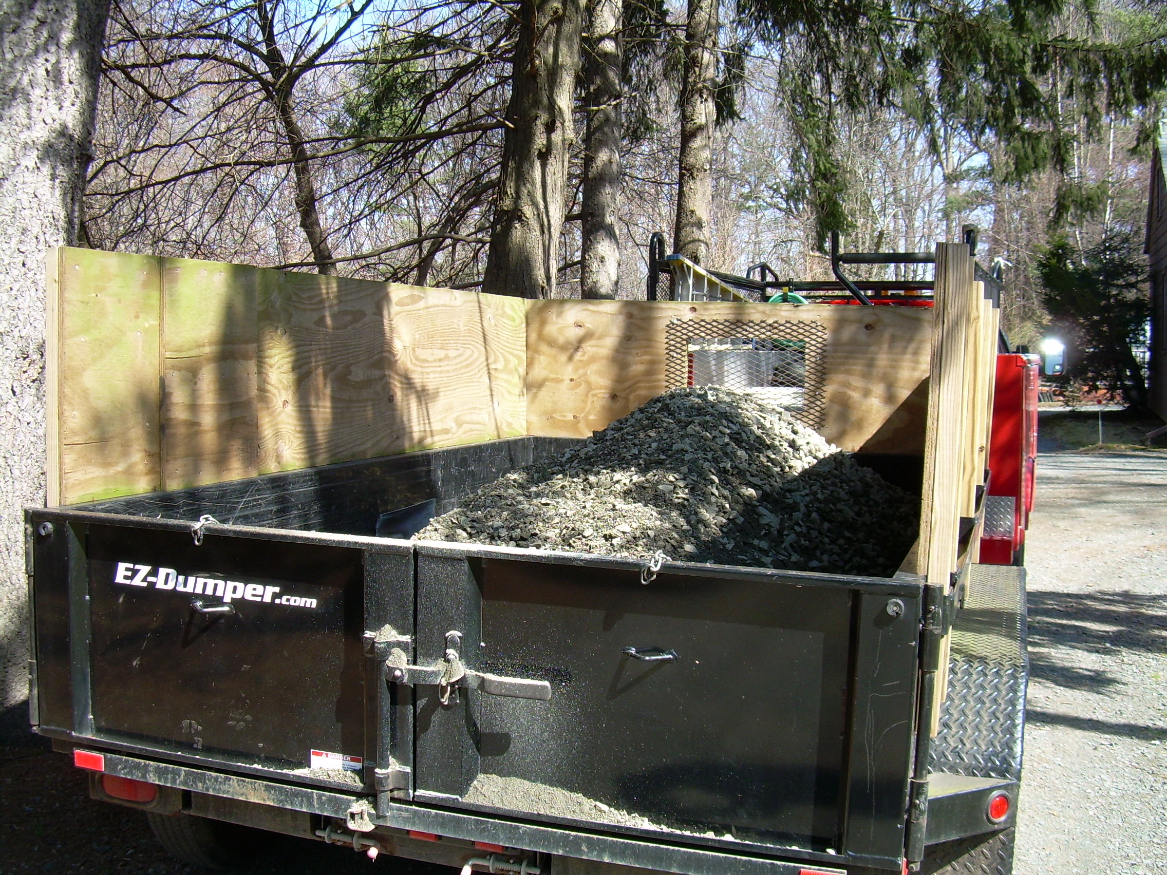

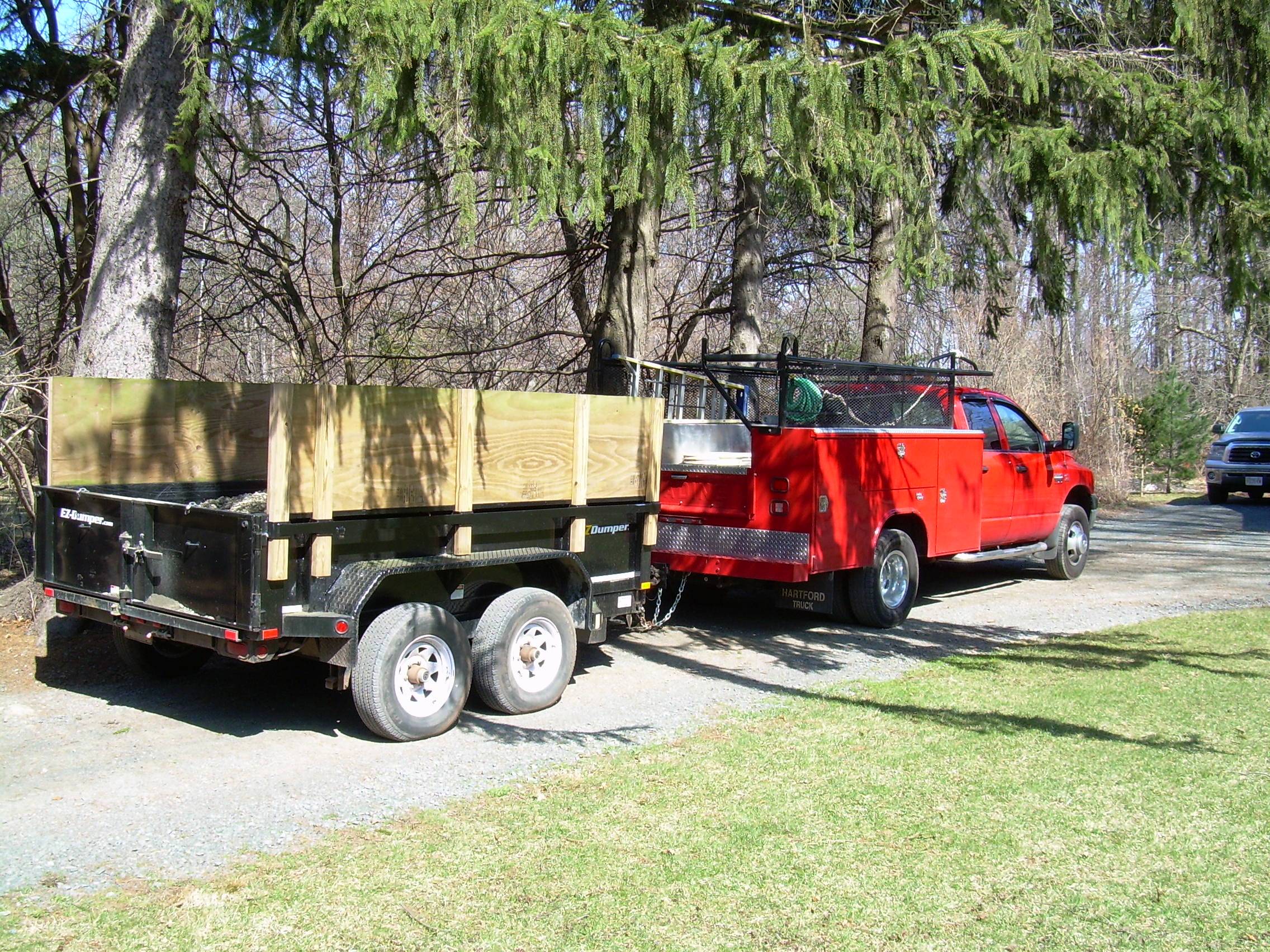

Yup, on my EZ Dumper I have never had to boost the battery, going on 4+ years, even with long stretches of no use and short drives.

One thing to remember is a TLB on a dump is starting to get a little on the topheavy side. Watch you stability around turns and sudden braking.
Nothings better for hauling equipment than an equipment trailer. Load stays low and less tippy.
I realize not everyone can have 2 trailers, but I though it worth mentioning just the same.
