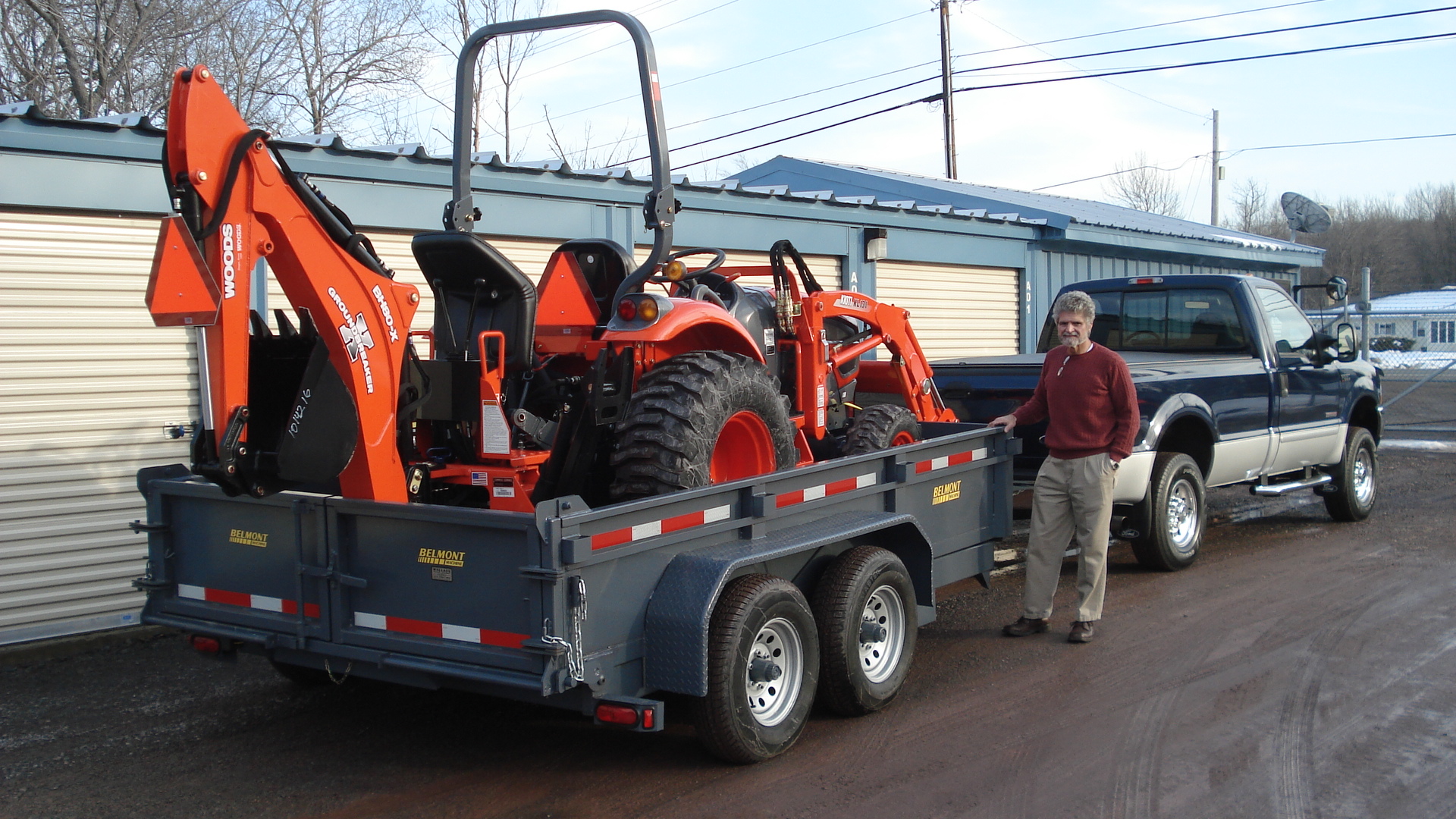

Here is one of my customers...
/ Haul tractor on dump trailer?
#11
Well Wallace, that picture is worth a thousand words right there. That even looks like my tractor except for a little different BH. Can you tell me what length and width trailer that is? It doesn't look very big. Maybe I can get by with a smaller rig than I thought. I see the bucket is hanging over the front so obviously there is no problem doing that. I appreciate the help.
#12
Is there a bucket attached to that loader? Sure looks like it would severely limit turning if there is one attached.
Interesting question. I didn't think about that. I'll bet there is no bucket attached. I think it would be visible by the right front corner of the trailer.

It's a 6'8"x12' 10k
There is a bucket on it and the reason you don't see it is because it is only 60" wide

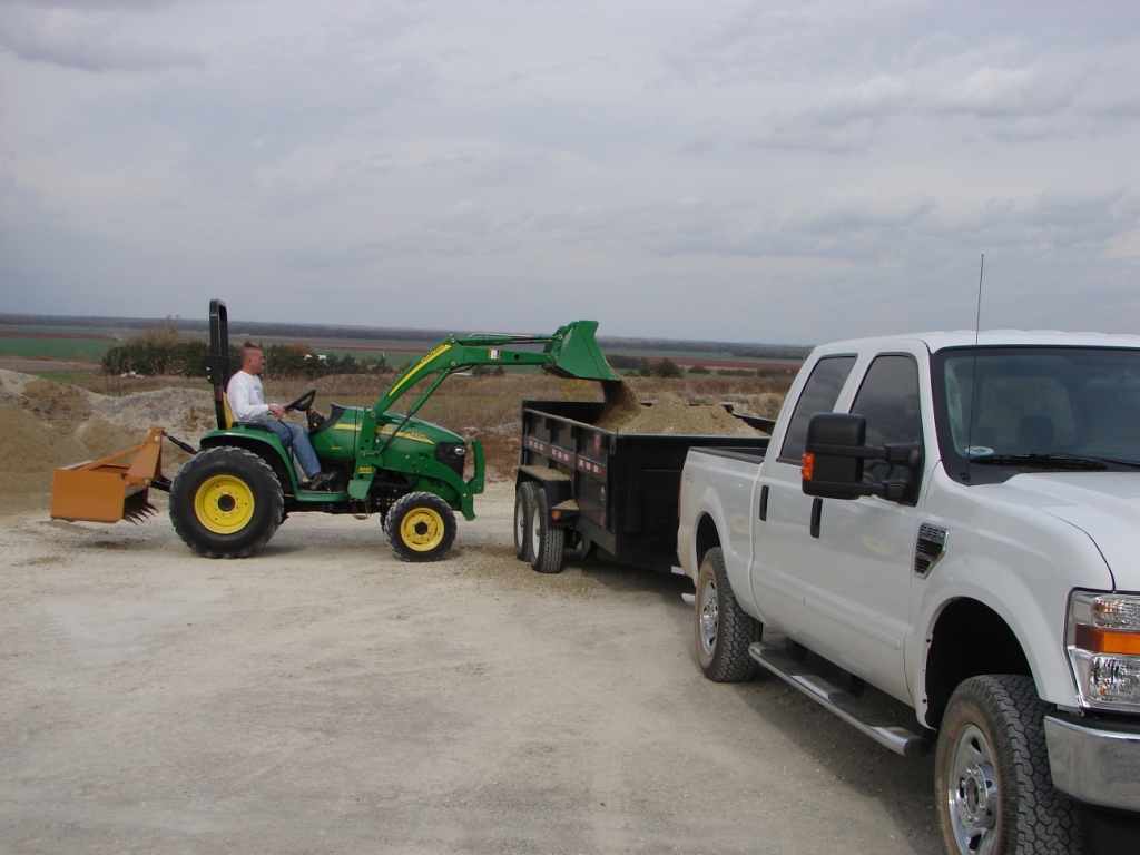

I agree with all your reasoning for swapping the dump truck for dump trailer, though I don't know where you found a dump truck getting 17 MPG :)
When I first got my 6x10 5 ton dump trailer I went to the quarry to see if I could get a tag from them that lets me buy from there, they don't allow pick ups or home made trailers. Was worried they might not allow this type of trailer, the guy at the scale house said they prefer this type of transport over a one ton landscapers truck with an over sized dump body, where the owner thinks he can fill it to the gunnel's with process road base.
I drive right in there now like I own the place, show the loader operator 4 fingers and drive out with 4 tons of product, which is not that big a pile in a 6x10 bed. Of course the trailer weighs more than a ton but with the substantial amount of weight on the tongue, I'm legal.
I'd get a 6 ton now as it's easy to overload, and wouldn't get anything less than a 12 footer, especially for OP's intent to hall tractor.
This pic is of 4.5 tons of wet process, I was probablly over a little on this load. doesn't look like much though.
JB.
