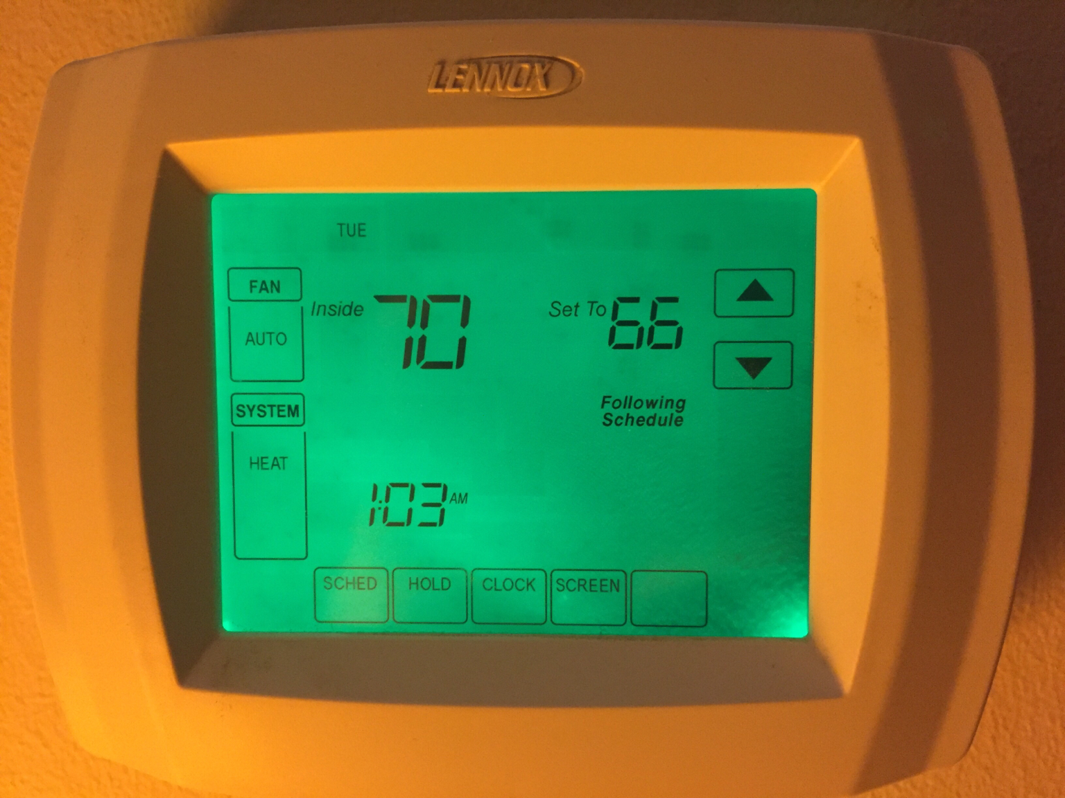

That being said that's what I learned in HVAC school 7-9 years ago. That's how I set my system up to swing for 2 degrees and no more.
For example my heating schedule in my stat is this. From 1pm-10pm it's 66 degrees in the house, I get home around 11pm from work, from 10pm-12am it's 68 degrees which I'm usually up watching tv around then before bed. From 12am-10am it's 66 degrees, when I'm usually sleeping ext. 10am-1pm it's 68, an average when I wake up and till I leave for work.
So it's only at 68 for 5 hours of the day, when I'm home the most and it's 66 the other 19 or so hours of the day.
I do change the temp depending if I'm hot or cold as needed but that's an example the schedule I run. Saturday and Sunday are different, those days it's mostly 68 due to heavier traffic in the house, more company ext.
   / Has your electric bill gone down if you have a lot of LED bulbs? #42
A quick pic of my stat, it's been in the 60s during the day, the house picked up enough heat that at 1am it's still 70 in the house which means it barely ran at all today.
