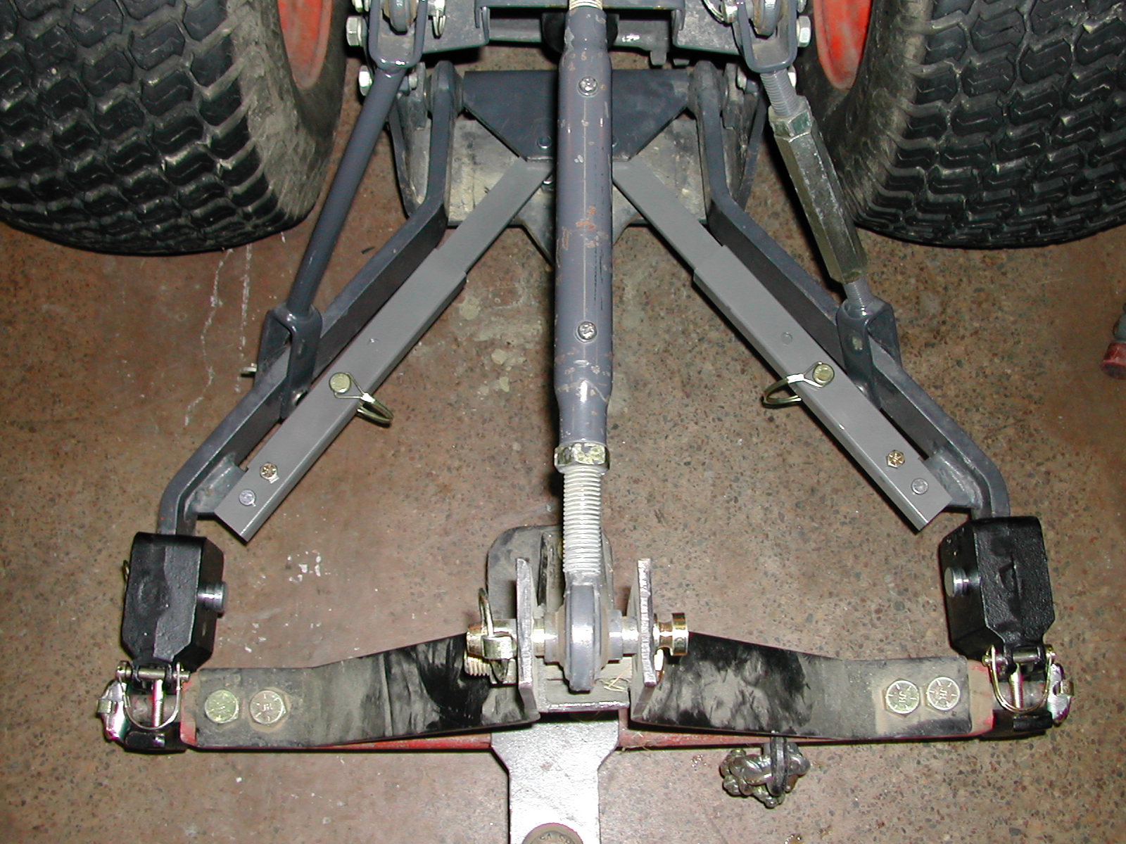

Here's what I believe will be my answer to controlling the width problem when using the Link Wiz quick hitches. Having different width implements has been a headache from day one. I got the idea from a New Holland compact tractor. In the picture note the lighter gray sway control arms on the 3-point. No more need to manual loosen and tighten them with a wrench. I just finished them tonight.

These are similar to the adjustable sway bars used on the B2710. I have the parts breakdown for them, but I want to find someone with a parts manual so I'll have the part numbers, and I'll just get a set from Kubota. Nice job by the way. Stan

Ok, I went to the Kubota dealer today and they had the B2710 sway bars in stock, so the part numbers are listed below. Excluding the hitch pins, the cost for the two adjustable arms and the two pivots required was $69.00.
Here are the part numbers for the adjustable sway arms to get rid of the floppy turnbuckles and clevises on the BX 3PH. Now, because of the 3ph difference on the BX series, some adapting will need to be done at the attachment spacing plate that fits over the frame pivot bar, but I will post some photos in the next few days so you can see what I mean. Stan
2 ea 6C070-65333 Plate, Stab Arm @16.03 ea
2 ea 6C070-65320 Pipe, Stab Arm @16.03 ea
2 ea 6C070-65350 Bolt, Stab (pivot) @2.44 ea
Add about another $10 if you buy the 6 OEM clevis pins and hair pins.
