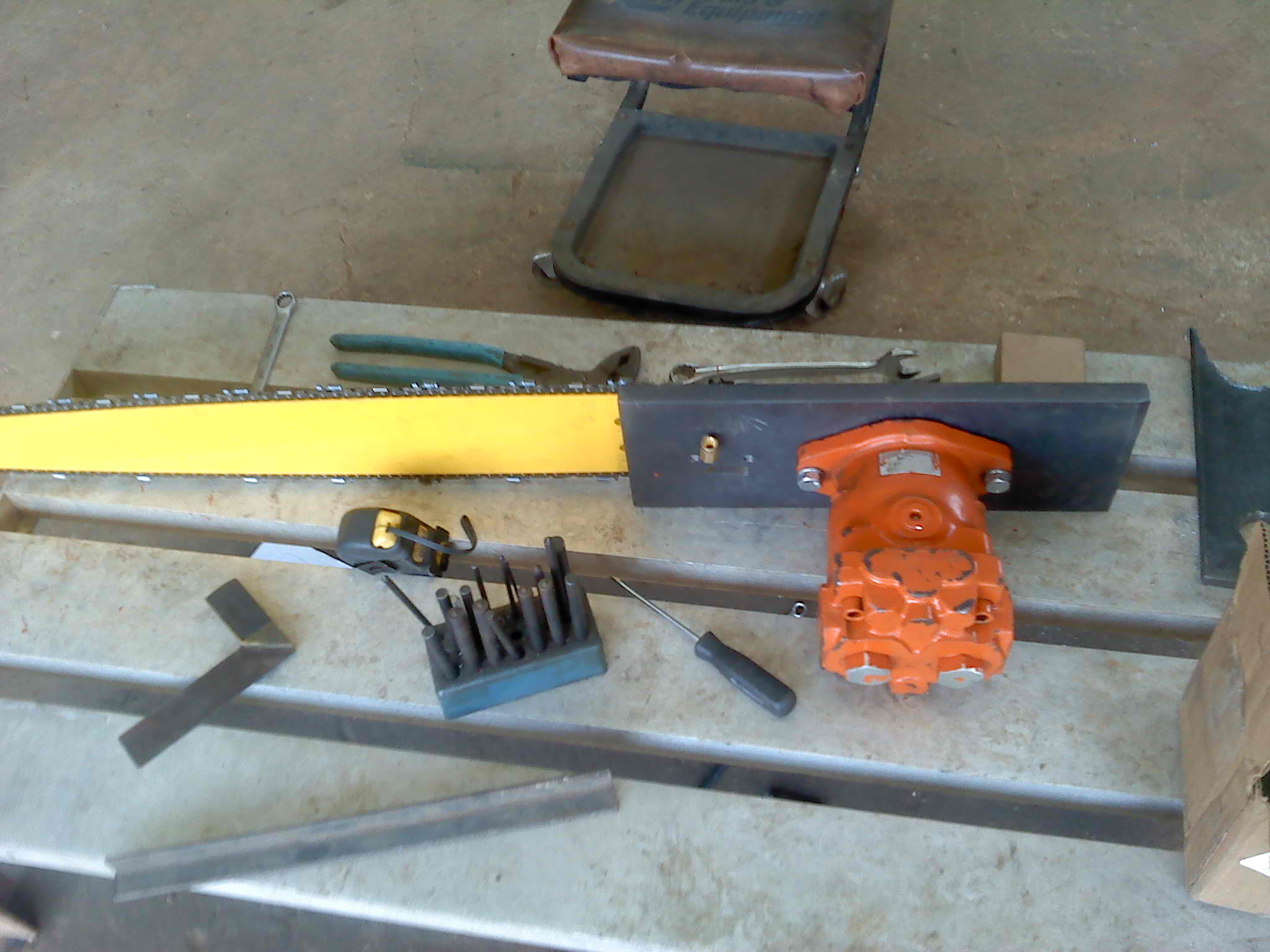

The saw in the pic is one I built for my processor build. This motor is a 1.3cuin axlepiston type. The bar is 24in with a .404 full comp, full chisel chain. This saw is also untested as I developed health problems and have yet to finish my processor build.
First off, I would forget trying to figure rpms as a measure of cutting speed. Chain speed is figured in feet per minute or sometimes feet per second. chains speed can be varied by drive sprocket selection. A larger sprocket will produce faster chain speed. The trick is to produce enough torque to pull the chain at the desired speed. When building my saw, I choose a husky 3120 gas powered saw to try and match. Numbers arent in front of me, but I took the hp, torque, and chains speed to try and come up with a hyd motor combination that would match the 3120 chainsaw. Here is a link to help. Chainsaw Comparisons and Facts from Procut Portable Chainsaw Mills.
A lot of people have used this motor, .7 cu in PARKER MGG2:(-BA1A3 HYD MOTOR to build their saws. Some have tried the .58cuin motor and not been satisfied with the results. I cant say whether the complains are from poor motor selection or poor hyd design. I will say that even the .70 motor in the link will never be able to match a 3120 chainsaw when it comes to torque. Even tho those little motors are rated for 5000 rpms, you cant put the pressure to them to get the torque numbers you need.
Gear motors are usually limited as to rpm speed, even if you can throw more pressure at them to get the torque needed. You can compensate some on the speed by using a larger sprocket, but then you sacrafice torque losses. I chose the axial piston motor because it will produce more torque and higher rpms than a standard gear motor. This particular motor is a Poclain model M1. It is 1.3 cuin and can produce 4641ftlbs of torque. It does take a lot more oil flow and pressure, which means bigger hyd pumps and engine hp, but it all depends on how badass a saw you want to build. A 3120 chainsaw has 8.9hp, the axial piston motor will put out 25hp at 2000psi.

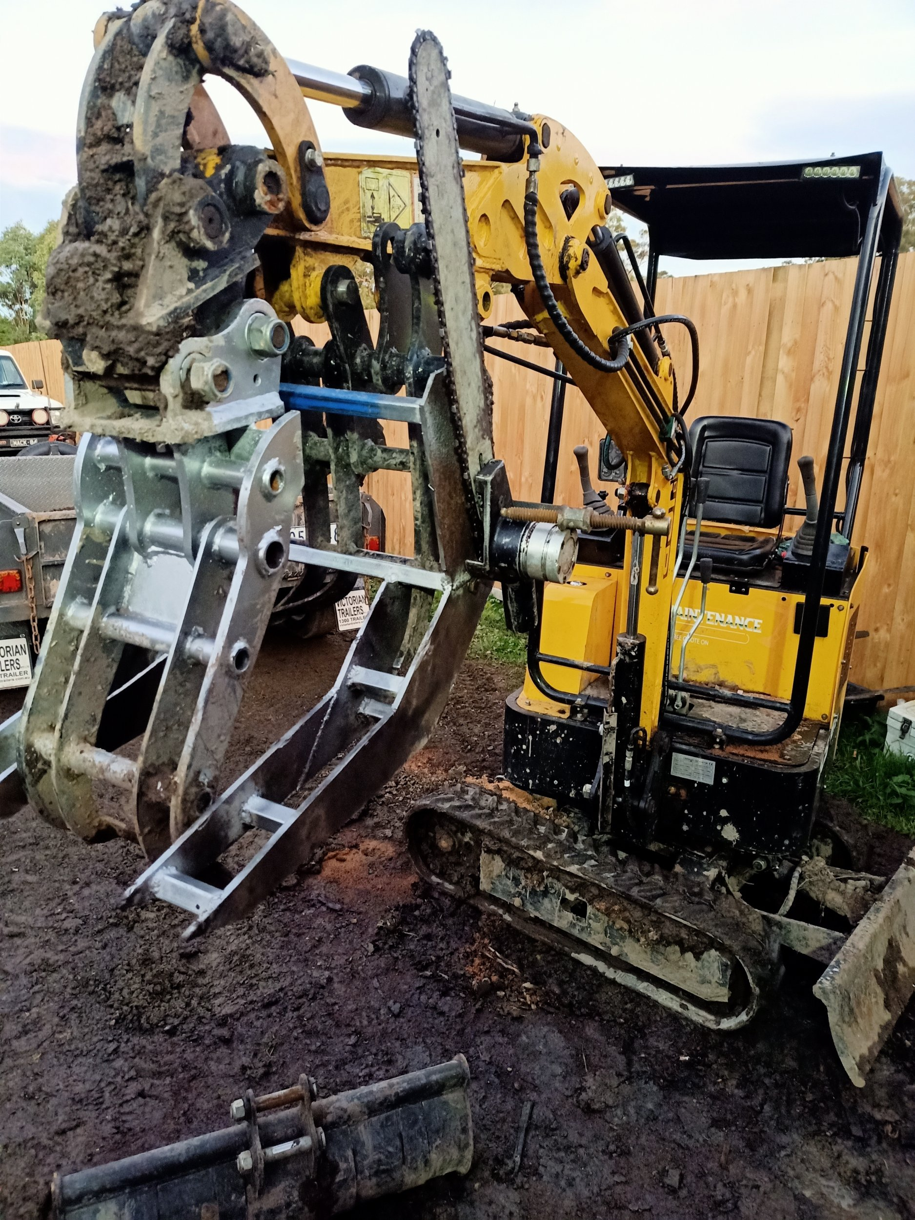

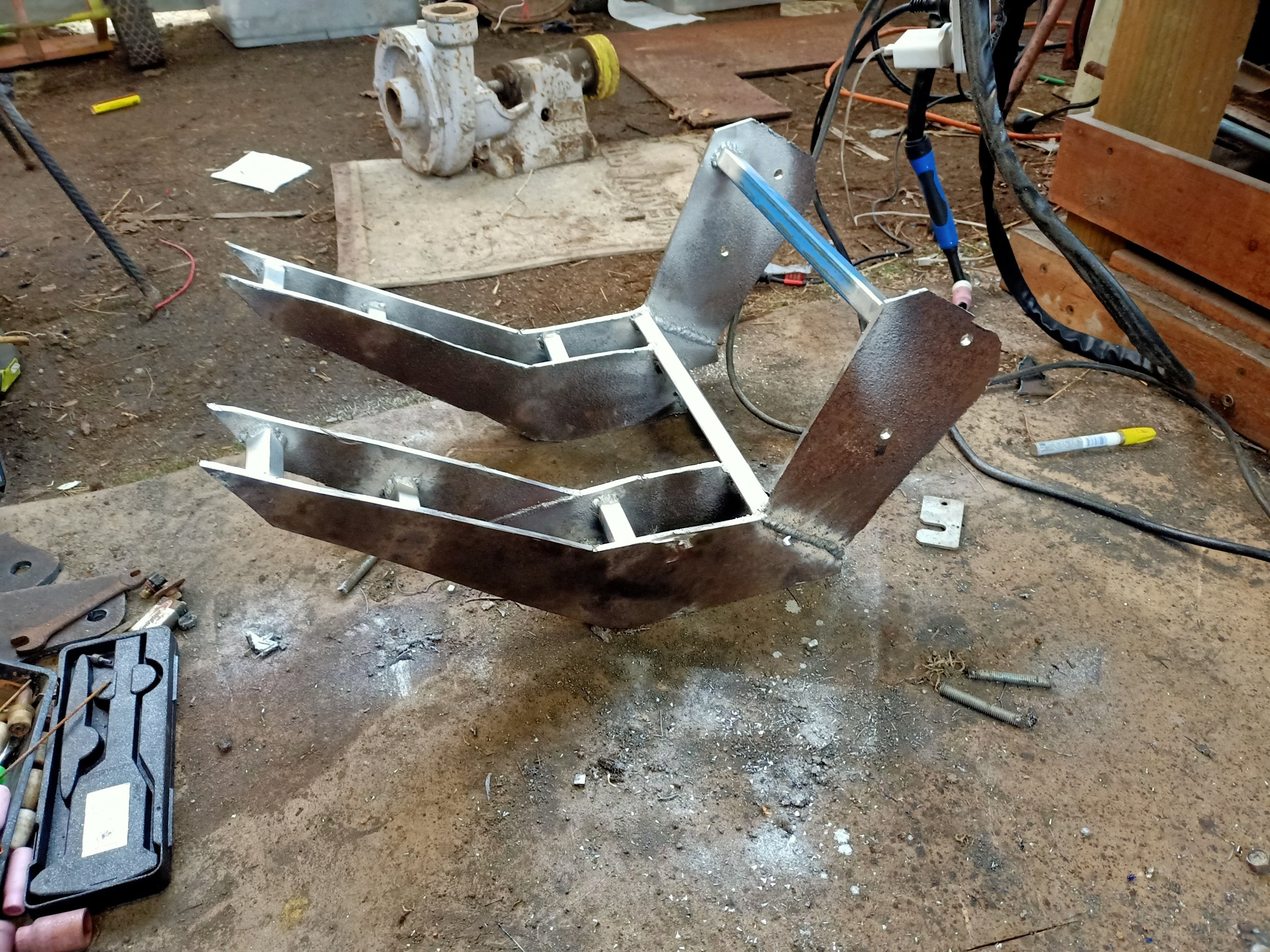

Hi all I know I've been trying to find more info on small logging cut off saws myself with not much luck so decided yesterday to start building my own, the saw unit attaches over the thumb, I'm using a hyd drive pole IMG20220628171505.jpgIMG20220628165034.jpg saw I got on market place for $300 and will use a small ram and sequence valve so saw will not drop until up to full speed. As I only started this yesterday, still have to plate out the rest of it and start fabricating mounts and guards etc. Hopefully have more pics for you in the next few days as I progress. I'm fitting to my 1.5 ton excavator but no reason similar style couldn't be adapted to Fel with forks and crowd arm or a 4 in one bucket.
Cheers
