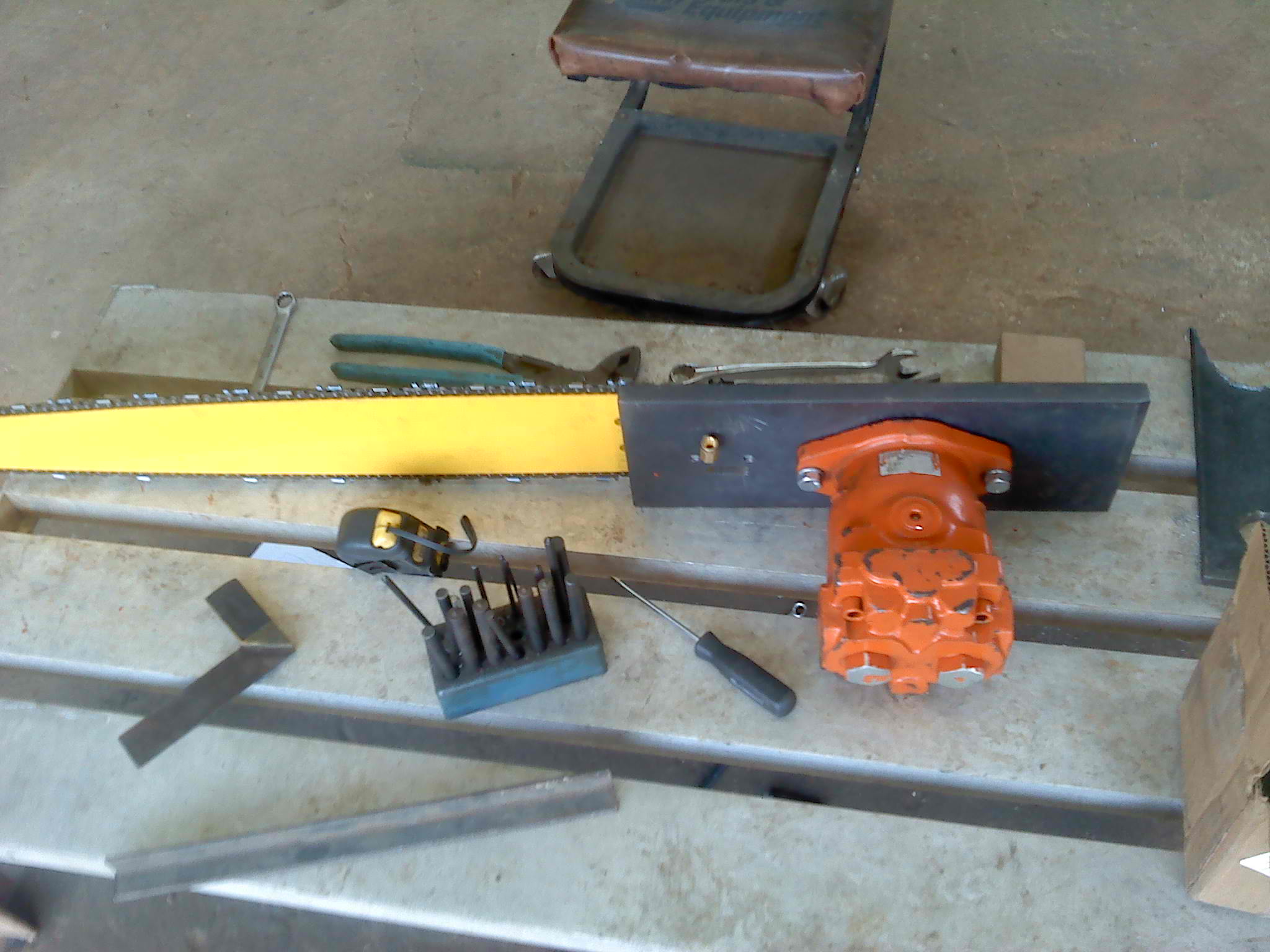

I'm working on building a firewood processor. I'd like to go with a hydraulic saw but, buying one puts this project well over budget. I'm considering building one. Has anyone built one from a regular hydraulic motor which I have several of laying around? Will a chainsaw work sufficiently with a low rpm and high toque compared to a gas saw? Also I have an old Stanley hydraulic saw. It has like a 10" bar which is unsuitable. If I changed bars to a 20" 3/8 chain what kind of power could be expected? My hopes for this saw working at a suitable speed is slim since it's running such a short bar with chain that's narrower than 1/4 chain.

I suspect the main problem will be RPM's.
Gas powered saws rely on high RPMs for efficiency but Hydraulic motors rarely spin all that fast.
Hydro application is sporadic, like a limb here and there but no production.
On the other hand if it works for hydro it should work for you.
I might just all be a matter of proper chain for the job, I suspect that slow = lots of torque so a larger chain (than gas driven) could be the answer.

The saw in the pic is one I built for my processor build. This motor is a 1.3cuin axlepiston type. The bar is 24in with a .404 full comp, full chisel chain. This saw is also untested as I developed health problems and have yet to finish my processor build.
First off, I would forget trying to figure rpms as a measure of cutting speed. Chain speed is figured in feet per minute or sometimes feet per second. chains speed can be varied by drive sprocket selection. A larger sprocket will produce faster chain speed. The trick is to produce enough torque to pull the chain at the desired speed. When building my saw, I choose a husky 3120 gas powered saw to try and match. Numbers arent in front of me, but I took the hp, torque, and chains speed to try and come up with a hyd motor combination that would match the 3120 chainsaw. Here is a link to help. Chainsaw Comparisons and Facts from Procut Portable Chainsaw Mills.
A lot of people have used this motor, .7 cu in PARKER MGG2:(-BA1A3 HYD MOTOR to build their saws. Some have tried the .58cuin motor and not been satisfied with the results. I cant say whether the complains are from poor motor selection or poor hyd design. I will say that even the .70 motor in the link will never be able to match a 3120 chainsaw when it comes to torque. Even tho those little motors are rated for 5000 rpms, you cant put the pressure to them to get the torque numbers you need.
Gear motors are usually limited as to rpm speed, even if you can throw more pressure at them to get the torque needed. You can compensate some on the speed by using a larger sprocket, but then you sacrafice torque losses. I chose the axial piston motor because it will produce more torque and higher rpms than a standard gear motor. This particular motor is a Poclain model M1. It is 1.3 cuin and can produce 4641ftlbs of torque. It does take a lot more oil flow and pressure, which means bigger hyd pumps and engine hp, but it all depends on how badass a saw you want to build. A 3120 chainsaw has 8.9hp, the axial piston motor will put out 25hp at 2000psi.
True, but the bar you are using puts a limit on how big your sprocket can be. You can't have a bar that is, say, 3" across and a 10" sprocket behind it.
So you are back to needing high RPMs for your motor, OR, some kind of gearing mechanism to increase the speed. For reference most chainsaws spin above 10,000 RPM, some in the 13,000 range.

I dont think you are going to find a 10in chainsaw sprocket, but you can find larger saw bars. They are called harvester bars. Since the chain speed is a factor of rpms, rim size and chain pitch, the size bar does have to match the sprocket size. I am using a 13pin rim on my saw and a .404 pitch chain. I dont have the number in front of me but the chain speed is within about 50ftper min of the 3120 chainsaw I tried to imitate. There is a big difference in hp and torque as my saw has about 3 times the hp and 4 or 5 times the torque of the 3120 gas saw. If I thought I needed more chain speed, I could swap the 13pin rim for a 14,15,16 etc. pin rim. Doing so I would also have to swap my little harvester bar for a large harvester bar to keep the chain running in the bar guide rails.
I also pick up butt cuts and ugley wood from logging sites. The loggers use what I call buck saws. These saws use much larger, BC size chains and the knuckle boom hyd's to operate. if you open up the covers on these saws, you will see a large hyd motor with a large belt pulley driving a jackshaft with small pulley that pulls the saw chain. they get the chain speed thru gearing. The large hyd capacity of the knuckle boom loader allows the use of a very large hyd motor and lots of hyd pressure too pull those big pitch saw chains. You also have the Harvester saws you see on knuckle booms that run the f11, f12 bent axis hyd motors. These hyd motors turn very high rpms and operate off pressures up to 5000psi. For a firewood processor, pumping 5000psi off a 17hp engine, with enough flow to run one of those $1800 f11 motors isnt going to happen.
Compareing a 10,000, 12000 rpm chain saw to a 3000rpm hyd motor isnt compareing apple to apples. First off, a chainsaw runs a .325,3/8 size pitch chain. The big sthill 880 or husky 3120 can run 3/8 or .404 pitch chains. Now while it is common for a small saw to turn up to 12500 rpms, the large saws only turn aroud 8000 rpms. The older saws only turned 7000 rpms. when you compare the rim size on those different saws, you can see a hugh difference in dia. While a normal off the shlelf saw will usually have 7 teeth.pins, you can buy 6 pin or 8 pin for most size saws. Going from a 7 pin sprocket to a 14 pin sprocket will double the speed of the chain, thats simple gearing. Now if you have a saw that turns 10,000 rpms and a hyd motor that only turns 5000 rpms, just changeing the sprocket will allow you to get the same chain speed. Going from a 3/8 pitch chain to a .404 pitch chains wit appropriate sprocket will also increase chain speed. Of course using a more aggressive cutting .404 chain will take more power than pulling a 3/8 chain. Where I think, and its just my opinion, where people go wrong trying to build a hydraulic chains saw, is that they dont understand the relationship between rpms and actual chain speed. When you compare a gas powered chain saw to a hyd driven saw, the first thing they look at is the gas saw runs at 12000 rpms and they think they need to get a hyd motor that will turn the same speed. Its just not true. You do need to match chains speed but you also have to factor in torque. If the 5.5 hp husky 372 cutting speed suits the OP's performacne goals, then that is the numbers he needs to use to build his saw. He can look at the rpms, hp and torque rateing of the 372 and do the math to find the size hyd motor , hyd pumps, sprocket size and hp requirement to match the 372 numbers.

With nothing better to do, I decided to do a little math experimenting on what it would take to build a hyd saw with similar power and speed as the 372xp the OP says he wants to performance match. I am doing the math as I type, so it it looks jumbled, just overlook .
First I had to look up the saw spec. Fist thing was hp, the 372 specs are in Kw instead of hp, and a lot of other things where metric so it meant a lot of converions, so because of rounding my numbers wont be exact. The 372 is rated for 4.1kw/5.5hp.@10200rpms. Torque is 3.8Nm/2.8ftlbs. Chain is 3/8 pitch and runs at 22.7m/s or 74.5fts.
Next I had to find a motor that would come close to meeting those spec. Ironicly the motor I posted in my fist reply came pretty close to fitting the requirement..
.7 cu in PARKER MGG23-BA1A3 HYD MOTOR.
knowing I had to use a larger sprocket to get the proper chains speed, and the sprocket size had to be something easily found and compatable with a standard saw bar., I picked the 14 pin sprocket which is double the size of the standard 7pin sprocket on the 372. this meant I would have to find a motor that would turn 5000rpms if I was going to stay even close to the saw chain speed. The .7 gerotor motor will turn. 5000rpms. I then compared the torque numbers of the motor. Of course it was in inlbs and not ft lbs, 166in lbs is 13.8ftlbs. One has to factor the torque numbers are rated at the shaft and I am not sure how to convert the actual torque numbers with doubleing sprocket size but I am guessing the number would be at least cut in half. Lets just call it 6.9ftlb torque, at 5000rpms.
Next I needed to figure the amount of oil to reach 5000rpms and the pressure required to produce the torque. On the website the motor is listed as 5000@rpms with 15gpm @ 1500psi. Online calculators suggest that it takes 14.6hp to produce the oil flow and pressure needed to run the motor at max power. A little more calculations suggest that a .7cuin motor at 5000rpms and 13.8lbs torq would produce 13.1hp. All these numbers are a lot more than the 372 gas saw. so it looks good so far.
Chain speed is the next thing to consider. "
Take the chain pitch and multiply by 2. Multiply the above number by the number of teeth of the saw sprocket.
Multiply that number by the saw R.P.M.
The final answer will be the chain speed in inches per minute, just divide by 12 to convert to feet per minute."
So ,(3/8x2x14x5000rpm)/12= 4375ftpermin. to convert to fts divde by 60sec=72.9fts. Pretty darn close to the 372 @ 74.47fts.
The one thing to consider is that even tho this hyd saw has a little less chain speed than the gas powered 372, the extra torque and hp should make for a comparable cut speed. Also consider that all hyd math was being done with advertised numbers, nothing has been factored into actual efficiency numbers, typical at 80%. efficiency. So while the numbers may be close, actual performance might not measure up. My saw motor is almost twice as big and will handle 3 times the hyd pressure and used a larger pitch chain. I am also using a 7.3 diesel engine to pull all the pumps. If you want big and fast, you have to go up in power, but the .7cuin motor along with his 17hp engine is pretty close to matching his 372 saw performance, which is what he is looking for. He wont have any oil flow left over for other processor functions and his operation will more than likely be a one function at a time processor,

I built one and I used a Stanley Hyd saw on mine. I replaced the 10 inch bar with a 24 inch 3/8 chain. It cuts very good when hooked up to my skid steer which has a 12 or 14 GPM pump.This year I bought a 2 stage 16 gpm pump and hooked it to an 18 horse motor It does the job just fine. I think is is a little slower than using the chain saw but that is off set by how easy it is to use and wear and tear on my body. I have not played with sprocket size yet but will when the weather warms up. Hooked up to my skid steer the way I started out I could cut about a plup cord an hour using my dump trailer and elevator. One suggestion is make the whole unit simple and do not over think it. I have a problem over thinking everything, but being a machinest for 26 years helped me a lot

I'll probably experiment with the Stanley just to see what happens. If that doesn't work I may experiment with building one, with a motor laying around. How does the bar oil on hydraulic saws? I remembered today that a buddy has a Husky pro saw that a tree fell on. It's unsuitable for hand held use because the case is busted, but I believe it still runs. If he'll sell it cheap that's a likely candidate. I also thought about powering the saw with a Honda GX motor off a pressure washer I bought at an auction with a frozen pump. I think it's 5 or 5.5 hp so in theory it should provide similar power as my 372 XP.
/ Has anyone built a hydraulic chainsaw? #15
The oiler on the stanley saw is built in It uses hyd fluid to oil the chain. It works ok but not as good as the bar and chain oiler. I can get you the motor numbers that you need for a saw motor if you want. These can be purchased from the surplus center. You are going to find that your 5 hp motor won't be big enough. I tried an 8 hp and it would just barely run the saw
