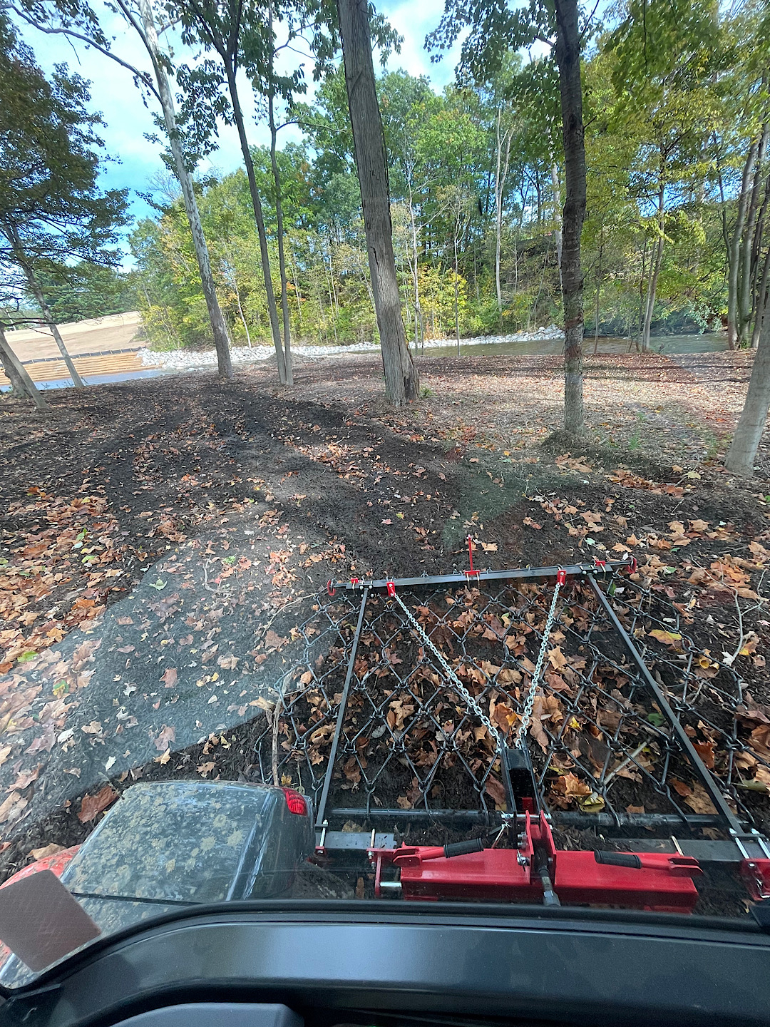

I use this one for parking lot and driveway maintenance. It’s very well built and they should offer a size for your intended use.
Wingfield American Harrow - American Steel. American Labor. American Quality.
View attachment 724697View attachment 724698

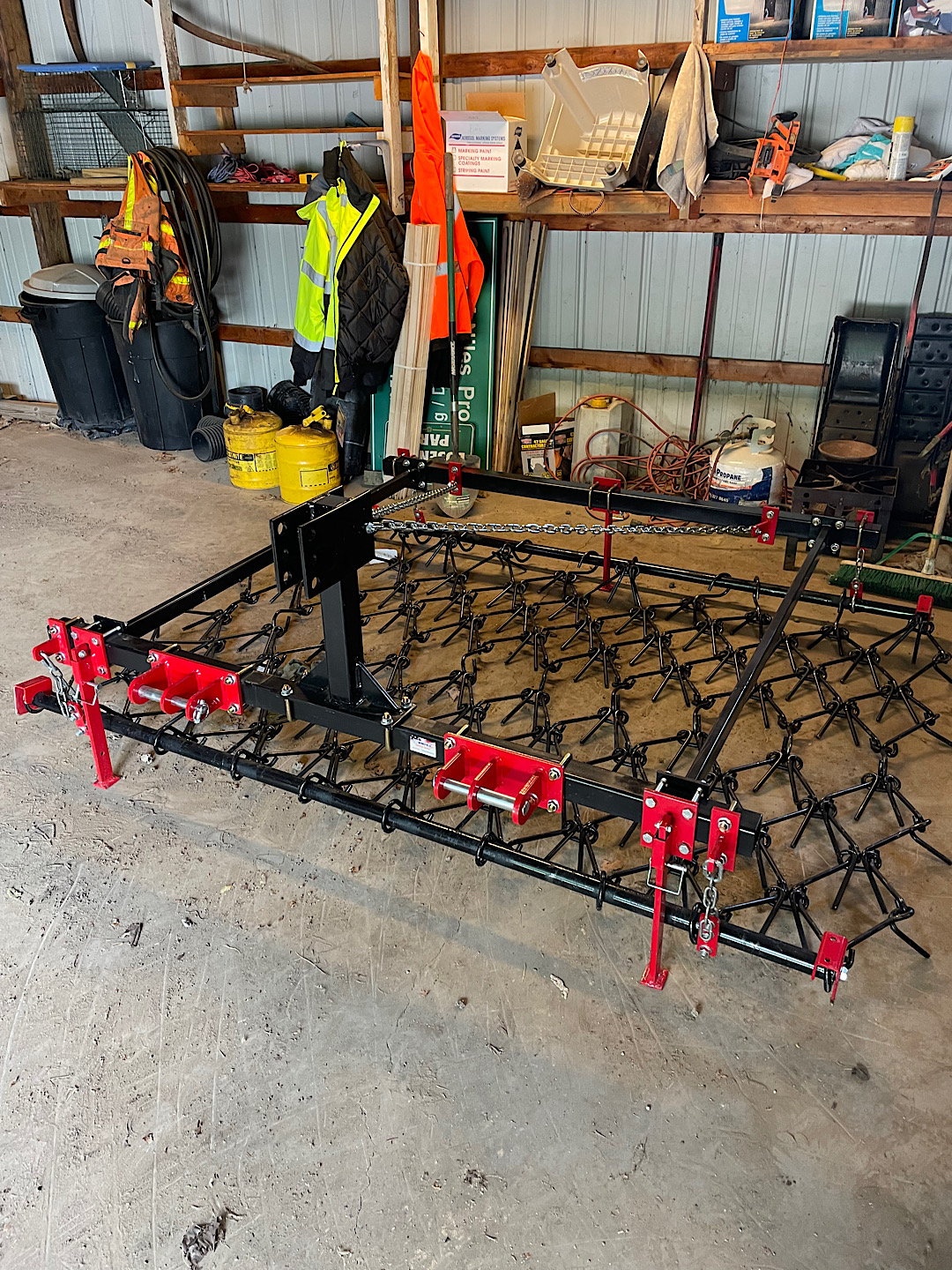

I also use a Wingield framed/lift Chain Harrow. Framed/lift Chain Harrows mount on a tractor's Three Point Hitch.
With 8 - 10 acres in pasture an investment in a tractor-mounted Chain Harrow probably makes good sense.
WINGFIELD: Wingfield ED3PT57 (TPH/Framed/Lift) --- CHAIN HARROW ---

I used to pull my harrow with the RTV900. It worked fine as long as you could keep moving forward. You aren't going to want to wrestle with it all the time as they are heavy. The biggest issue I had was that I couldn't lift it to get into spots and pull forward. I ended up mounting it to a frame (like the one shown above) and can now pull it with the tractor 3 point. It also makes clearing debris faster if you can pick it up. The RTV's trans temps would rise from me pulling it in the most aggressive position over time so I always kept an eye on it.
