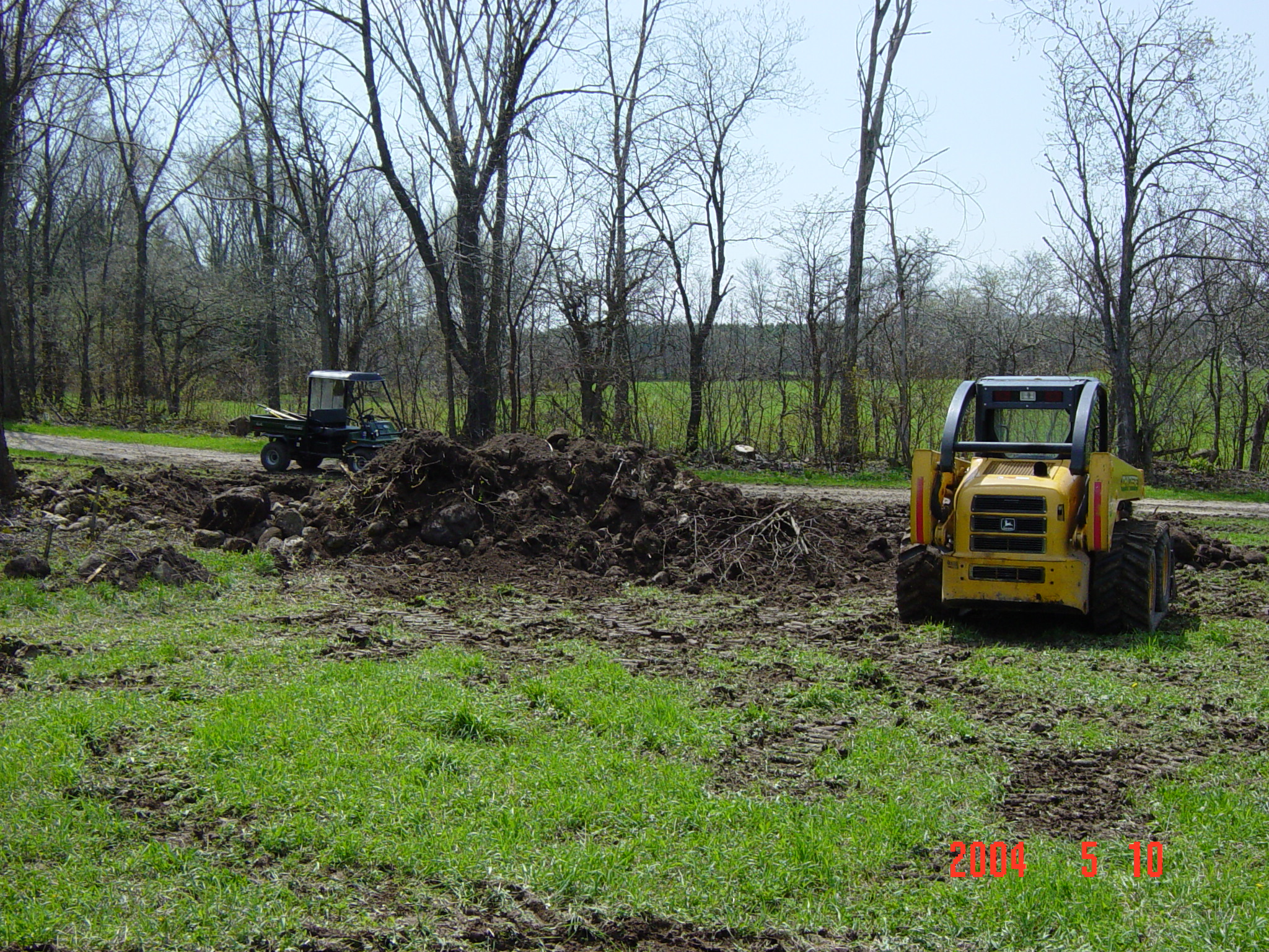

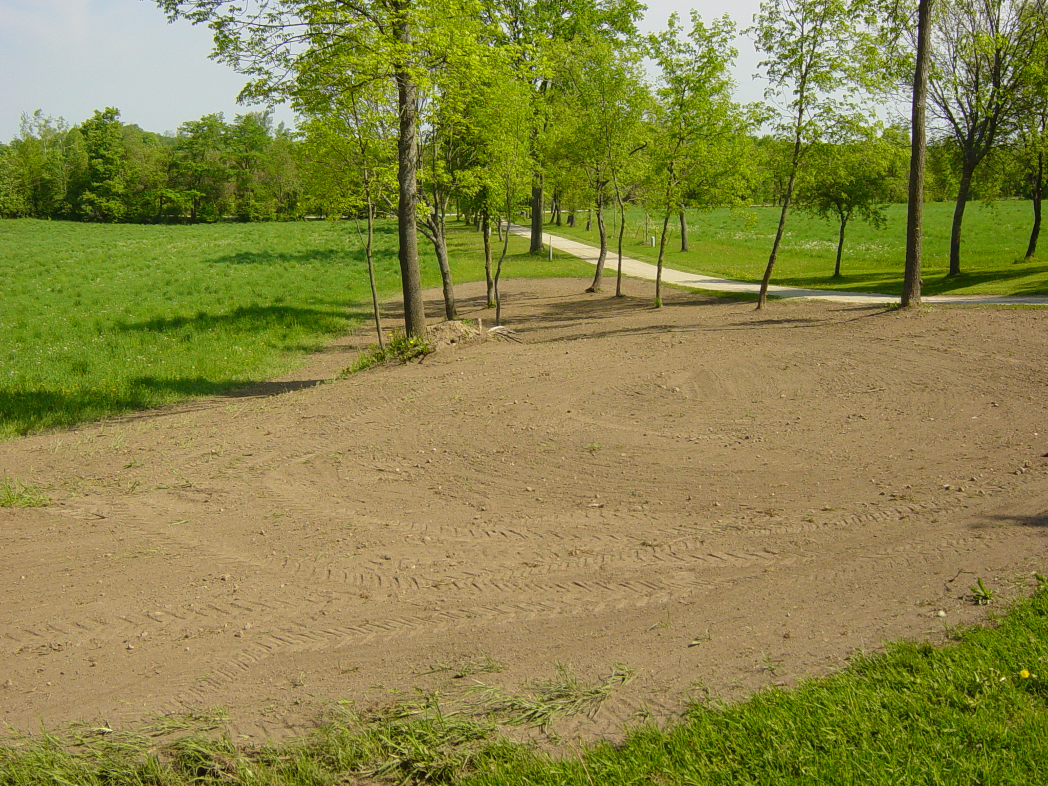

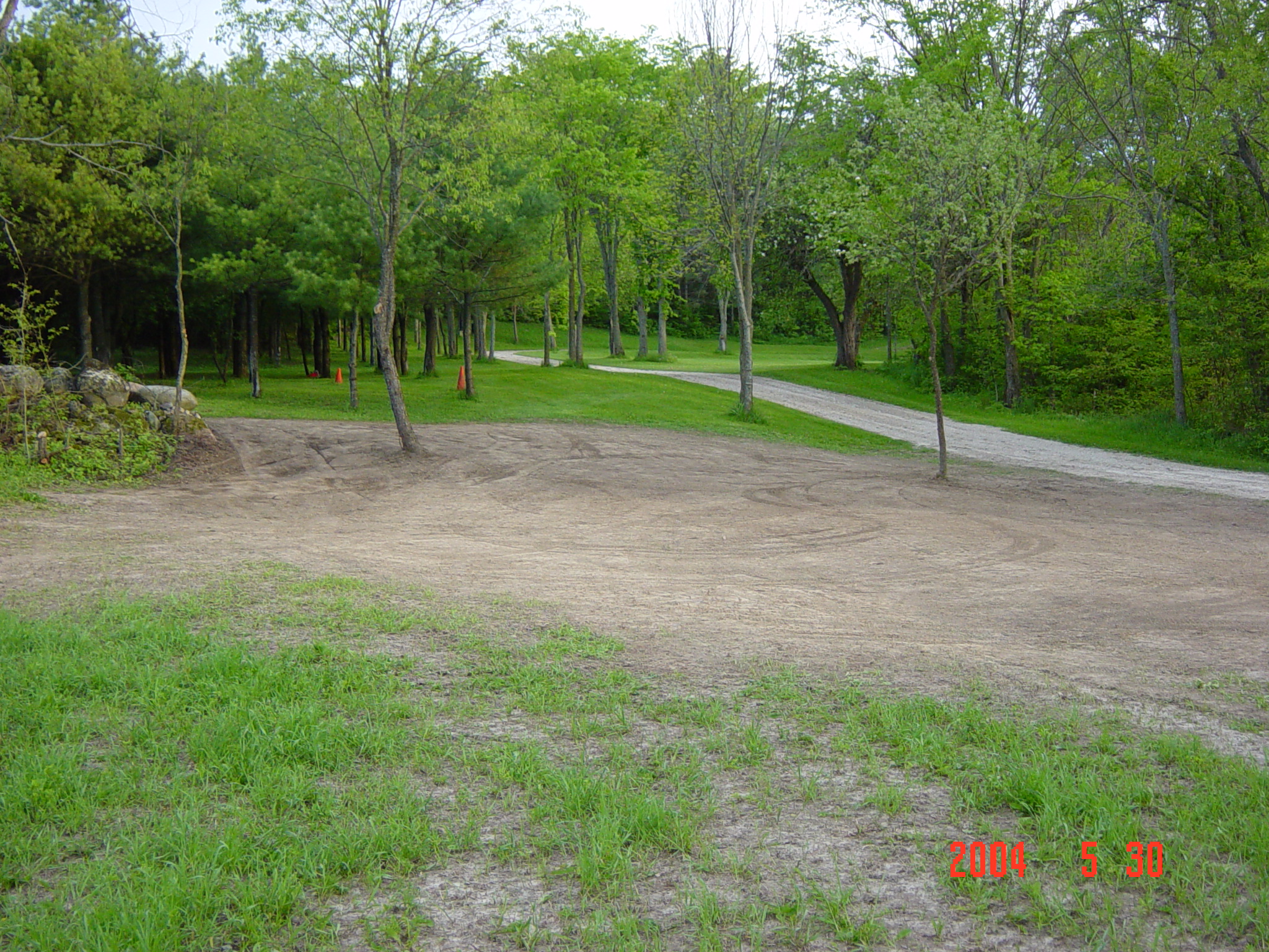

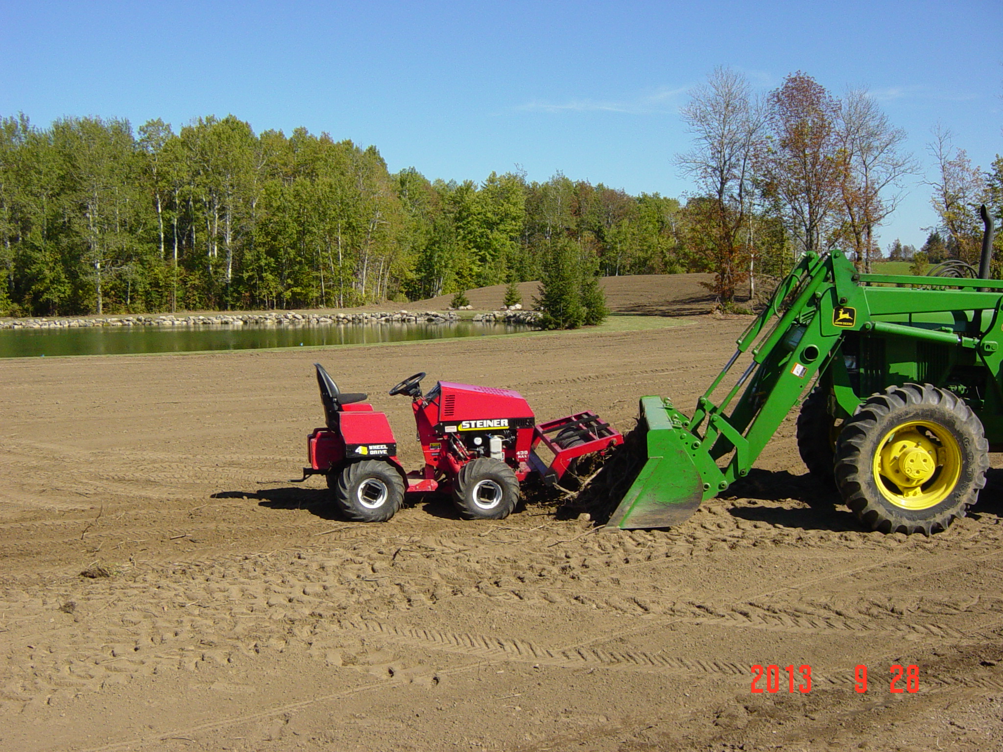

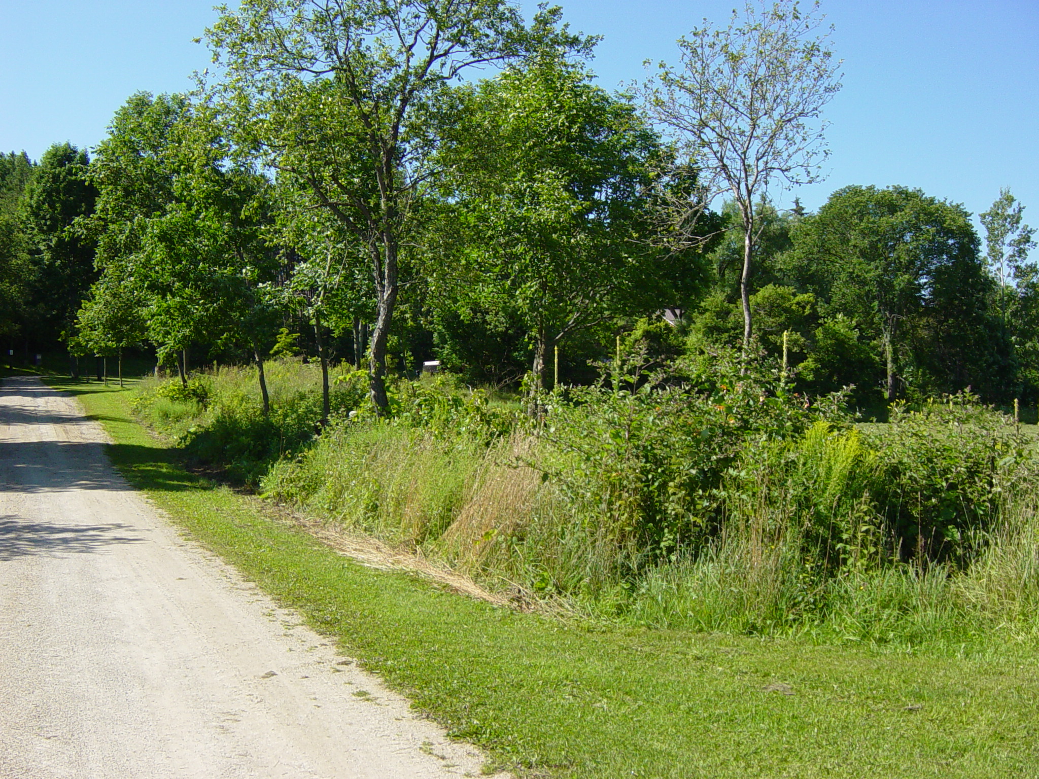

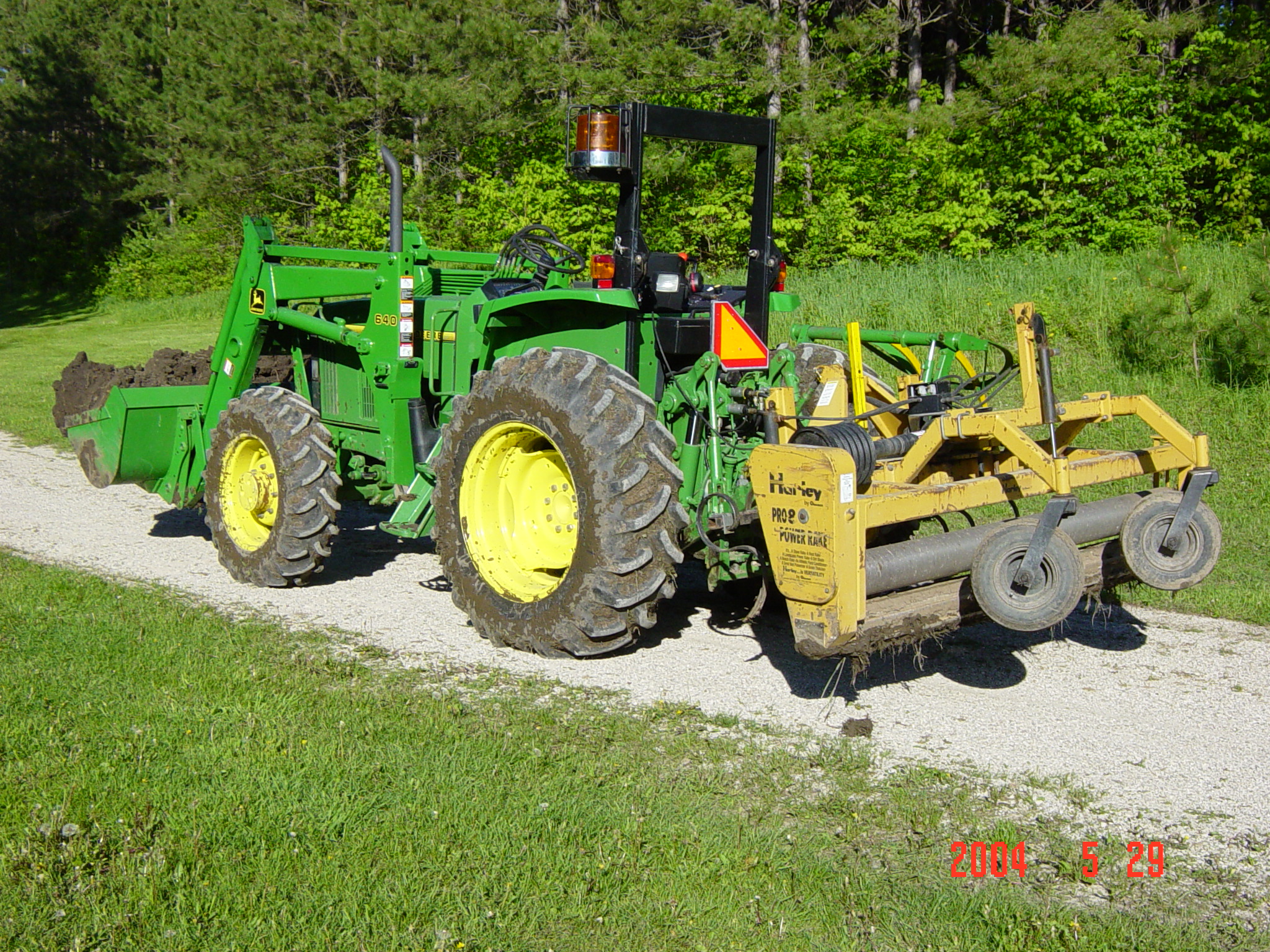

I have a Harley Pro 8 power rake. Great machine. First pass is always the most impressive. Then you can do a lot of driving for little more gain. BIG trouble on large areas is where the windrowed garbage goes. You need a way to collect it.
This is how I collected material. Not my place but a job I did, that I thought at times I would never get done!
Or a typical before and after at my place. Removing part of a fence row.
AND maybe the last project. The worst overgrown, rock infested area I had. I did bring in heavy equipment, but the Harley makes it picture perfect!
