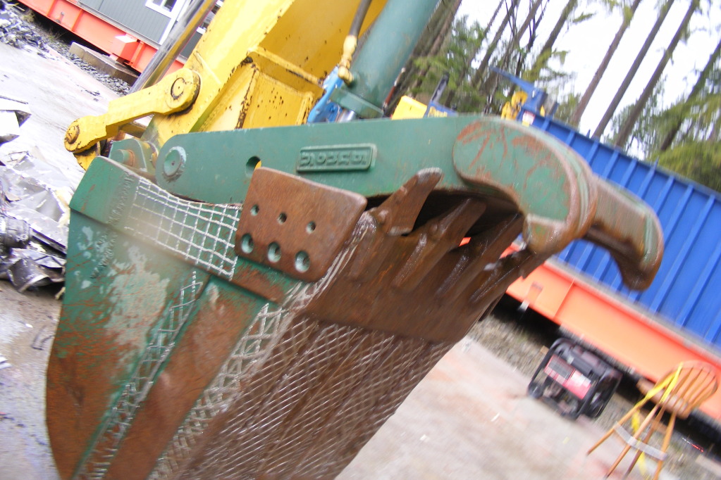

I was taught though, that the dirt that packs in between the rows of hardfacing is as important to the abrasion resistance, as the hardfacing itself.
That is what I was always told too. I always left it up to the equipment operator to tell me what pattern he felt was best.

/ Hardfacing question #16
Look on Stoody's site if you want to see pics and applications for hardfacing. Usually the smaller diameter wires require a shielding gas but the larger ones don't have to have it. I would guess that the smaller wires with shielding gas have a lot less smoke. I can't remember if .045 is the transition or if it's 1/16". For something like a skid shoe, you'd want beads running lengthwise. The problem with a 6' wear strip is warping. That's why I think a herringbone (V) pattern with the point of the V at the front would be a good compromise. You could stagger your welding and not get anything too hot. I think if the beads were about 5/8" apart would work nicely. I'm sure Stoody or another brand of hardfacing could give you a recommendation. AR400 is abrasion resistant but not as much as hardfacing can be. Anthor option is see if you have a UTP distributor near you. They make or used to make abradiscs(sp). They are oval shaped wear plates with the middle cut out to weld them on and they come with the welding rods. You'd need a stick welder though unless they could specify what MIG wire to use.
#17
Herringbone it will be. I ask you folks because you know what you are doing. I would be foolish to not follow your direction.
Thank you
