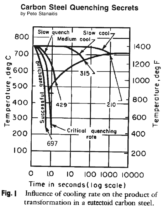

Not quite an exact scientific approach, but I've modified stuff at work by heating it up with a torch and dropping it in cold water. You can use oil too. I like water. Any how the process forces the steel to trap the carbon and other stuff in the steel between the molecules to make it harder. I don't know how well this works on all types of steel but I've been doin' it for years. I know they do this to make swords too. Picture below comes from
Metalsmith V 21.3 Quenching Steel by Pete Stanaitis

I thought tempering steel required you to lower the tempture at a slow rate. If you just drop the hot steel into water and "DROP" the tempture you would have weaked the steel as apposed to harded it. I've read thats why they use a type of oil. It does'nt drop the temp and some of the oil is trapped in the pores and for a short time fights off oxidation.
Yes Tempering is cooling it slowly making it less brittle. Heat-treating is quenching it aka droping in water like Matt posted. If I am wrong correct me??

I think it depends on if it's a high carbon steel or not and what the other ingredients in the steel are. This science is called metalurgy and I will admit I know just enough to confuse me more:D:D. I know carbon steels and low alloy steels are quenched in water and high alloys are queched in oil or in an air oven slowly. Some are quenched in lead baths and salts too. Like I said, I know just enough to be confused. The stuff I harden are tools. I have over $100,000 in tools. Snap-on, Craftsman, Matco, Mac, Proto, you name it. I will probably never have enough. Anyhow sometimes I have to modify one to make it work 'cause what I need isn't available. Say I need to bend a wrench. I learned early on if I just put it in a vise and bend it it'll break. If I heat it up and bend it it'll be bent the way I want but break if I put some pressure on it before it does what I need it to do. If I drop it in a bucket of cold water while it's still hot it can handle what I need it to do and I can keep it to use again. I know they often use the color that the steel changes to as a guage on how hot it gets so that the tempering can be done at the correct temperatures. Both my grandfathers worked at steel mills in PA. One was a chemist. That doesn't make me an expert though. I just remembered a little. Wish they were still alive. I still had a lot to learn from them.
/ Hardened cutting blade #13
Oh yeah, tempering steel makes it harder. If it's too hard it becomes brittle. Another thing that makes them harder is whats in the steel. For instance, chromium, nickel, carbon, copper, manganese, blah, blah all in how much of each, one or the other and so forth makes the steel harder without becoming brittle. Tempering of steel is a very complex process that I don't know much of anything about. Just what I've done.....backyard crap. If I wanted a hardened cutting edge I'd be reaching for my wallet. Sorry for saying a lot of nothing:rolleyes:.

I will share what my knowledge is...
ONly metal that has a high carbon content can be hardened by a simple quench. If you take a peice of rebar for instance and heat it and quench it, it wont do much (unless that rebar happened to have some carbon in it)
"back in the day" thay would wrap hot steel in horsehooves and bury it for a few hours to "case harden" it that is get the carbon from the hooves into the steel. THey still do this but I think it more sophisticated these days.
MOst tools are high carbon steel so MAtts observations are correct.
If you take a peice of very high carbon steel and heat it to red hot and then imediatly quench it in cold water it can become so hard that it will literally break if you drop it (sometimes it will crack just quenching it)
Since this is obvously not a desirable trait you can change it by "tempering" the steel. This is done by heating the metal again and "Drawing colors" If you have ever noticed how heated metal can turn blue, you have seen a color change. MOst tools like a "Deep straw" color as a happy medium. That is you heat the tool untill it is "deep straw" and then quench it. MOst tool companies have ovens that heat the steel to their desired temperature for a specific color and then quench. THe quench can be animal fat or salt water or used motor oil. pure water is the fastest quench, but sometimes it is desirable to have a slower quench to give the metal "toughness"
If you heated a peice of steel to red hot and let it cool off on it's own that softens its or "anneals" it and makes it flexible, somtimes too flexible as Matt has noted.
If you look closely at an axe head you will see it has a peice of hard steel at the edge to hold an edge, welded to a softer steel for toughness.
Back to the point of this thread, if you dont have a big forge I dont see how you would harden a cutting edge, and if the steel wasnt high carbon in the first place it wouldn't do much good.
old Grader blades are good bets, but with the cost of scrap steel rising, dont expect any freebies.
