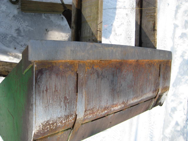

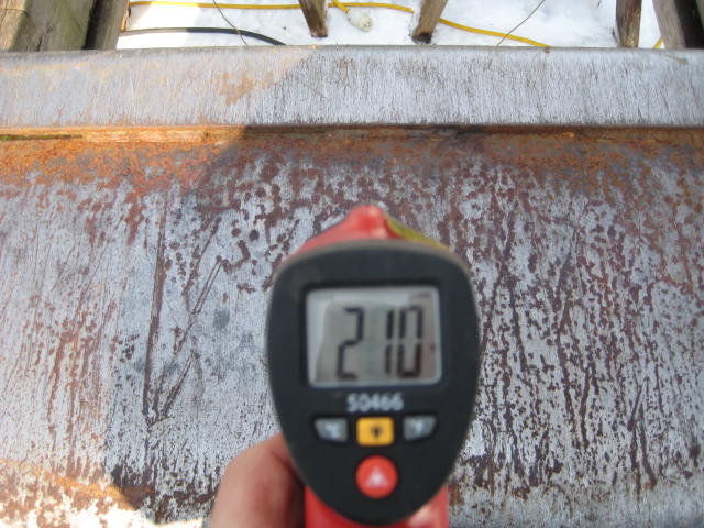

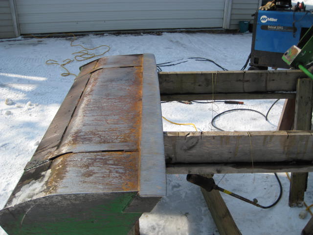

The welding

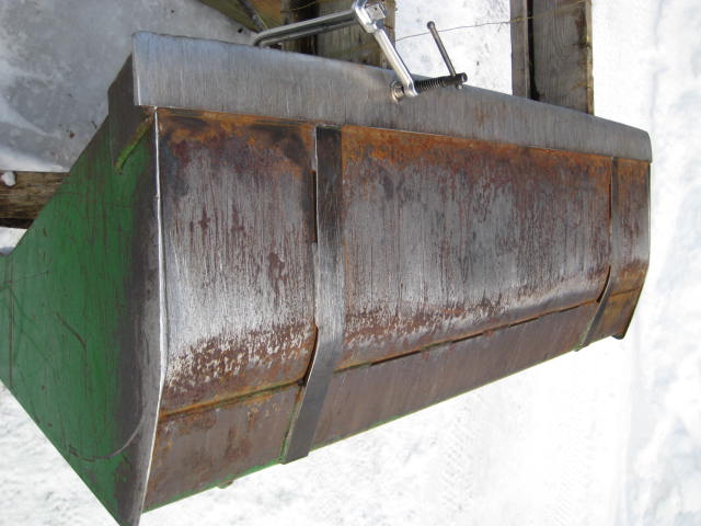

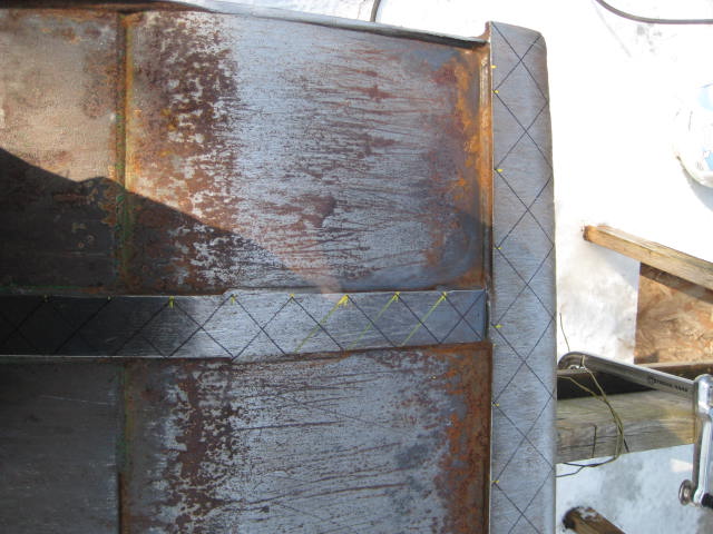

The end result, and cool down.

Nice pictures. It was a good day for outside work today. Uncovered my black top - just in time for more snow.
I would face the areas between the wear strips too. That's where the bucket will hole thru first.

I really enjoy welding, but if I had to do it again, I would use Highbeams advise and use 7018. I think the 7018 would be easier to use and less money. Not saying the stoody is a bad choice I just needed more practice. I did have a hard time adjusting to the hard face rod.

Hook, Good lookin' job! I did the same thing to my FEL bucket last year. Used the same hard-surface rod as you...
Did my work inside, though. Didn't preheat the bucket.
John_bud is on the dollar, too. The area of the bucket just before it rolls back is a place of significant wear. Notice how shiny it is?
I added a couple of additional wear sections of 3/8" flat bar (maybe 3"x4") welded to the area between the full length wear sections and hard-surfaced those, too.

Hard face rod is not the easiest stuff to weld with. At least it was warm with the fire!
